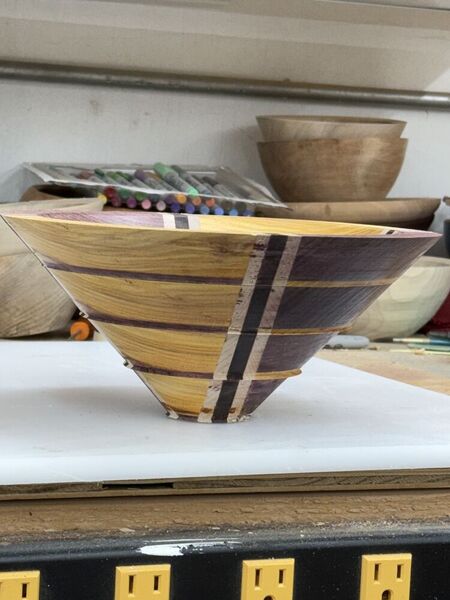

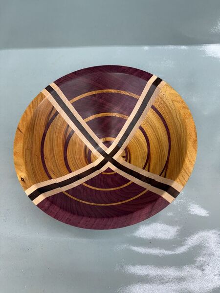

June 21Jun 21 Popular Post comment_377912 New bowl. Getting ready to glue it together. Wanted to stack it to get an idea what it will look like. Around 9.5” in diameter. Purple Heart, Canary wood, maple and katalox. Report

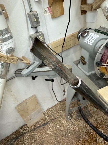

June 21Jun 21 comment_377913 Neat design! Are you cutting these with a bowl from a board jig or a scroll saw? Report
June 21Jun 21 comment_377917 1 hour ago, RustyFN said:Thanks, yes I am cutting them as bowl from a board.Nice. Are you using the lathe and a parting tool? Report

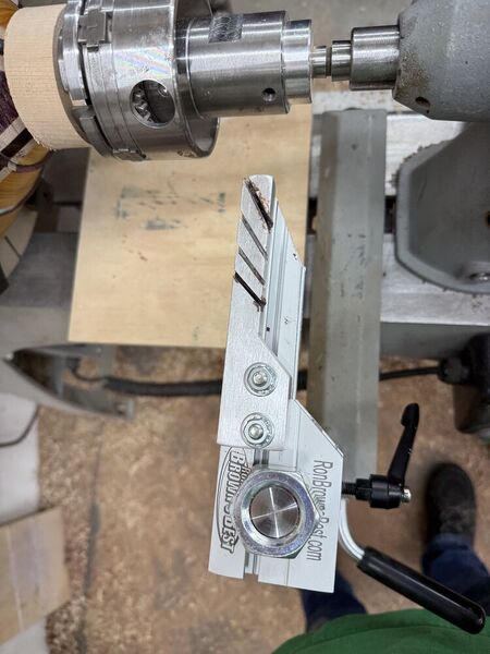

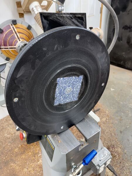

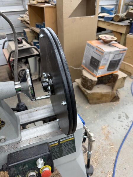

June 21Jun 21 Author comment_377921 1 hour ago, HandyDan said:Nice. Are you using the lathe and a parting tool?Yes. I bought the kit from Ron Brown. It comes with a nice thick plastic plate with a faceplate attached. It has a 4” square hole in the front to glue a square block on your blank to drive it. I didn’t like that so I cut a piece of corian to fit and put a finish nail through the center to hold a piece of 1/4” plywood. The plywood keeps me from cutting into the black disc. You also get a tool rest with 45, 50, 55 and 60 degree slots to guide the parting tool. The parting tool is 1/16” with a small 3/32” piece attached to the top. The pot piece has a small flute in it and the whole thing is only 1/2” tall. Report

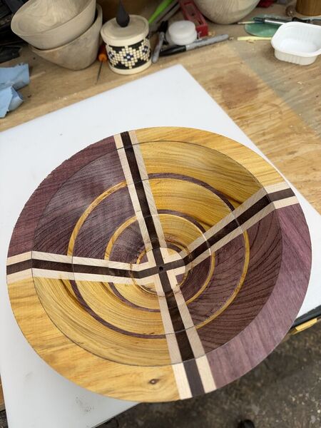

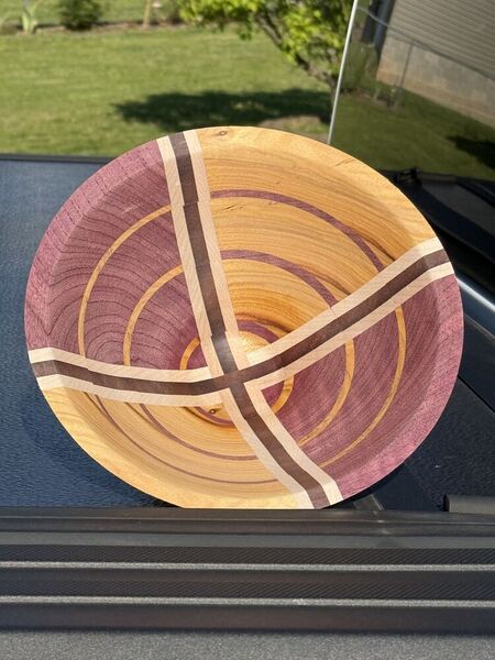

June 25Jun 25 Author Popular Post comment_378048 Setting on the back of the truck in the sun trying to get some purple. Report
June 27Jun 27 Author comment_378172 11 hours ago, DuckSoup said:That is awesome Rusty, love the colors.Thanks. I love the look of purple and canary wood together. Report
