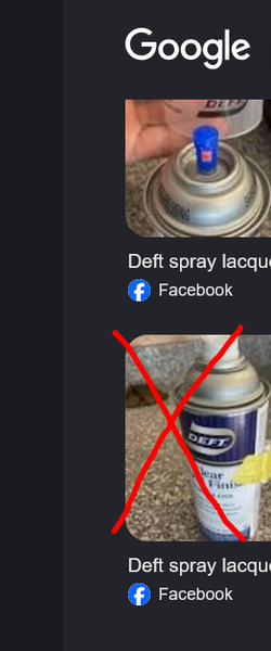

I would wait at least 45 minutes even tho it will be dry to touch in about 10. Like Gordon I have had best results with Watco brand , but Jimmy Clewes says it is in the nozzle. Best nozzle looks like a two piece with tube in the center.pics-of-spray-nozzle-on-lacquer-cans-Google-Search.pngYou will want the top one (blue). Remember just light sanding with 350 to 400
