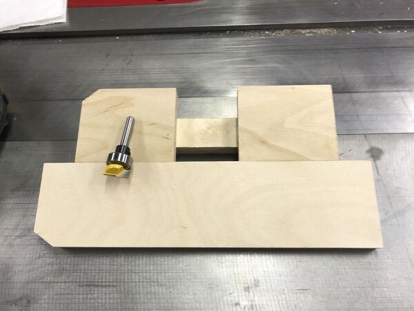

April 12Apr 12 Popular Post comment_374528 Artie, for butt hinges, I make a small jig tailored to the hinge length and us a trim router.Danl Edited April 12Apr 12 by Danl Report

April 13Apr 13 comment_374594 On 4/12/2026 at 7:12 AM, Danl said:Artie, for butt hinges, I make a small jig tailored to the hinge length and us a trim router.DanlExactly what I do too, right down to the pattern of bit. Report
