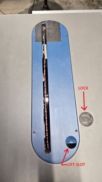

This is the original insert.

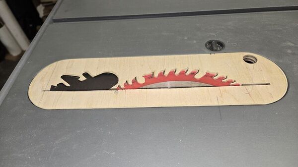

This is the zero clearance insert I made out of 1/2" plywood.

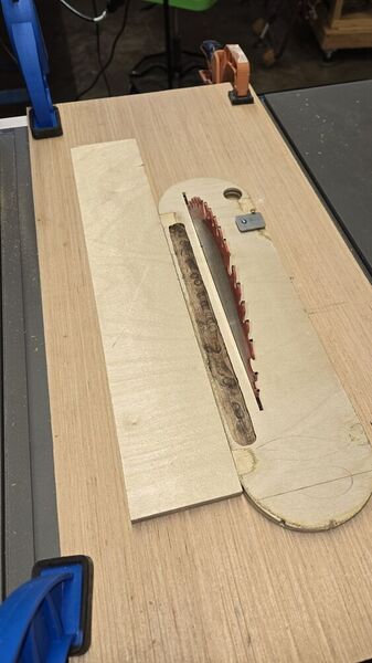

In order to make the first cut through the new insert I had to remove the 10" blade and replace it with a 7 1/2" skill saw blade. I also had to alter the bottom of the riving knife so I could remove it as well. Making the original cut with the smaller blade allowed me to put the 10" blade back in, crank it all the way down then put the new insert in and raise the blade as high as it would go to increase the length of the slot. The slot still wasn't long enough to accommodate the riving knife so I came up with the idea of marking a line on how far I needed to increase the slot, clamped a sacrificial piece of thin plywood to the table top, slid the new insert over the fully extended saw blade and then using double sided tape I placed a guide board next to the new insert so I could increase the slat length insuring it would cut a straight line.
In the last picture an area of the saw frame was higher than the support feet for the insert. In order to transfer the length/width/location where I need to rout out the new insert I put a thin layer of tooth paste on top
of the metal then slid the new insert into the opening until it came in contact with the tooth paste. Drew a pencil line around around the tooth paste mark on the new insert and this gave me a guide for where I needed
to route out the wood using my Dremel tool.
Nicely (and safely) done Bubba. Great improvement to the OEM.
Where there is a will there is a way and you definitely have both great solution on to a problem, congrats.
