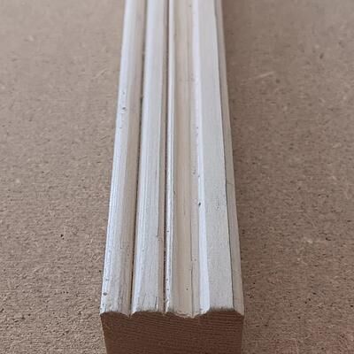

So I decided to make a frame. Pine was okay for this. I'm going to paint it afterwards but I wanted to make my own profile.
After sketching up the profile I liked and getting the SWMBO to sign off on it, I began to create the profile.
I started with the first edge bead.
I scratch stocked back and forth with various cutter blades and finally finished it to match my sketch.
Here's the result:

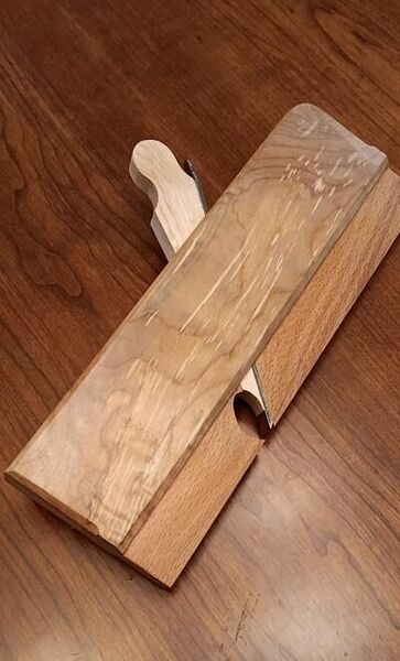

On one side as shown, you will see a little notch. This will be opened up with a rabbet plane that I my made to firm the step for the matte and glass.

Nice work Rick. That's quite a "vintage" plane you're using.
Thanks @Grandpadave52 It's a Lee Valley Scratch Stock and then I will use this (below) for the rabbeted notch.

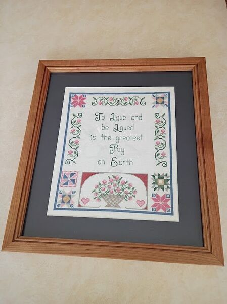

One I made a couple of weeks ago for a grandson getting married this year. The needlework was done by my mother, who passed away about 3 years before he was born.
