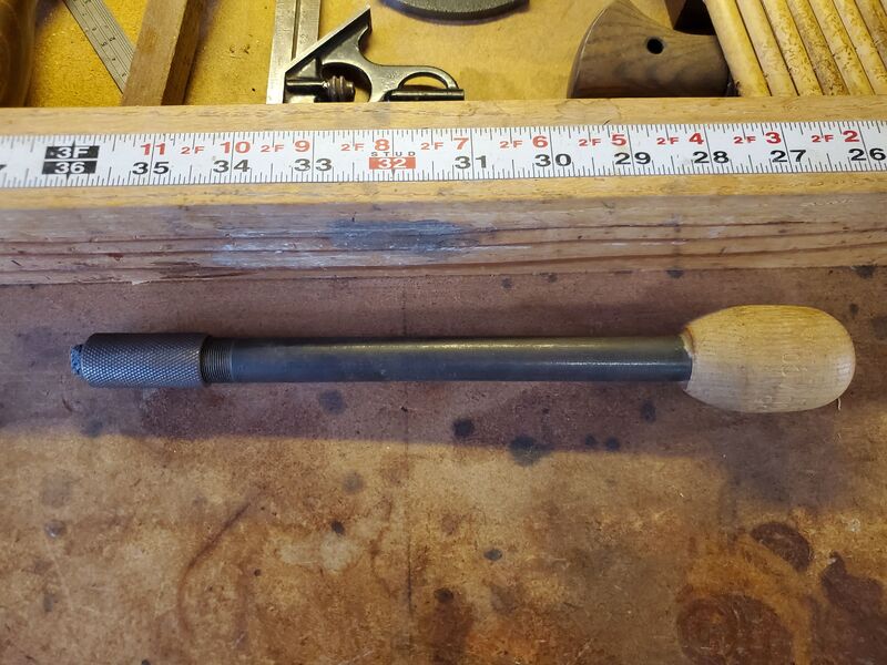

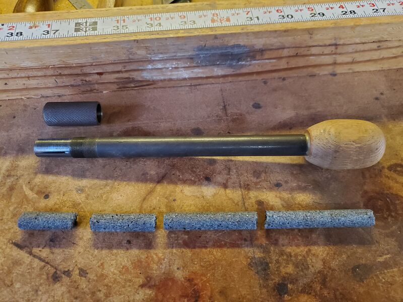

February 10Feb 10 comment_370793 I'd sure like some help figuring out what the heck this is. It has a wooden handle, it appears to be made from brass, you can see the dimensions.The collet spins off, loosening up what used to be a single rod of a coarse grit stone rod. It appears as you use it, you'd loosen the collet and let more extend out.Close up of the coarse grit rod. It has the same makeup as a grinding wheel.In hand for size context. Report

February 11Feb 11 Popular Post comment_370818 27 minutes ago, John Morris said:So what kind of wheel or tool does it dress?I will let Dave chime in but I have a “home grown” one that I dress my bench grinder wheel. The fancier versions have a diamond. Report

February 11Feb 11 Popular Post comment_370822 54 minutes ago, John Morris said:So what kind of wheel or tool does it dress?25 minutes ago, Ron Dudelston said:I will let Dave chime in but I have a “home grown” one that I dress my bench grinder wheel. The fancier versions have a diamond.As Ron said, I've only used it to dress my bench grinder stones which are mainly Aluminum Oxide. Works well for quick touch up. I do have a diamond dresser I use when I've contaminated (loaded) the wheels mainly with non-ferrous material.I've had mine for years. IIRC it was given to me by a welding supply salesman as a trial tool Report
