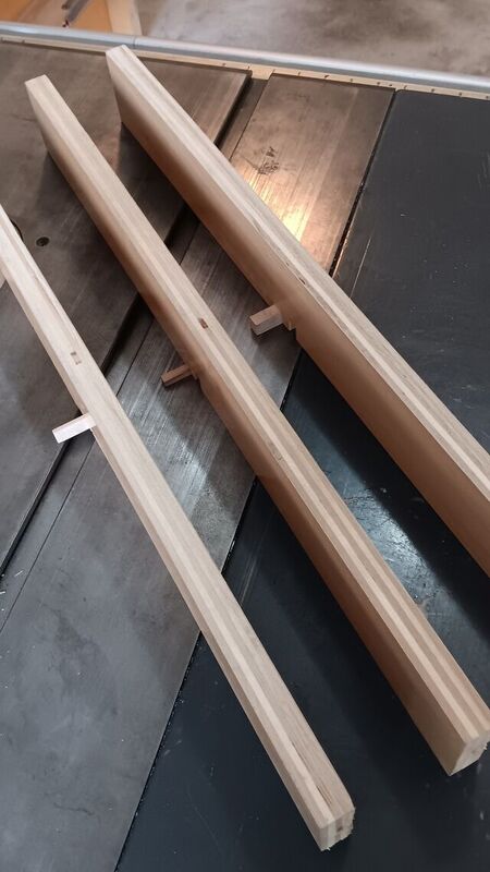

I do alot of handcut dovetails but there was a time I did alot of box finger joints. So much so that I designed and built my own custom adjustable sled for doing them.
Here you see the sled with the 1/2" finger insert.
The knobs on the back allow for micro adjusting looseness and tightness of the fingers. Test cuts are made and insert shifted accordingly.
This is a "stop block" that prevents the sled from disengaging from the table.
It is fitted over the front rail of the tablesaw and locked into place with two knobs. This also can be adjusted along the rail.
There are inserts for 1/8", 1/4", 3/8", and 1/2" (shown installed)
As mentioned each insert can be micro adjusted by loosening the knobs on the back fence, shifting, and re-tightening.
I also have waste pieces placed in front of finger insert so when cutting any tearout is minimized or eliminated.
