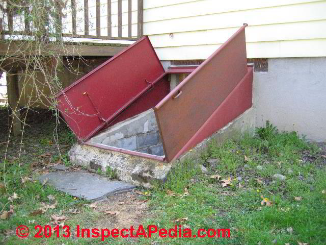

January 11Jan 11 Popular Post comment_368724 I don't know what you call this thing, but my daughter has just bought an older home for her children and neices to live in near the university most will be attending. There are outside steps leading to a basement door and there is a cover over the steps to keep rain, leaves, and potentially intruders out. It is quite rotted and I'e been tasked with making a new cover. The current one is 50" wide and 56" long and in two parts that hinge open. I'm looking for good alternatives. My initial thought was metal roofing panels, but most are 36"+ wide that makes them too wide. One source (Menards) will custom cut them to length, but I'm still worried that cutting the metal (painted or galvanized) will expose steel that will rust. Other options include 2.16' or 2.2' wide (that works better) polycarbonate, PVC, or fiberglass panels. These will not rust, but not as strong as metal. My plan with either is to make a pressure treated lumber under frame to attach the panels to. I'm looking for other ideas if anyone has any. Not the current one, but sort of the idea Report

January 11Jan 11 Popular Post comment_368738 These are called bulkhead door and can be made with either the side hinges as in the picture you shared or clamshell style with the hinges on the house side. If you want a bit of whimsy you can add details so it looks like a mouth opening, alligator or dragon. 🙂 Report
