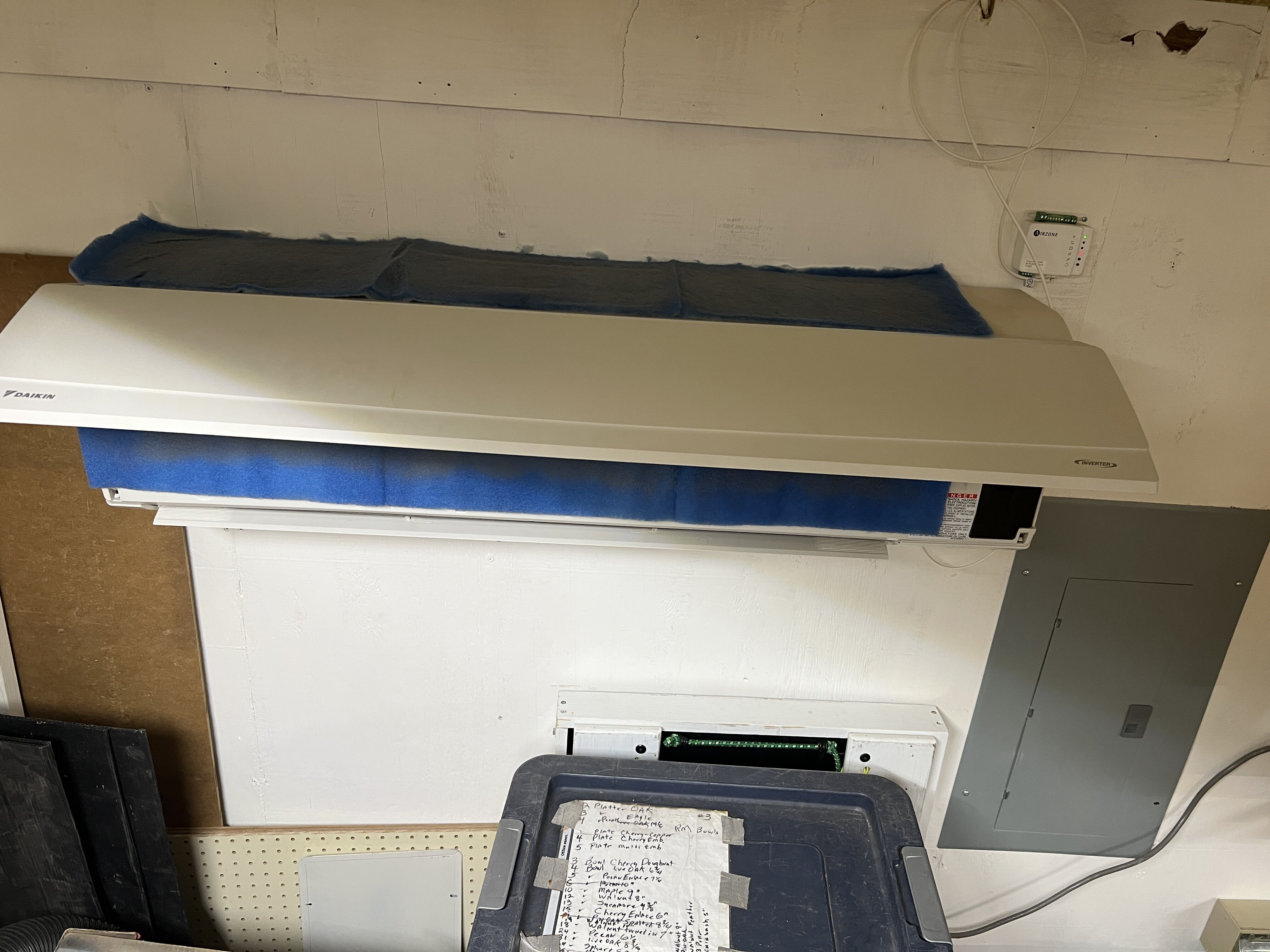

Do you have a picture of your minisplit setup? I'm still trying to decide how to setup a pre-filter system.
try to get that tomorrow

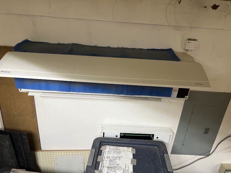

Memory is just not what it used to be when I get in shop. The filters need a bit of dusting.
best I can get of the top shows inside some.

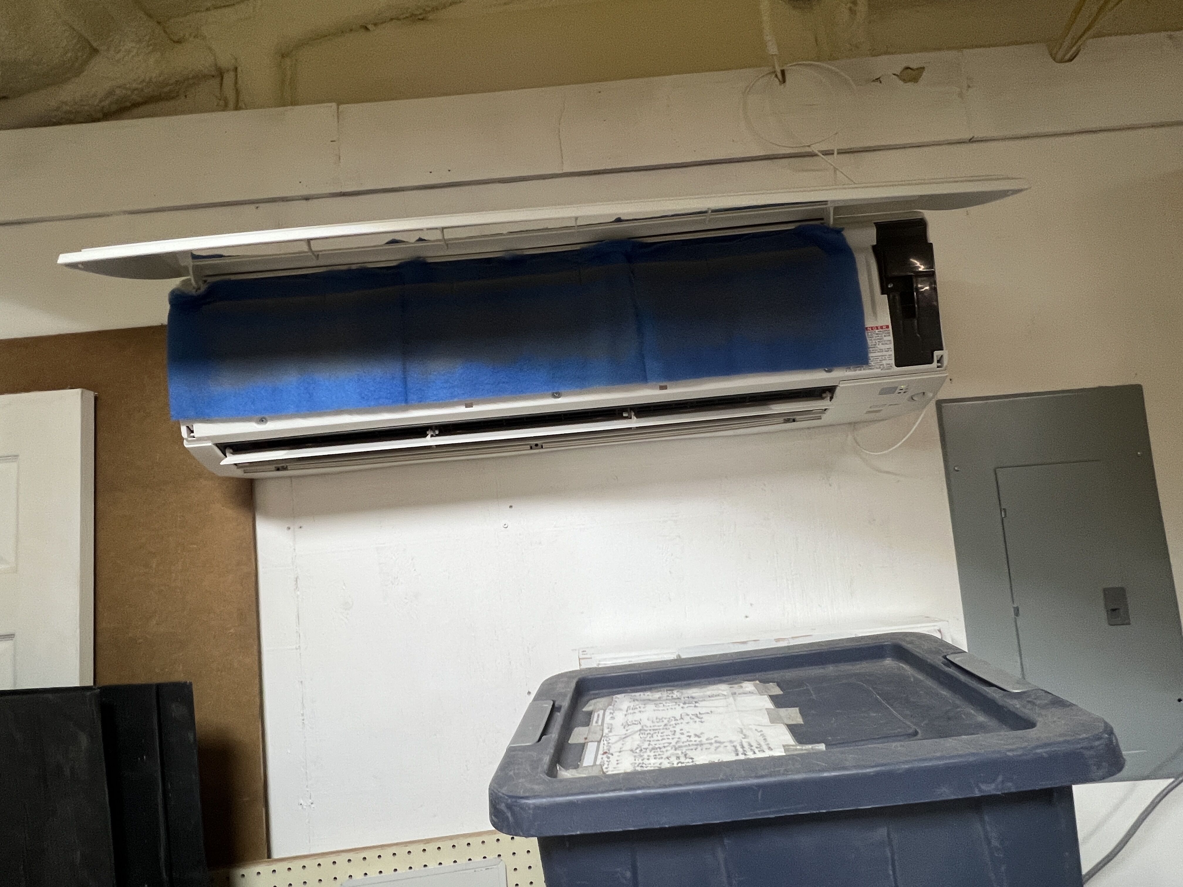

And this is the inside filter. Has not been cleaned in at least a month
Gerald- Thank you for taking these pictures. If I'm seeing correctly, you have that blue mesh inside the unit over the minisplit filter plus some over the entire top (the exterior intake area)?
