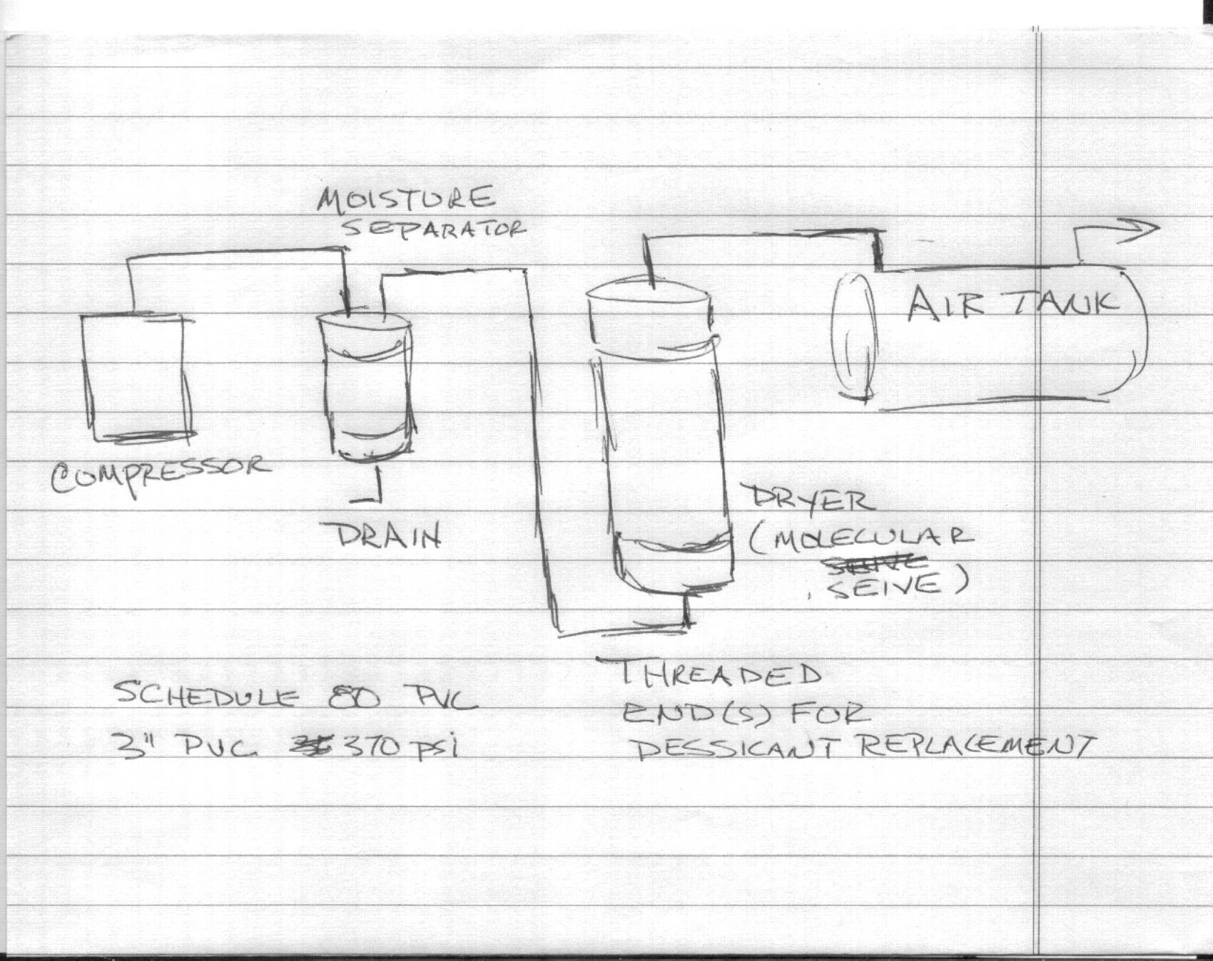

Here what I was thinking when I commented on the design-
It could all be built from Schedule 80 PVC. 3" has a rating of 370psi. The moisture separator work on the venturi principal. The air expands as it enters the separator, cools and the moisture condenses out. Air then travels thru the dryer and any additional moisture is absorbed by the molecular sieve (Linde 3X) dried air is stored in the tank ready for use.
The venturi action really won't restrict the available air because you are using the air from the filled air tank supply.
Air moisture indicators can be added to the dryer to indicate when the desiccant is no longer effective.
Thank you for taking the time to do this. If I understand correctly, The hot air coming from the pump (which is mounted on the tank) will automatically cool via venturi effect while entering the water trap through a 1/2" line. The moisture will immediately separate from the air due to it's newfound lower temperature and exit the water trap through another 1/2" line and go into custom manufactured Desiccant chamber with visually color indicating desiccant. To manufacture said chamber, would require 1 stick of Sch 80 PVC $100.00 and 2 end caps $40.00 ea. A filter element $75.00 (+/-) and misc. fittings and materials to complete fabrication.  Since PVC is not usually threaded, I would have to locate someone with the equipment  willing to thread the ends and I can drill and tap the end caps to accommodate the 1/2 NPT fittings which will give the aluminum adaptors approx 2 threads of bite in the PVC end caps. I would fabricate a mounting system that accommodates a water trap and a desiccant chamber and all the plumbing in a small area that will be very hot. To visually check the desiccant would require removal and complete disassembly of the desiccant chamber, then reassembly, sealing the threaded PVC joints, replacing the aluminum (single use) adaptors and pressure/leak testing and remounting..
This is where I get lost": 1) to create cold by any method, heat has to be removed, since that will take place inside a small enclosed chamber, where does that heat go? 2)All water trap manufactures insist that the trap be placed a minimum of 25 to 50 feet from the pump to be effective. 3) my understanding of the venturi effect requires significant reduction (restriction) of flow. How does that occur with an outlet the same size as the inlet? If restriction does occur, how would that not reduce the  CFM capacity of the pump and why wouldn't it create extra stress on the pump and drive motor?  Are you suggesting the use of a commercially available water  trap or a custom fabricated unit?
Others have suggested that I am creating a Sleeping Giant that would put Hiroshima to shame but I haven't seen an explanation. It has been suggested that an external, stand alone tranny cooler (which can't be thermally connected to anything), would be more effective than the internal unit which is integrated (thermally connected) with an extensive cooling system designed to cool an internal combustion engine and a transmission.  Even though I adhere to the Safety Third methodology, and I am not all that concerned about OSHA or other rules, I would still like to keep all of my fingers and not die in an explosion. Any and ALL Sch.'s of PVC is not rated (or allowed) for compressed air. What is the advantage of your suggested custom manufactured desiccant chamber over a commercially available, off the shelf unit with a clear pop-off bowl?
Obviously I am completely disconnected from reality and I openly admit that I am not as fearless as some of the roofers I have known over the years and I was a little intimated when I was testing the last compressor I built without the belt guard in place. (in the 70's,roofers were losing fingers faster than a junkie looses braincells) when truck mounted compressors were becoming commonplace on jobsites but belt guards were not as good as they should be. This is mentioned because it was my intension to use my $1.00 (one dollar) Atomic radiator bomb as the belt guard. I have spent my entire life working with dangerous equipment starting when I was 16 (identifying as 18) operating a table saw in a production shop with NO guards and still nothing scares me more than shattering pressurized PVC. There will have to be some solid advantages for me to use it and I will install scatter shields...  Looking forward to a follow-up..
