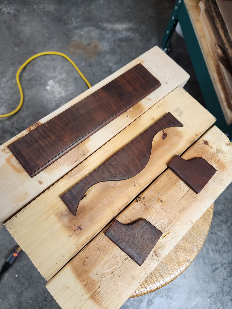

January 14Jan 14 comment_368877 I've used both ferric acetate and ferric nitrate on various pieces of maple. With either one you can add hydrogen peroxide to convert it from a dark finish to a brown one. I'm not sure how the chemistry of that works, but then I'm not a chemist. Seems to be pretty stable though, usually the brown iron colors are more stable than the black ones (like I said, not a chemist!). I've mostly done this for gunstocks. One thing I've found is that it's pretty important to use pieces from the same board if you need them to match. Maple has very little tannin, so you really notice variations from one variety to the next or even one tree to the next. The stocks I was making were three piece - butt, fore end, and grip. My impression is that fresh solution behaves differently than old solution, but I haven't made a study of that. For ebonizing I think the ferric acetate is best, it seemed to be darker before I would hit it with peroxide. On a high tannin wood like oak that may not matter of course. Report

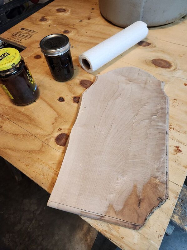

January 15Jan 15 comment_368915 Here is a video of Jim Kibler and his method (at least at that time for the vid) of using aqua fortis and along with tannic acid. Jim is an accomplished contemporary builder and is as talented as they come imo. I've never tried any of his finishing techniques exactly but probably will check out the tried and true someday. I personally like it for a solid base stain and if I take a notion, I can rub some others in if I'm after a slightly different tone but the light fastness and overall look I want is there. I have several in process post on the "whats on your workbench thread" of some maple boards I'm working up for euro mounts. This is the smallest one. I still have a lot of sanding and cleaning up to do but lately I've been applying stain early on in the process. I think I get a better soak and I apply multiple times as needed anyway. I have appied tannic acid here and let it dry, applied the ferric nitrate and took the pic with the board still slightly damp. The next work session I will blush it with a heat gun then continue cleaning up my edges and begin some sanding to see what I have. Report
