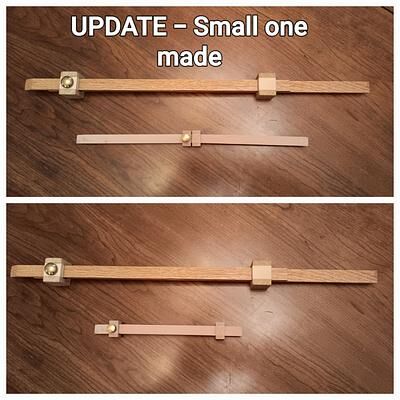

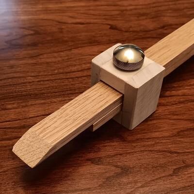

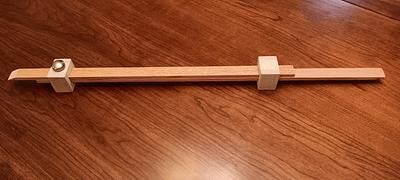

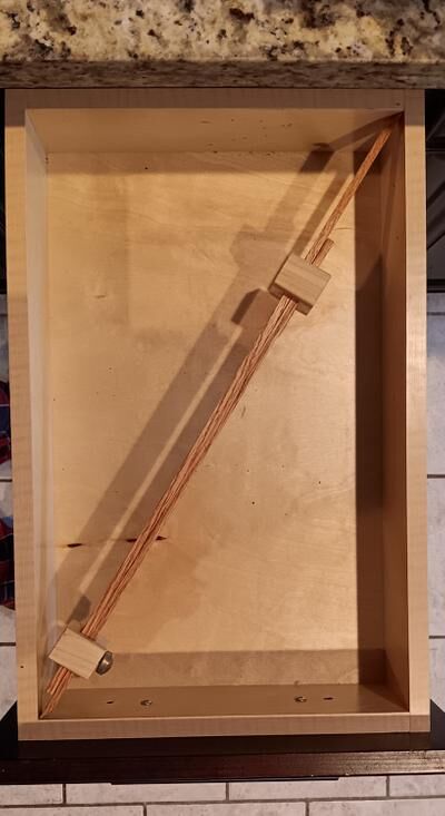

November 10, 2025Nov 10 Popular Post comment_364962 This is a Pinching Rod that I made for checking squareness of boxes, drawers etc. It's made out of Maple. It's range is 21"- 34". You check both of the inside diagonal corners to see if they match. If they do then it's square. Obviously if they don't you aren't square. I also made a smaller one as well (See the photo that says update). You unlock the new knob, slide the rods to touch opposite corners inside the box, etc. Then lock the knob. Here's a top view of a drawer pulled out where I'm checking the squareness of the drawers. Here's the small set of punching rods. Thanks for looking! Cheers! MrRick Report

November 10, 2025Nov 10 comment_365019 Love it Rick. I love hand made tools like this. Hey, do you know how much history is behind this tool? Does it go waaay back perhaps to 18th Century furniture building or? Make me want to get out to the shop and make some. So Rick, is there a threaded insert for the knurled brass knob? Report
November 10, 2025Nov 10 Author Popular Post comment_365020 From what I understand, pinching rods or sticks were common before the widespread availability and use of tape measures. They are considered very accurate for measuring the inside of a drawer or cabinet frame and then using that exact length to set a saw or check diagonals for squareness. Mine do not have threaded inserts. There isn't enough wall thickness to use them. Instead the wood was tapped for 1/4-20. I doubt there will ever be an issue going this route. Edited November 10, 2025Nov 10 by MrRick Grammar Report
November 10, 2025Nov 10 comment_365022 3 minutes ago, MrRick said: Instead the wood was tapped for 1/4-20. I doubt there will ever be an issue going this route. Brilliant! Report

November 11, 2025Nov 11 comment_365050 12 hours ago, MrRick said: Gerald....I don't think those can replace the accuracy of pinching rods. But hey... whatever floats your boat! Lol. I think you misunderstood my post . My sticks are exactly like yours but use a thumb screw and only one keeper , not the two as you have . Not sure where I picked this up but either a Shop Notes or Wood magazine at least 20 years ago. Report
