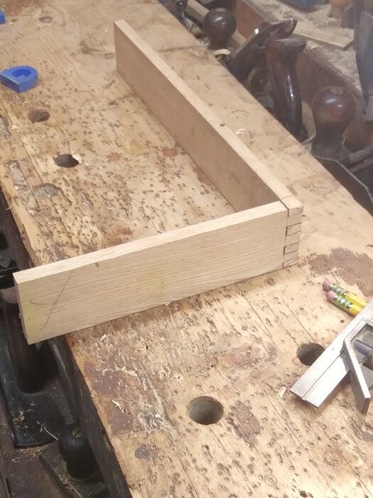

October 20, 2025Oct 20 Author comment_363471 Before the joinery could begin...all 4 side pieces needed to be a wee bit flatter.. Front and... Back were leveled on both faces as needed...then, adjust the "Jig" a bit... And do both of the ends..both faces... Get everything sharpened up and ready to go...That chisel sets the spacing of the fingers.. This is the back of the box...1st corner...then a bit of work with a saw.. Then a bit of work with that chisel... Chop halfway down on the show face, then... Remove the rest from the Inside face...use these fingers to lay out the matching set...saw and chop, then a dry fit.. Stopped here for a day....then, while on Laundry Detail.. Get the rest of the corners milled, enough to do a dry fit...with clamps So..clear some space... Lay all 4 sides out, in order...the a Flash Mob of Clamps followed the bottle of glue to the bench.. 1 x2 scrap of pine to keep the long sides from bowing in....let this sit a day..or 2.. Next episode? "Hey, yer slip is showing.." Stay tuned... Report
