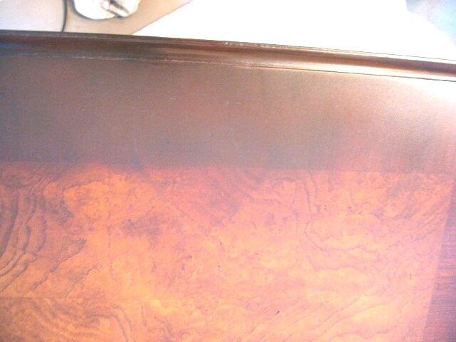

September 4, 2025Sep 4 comment_361197 Here is a good article on using toners. A toner is a finish that contains a colorant, a dye or a pigment. Factories use them extensively (maybe even exclusively) to color furniture. I regularly used them to do touch up repairs. My two comments on toners Apply very light coats. It's easy to go from not quite there to too much all of a sudden' They really work best when sprayed. It's difficult to get an even coat when brushing. Hence Polyshades often looks terrible. https://www.woodmagazine.com/woodworking-how-to/finishes-finishing/wood-toning-101?hid=b0b455ea13e71c23a3fc22b044c0be06fb838bd1&did=19329554-20250904&utm_campaign=wood-online_newsletter&utm_source=wood&utm_medium=email&utm_content=090425&lctg=b0b455ea13e71c23a3fc22b044c0be06fb838bd1&lr_input=054cc015b57d54e1680d1a6048482c50e9b71e5448ad337fc319f7f4f4e52672&lr_input=054cc015b57d54e1680d1a6048482c50e9b71e5448ad337fc319f7f4f4e52672 I tried printing it, but the photos didn't come thru. But in case the link does not work in several years, woodmagazine.com_woodworking-how-to_finishes-finishing_wood-toning-101_print.pdf Report
September 4, 2025Sep 4 Author comment_361198 Forgot to say, toners are also used as "shaders" to darken or highlight certain areas. A typical application is around the border of a raised panel (see photo in the article link). Report
