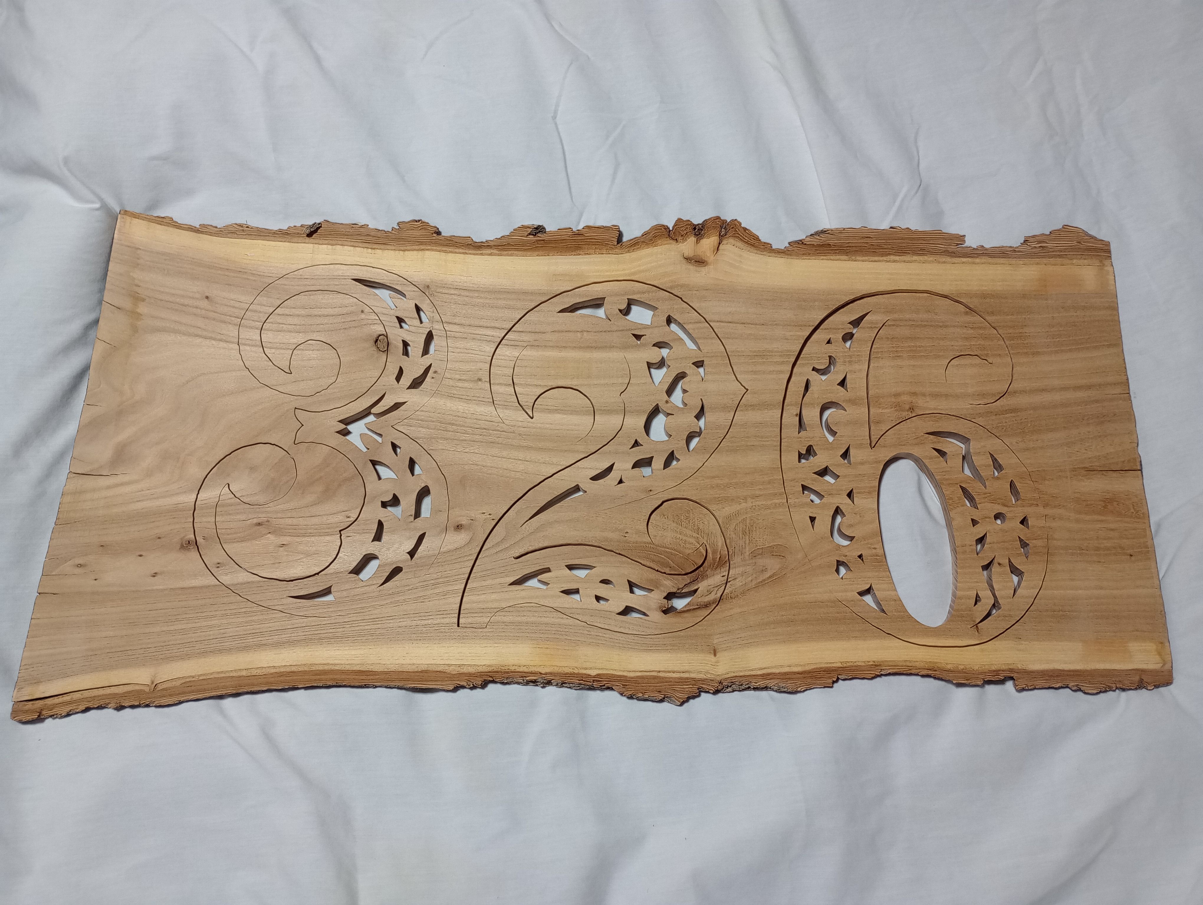

August 22, 20251 yr Popular Post comment_360534 My current project; house numbers. Each number is approximately 7 x 10" with the overall width of the board 30". My saw is a 22" Hegner, so I had to come up with a method to cut all the fancy fretwork with what I have. My solution is to use spiral blades ( 2/0 ) to cut the outside of the numbers and then use flat blades to cut the inside frets. Once I have the fretwork cut I'll stain the number for more contrast, then glue the numbers back into the board with polyurethane glue and add a backer painted white. Report
August 22, 20251 yr Popular Post comment_360536 Wich, you really have a steady hand to cut those so smoothly...well done. Report
August 22, 20251 yr Popular Post comment_360539 ∆∆∆ What Fred said Wich ∆∆∆ Those look laser cut perfection. The fretwork will add an interesting dimension. Definitely following along. Edited August 22, 20251 yr by Grandpadave52 Smart phone stupid auto correct Report
August 22, 20251 yr Author comment_360554 2 hours ago, Grandpadave52 said: ∆∆∆ What Fred said Wich ∆∆∆ Those look laser cut perfection. The fretwork will add an interesting dimension. Definitely following along. Oh trust me, these are nowhere near laser perfection. I'm using this as a skill building exercise ( spiral blades ) for other projects that are oversize. :) Report

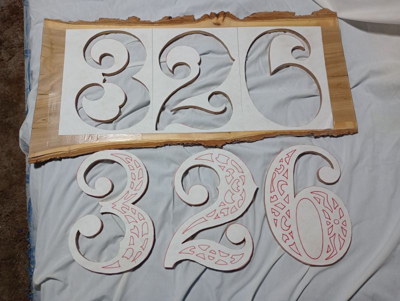

August 26, 20251 yr Author Popular Post comment_360694 Progress! All the numbers and frets are cut. Now, on to the staining. I need a darker stain for contrast. I will test with Minwax dark walnut to start. Report
September 1, 20251 yr Author Popular Post comment_361006 The contrasting stain applied. I have the opportunity to backlight the project using the transom window above the front door and installing a light behind it. I will need to enlarge the kerf around the numbers using a larger spiral blade then when I first cut the numbers. Report
