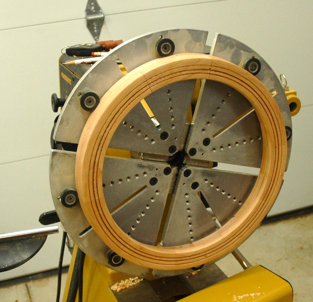

April 20, 20251 yr Popular Post comment_355430 I made this ring to be used as a frame. I'm wondering about burning a trim mark or two around the circumference, similar to using a wire to burn a mark on a spindle. Is it even possible? My plan would be to leave it in the cole jaws and use a nail or something rested on the tool rest, holding it against the ring as it turns. Since this is in those jaws I may not be able to run it fast enough to burn, and my plan of using a nail with the end ground round might not work....or would it? At this point I'm still experimenting/learning what's possible. Report

April 21, 20251 yr Author comment_355461 I wasn't very clear about where I would like to place the burn mark. I said circumference but what i really want is to put one/two on the face of the ring. I've used a wire to burn on spindles, but this one will be a little different. I have some laminate in the shop, I might give that a try...I am a little nervous about running it at a high speed in the cole jaws. Report

April 21, 20251 yr Author comment_355489 Well, I tried it using a piece of laminate and it worked, sort of. The burning was real consistent around the ring and I wasn't happy with the results. I do like the idea and may tru to refine it maybe on the next piece. But for this one, I took a detail tool and cut the burn off, leaving just some grooves in the face. In thinking about it, I probably could use some kind of marker and color the grooves...maybe some other time. Report

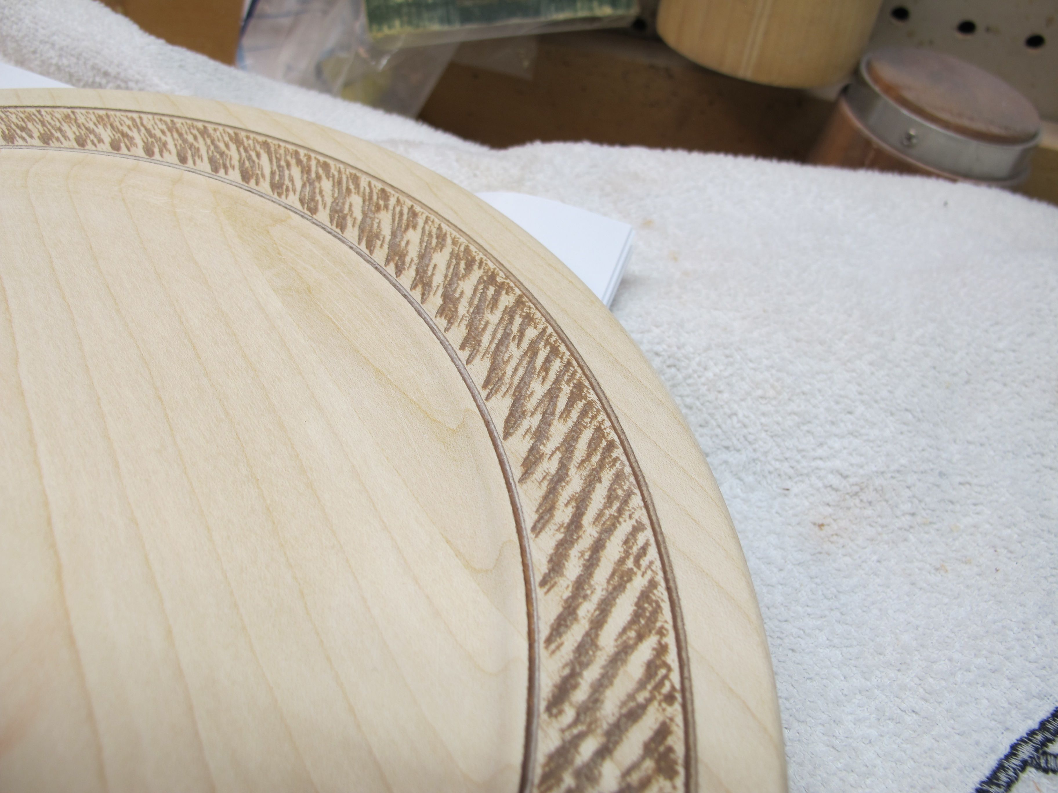

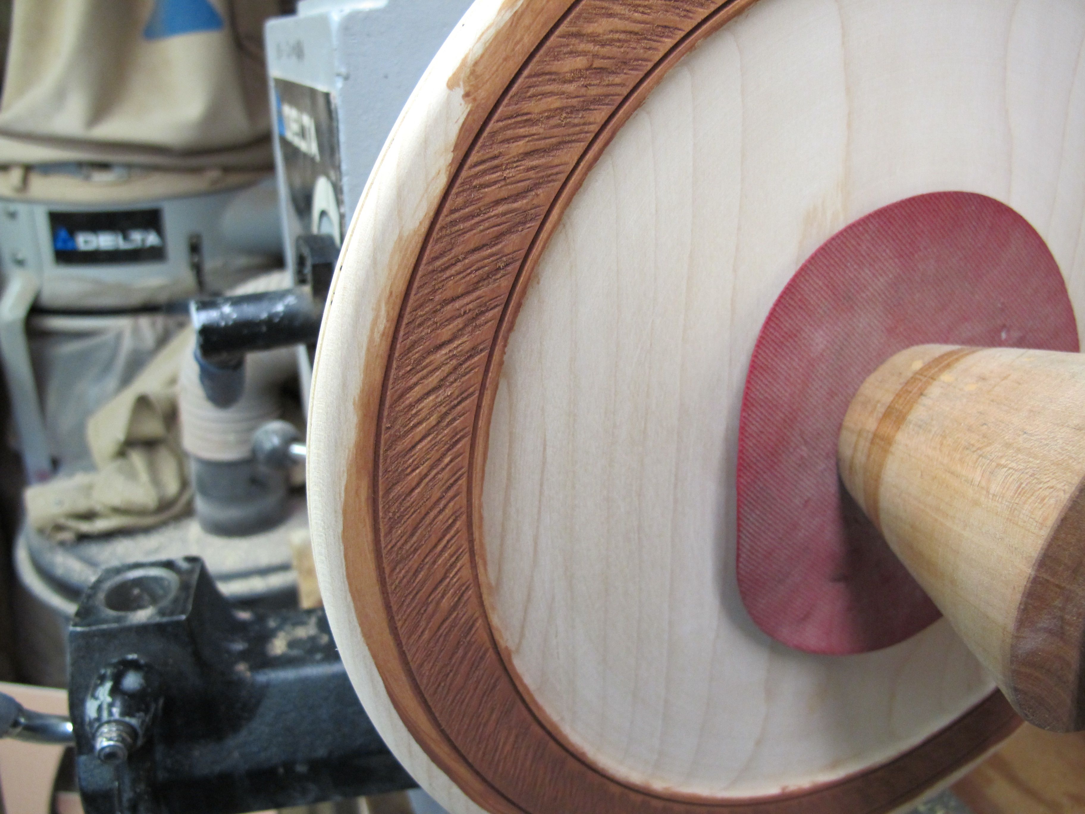

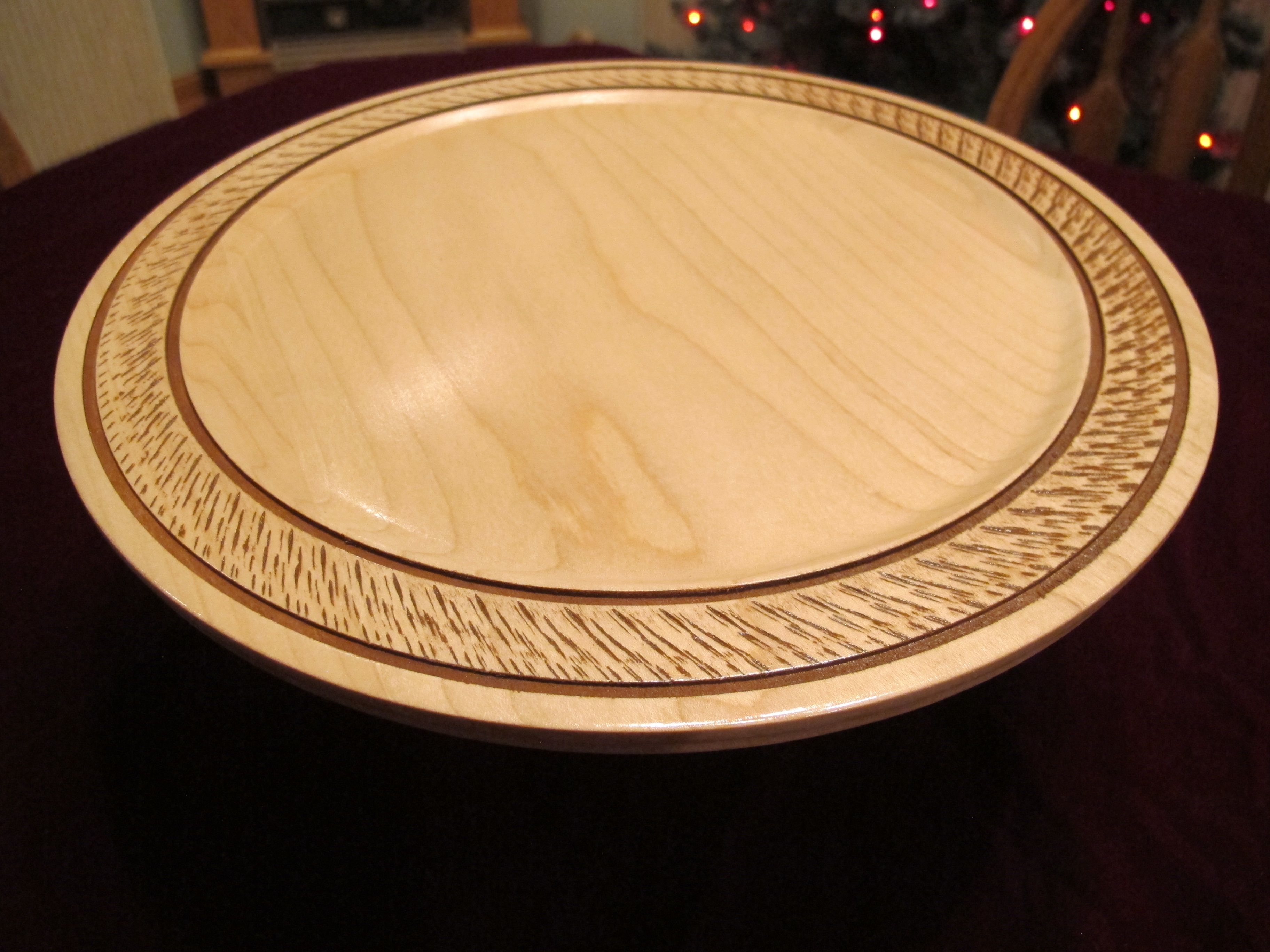

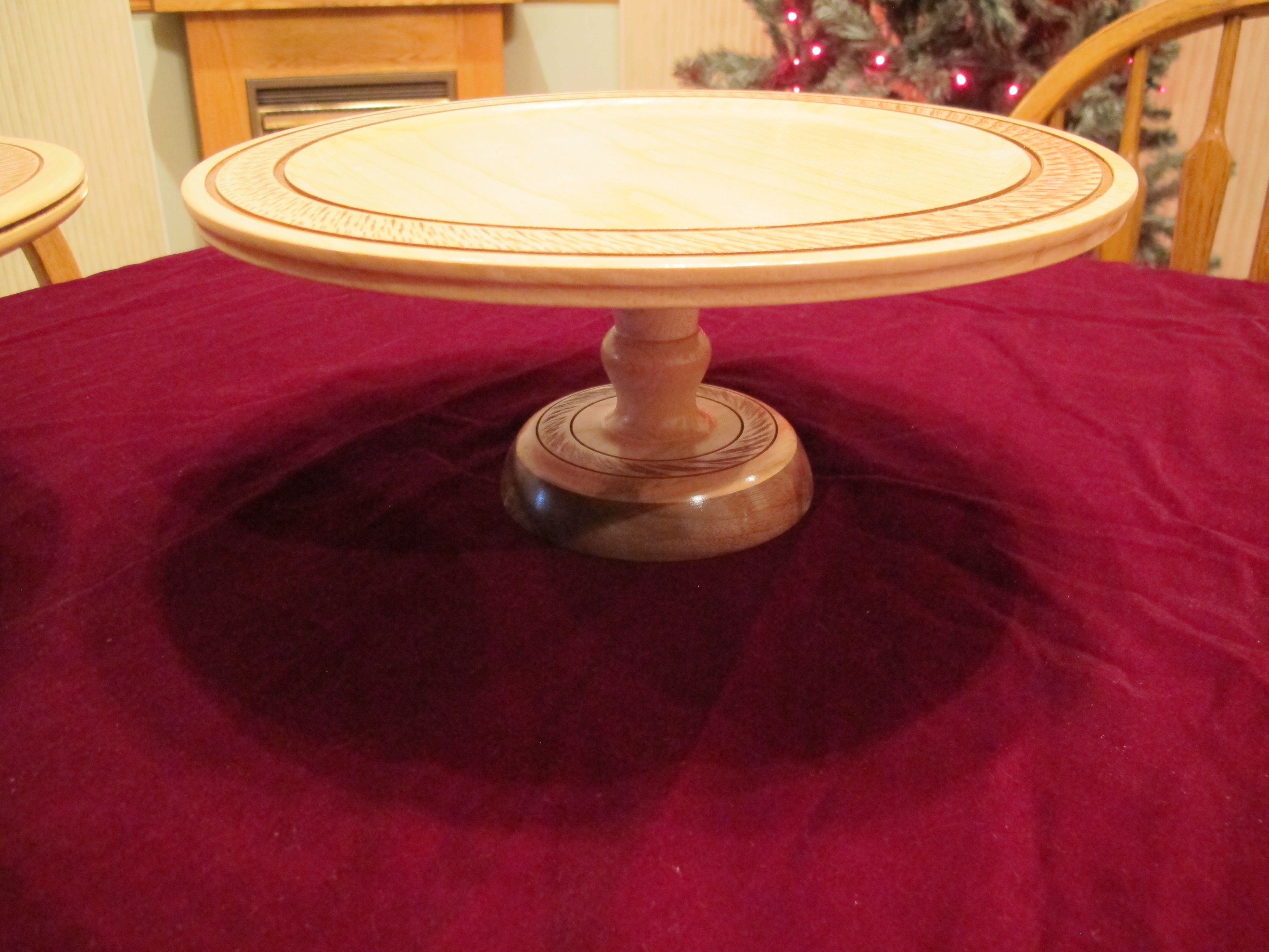

April 22, 20251 yr comment_355495 Here's an alternate method. I made some cake serving platters from maple and walnut. To spice up the top, I used the EWT detailer and a Sorby Texture tool. The applied acrylic paint to the line/textures. Once dried, sanded the paint from the areas I didn't want it. To protect the paint, I finished the items with wipe on poly. Report
April 22, 20251 yr Author comment_355496 Thanks, Lew. Those platters are beautiful! That would be a good method for me to use. BTW, I should mention that those big cole jaws whirling around at a higher speed (~950RPM) are almost as frightening as using a molding head cutter on a TS. The fan noise is really alarming. Edited April 22, 20251 yr by Fred W. Hargis Jr Report
April 22, 20251 yr comment_355498 1 hour ago, Fred W. Hargis Jr said: those big cole jaws whirling around at a higher speed (~950RPM) IIRC a set of cole jaws has a suggested rpm depending on the size of the jaws. My 10" set has a suggested speed of only 600 rpm. YMMV. Report
April 22, 20251 yr Author comment_355499 1 minute ago, smitty10101 said: IIRC a set of cole jaws has a suggested rpm depending on the size of the jaws. My 10" set has a suggested speed of only 600 rpm. YMMV. You are correct I think. This set I have (12", maybe) says 1000 RPM on it. Report
