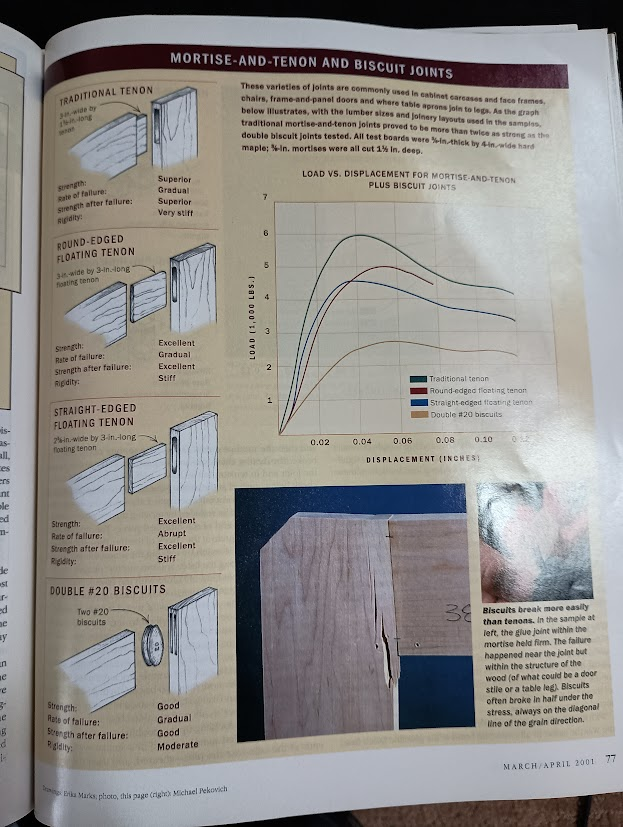

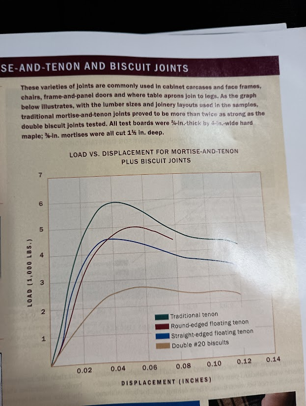

In my re-reading of "vintage" FWW (#148), I ran across yet another joint test.  Again, one type of joint (butt as in a rail and stile) and one type of force (diagonal to the corner)  But some interesting results.   Round-shouldered loose tenons (e.g., Domino) are somewhat weaker than integral tenons, but of course much faster to do.  And a double biscuit joint, while about half the strength, is "not just for alignment only."   As I've said many times, it might be strong enough for its intended application.  Would I use it on a chair, no.  Is is strong enough for a cabinet door, probably, unless your 8 year old swings on it every day.

Cabinet frames, doors with panel in the middle, etc, won't fail as easy a simple corner joint.  The load on a frame or door is resisted by all four corners and the door panel which wants to stay square.   So multiply the strength result by 4 at least.  More if it has a panel in the frame.
