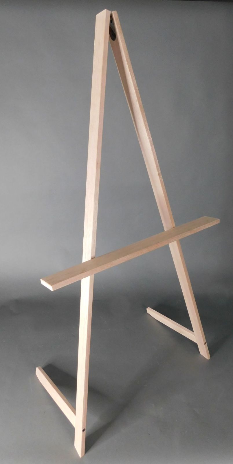

Glamor shot.   Waiting for a warmer day to put a finish on the parts.
I've got a spare hinge, and several spare bolts for the legs.  Thinking about making one from walnut If I can find a local source for a 1x6 x 8' walnut board.
4D

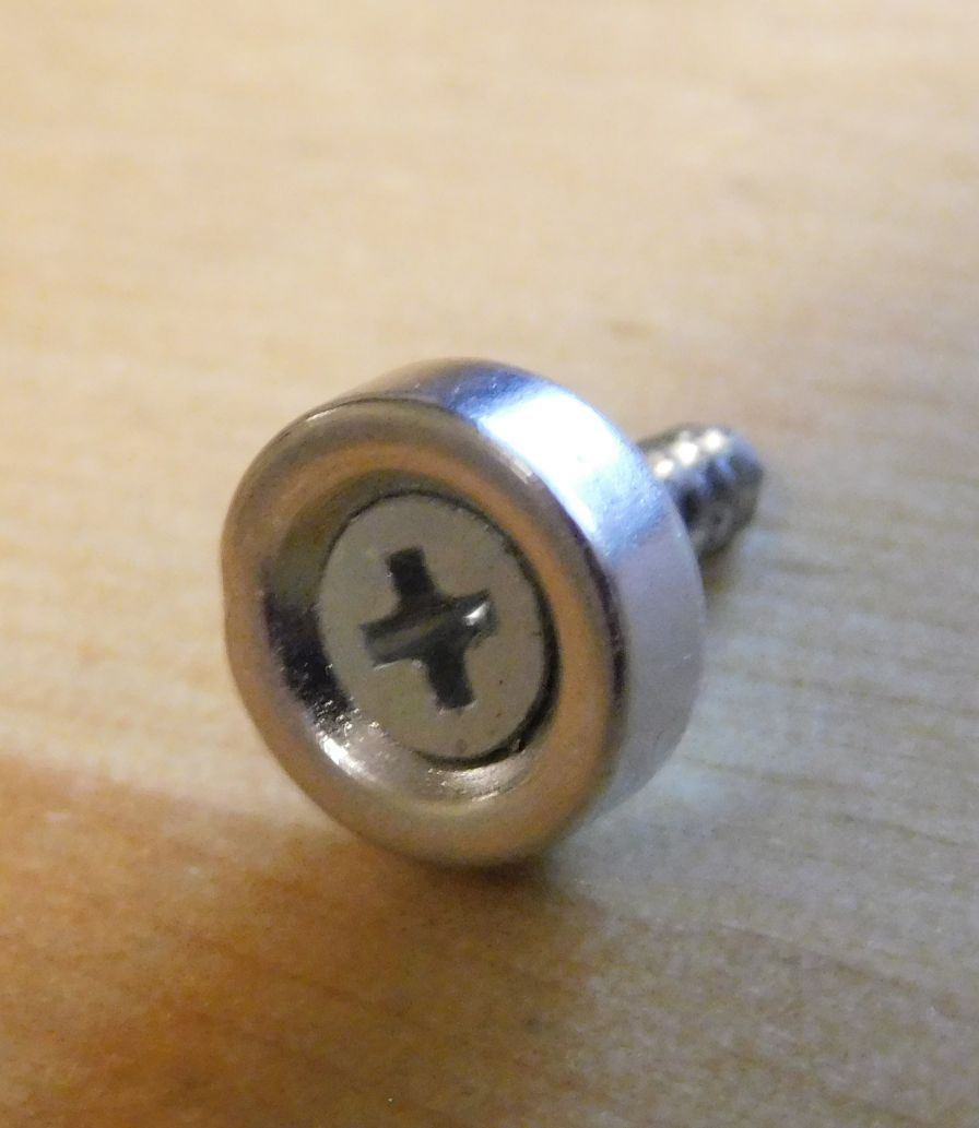

Been contemplating a way to make sure the shelf doesn't slip off unless you want it to.  Found some 3/8" diameter rare earth magnets with a hole for a screw in them.  Ordered some 3/8" x 3" steel rods to replace the aluminum rods.  Magnets arrived and playing with one I think if I screw one down in the bottom of each hole the steel post will take a pretty good tug to remove when stuck to them.  Simplest idea I could come up with.

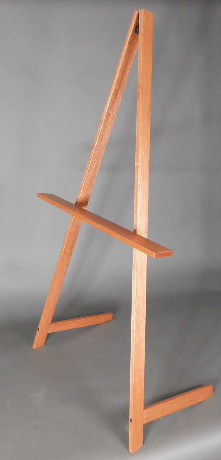

The mahogany stand legs have some internal stress and want to twist the stand.  With the shelf held snug against it the metal rods keep the legs aligned. Resist the twist.
4D
Finally had a chance to stain and finish the easel.  Also added magnets and steel rods so the shelf would stay snuggly connected but still be removeable.
Cherry stain.  Two coats of Minwax Polycrylic on top.  Light appears to wash out the color of the front leg but in person the color is consistent on all parts.
4D
