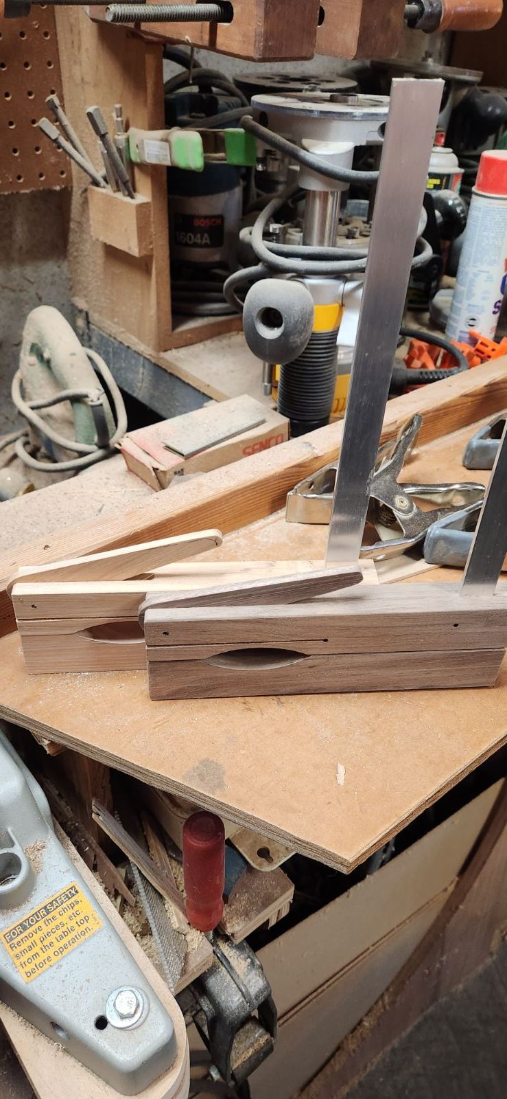

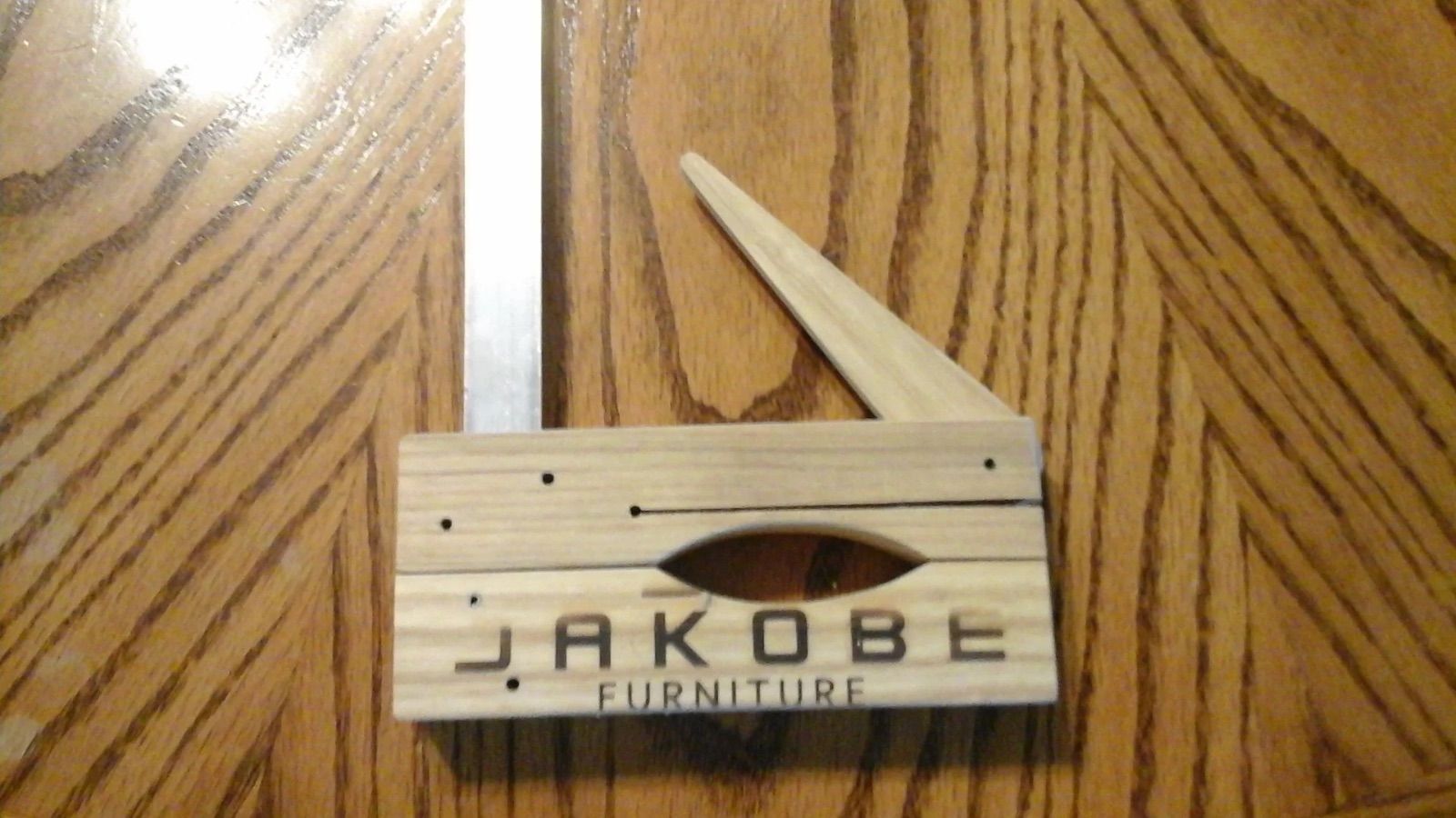

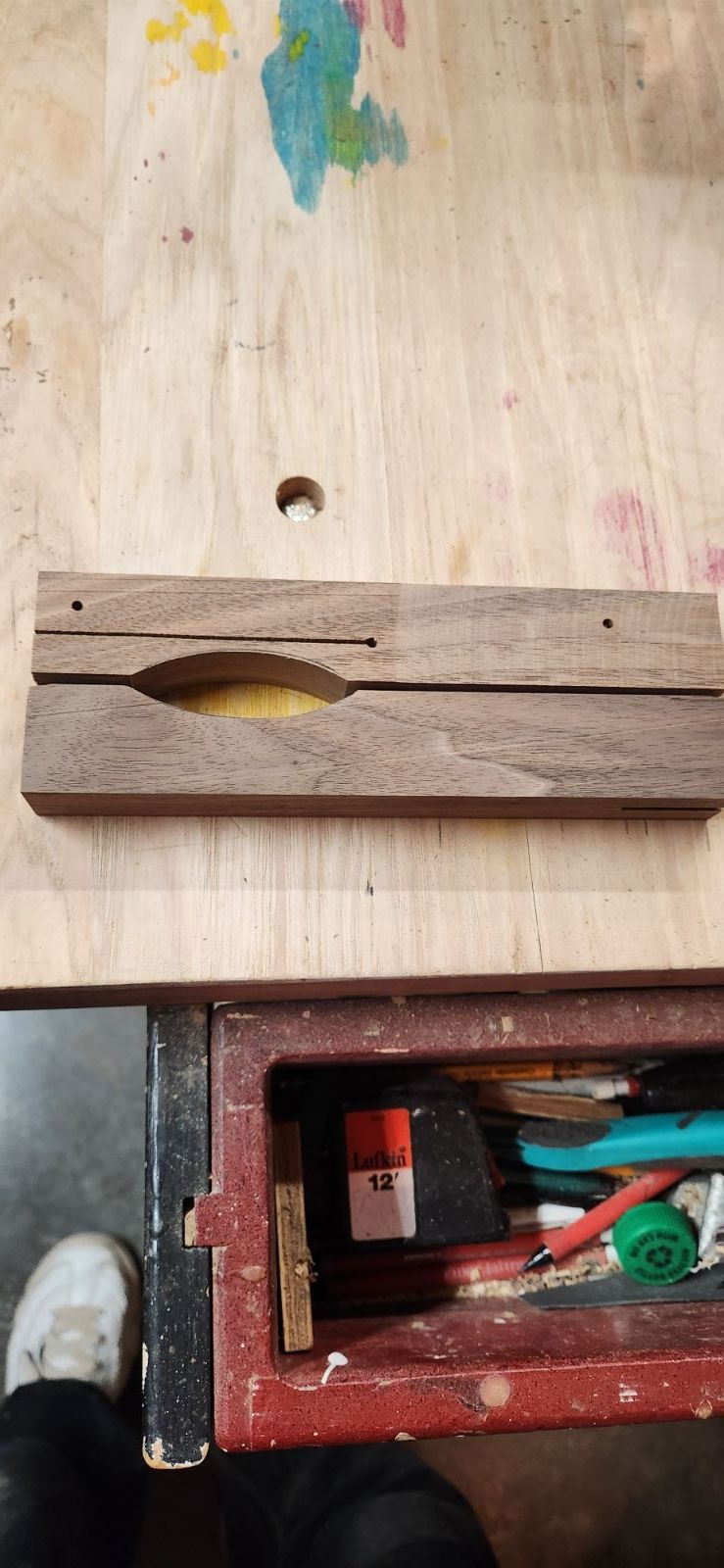

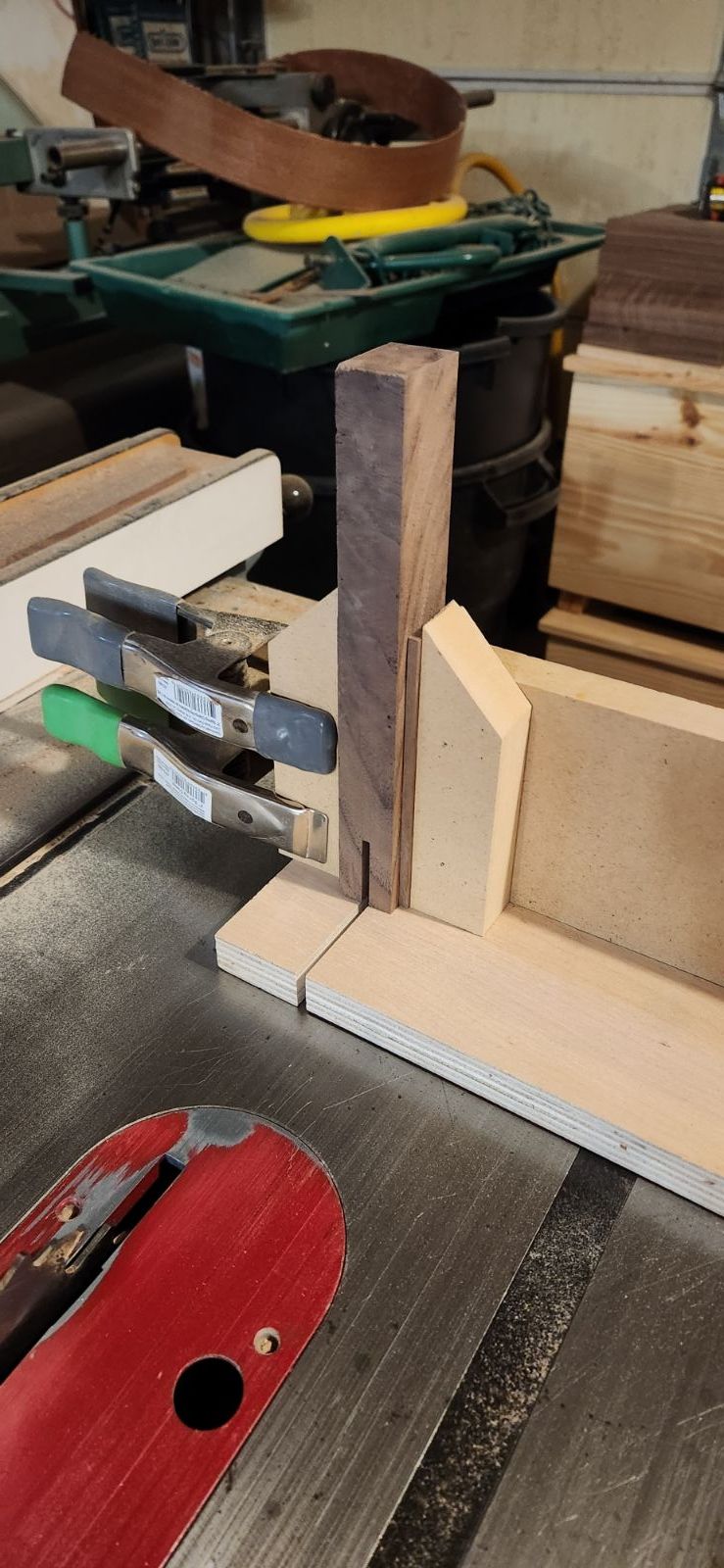

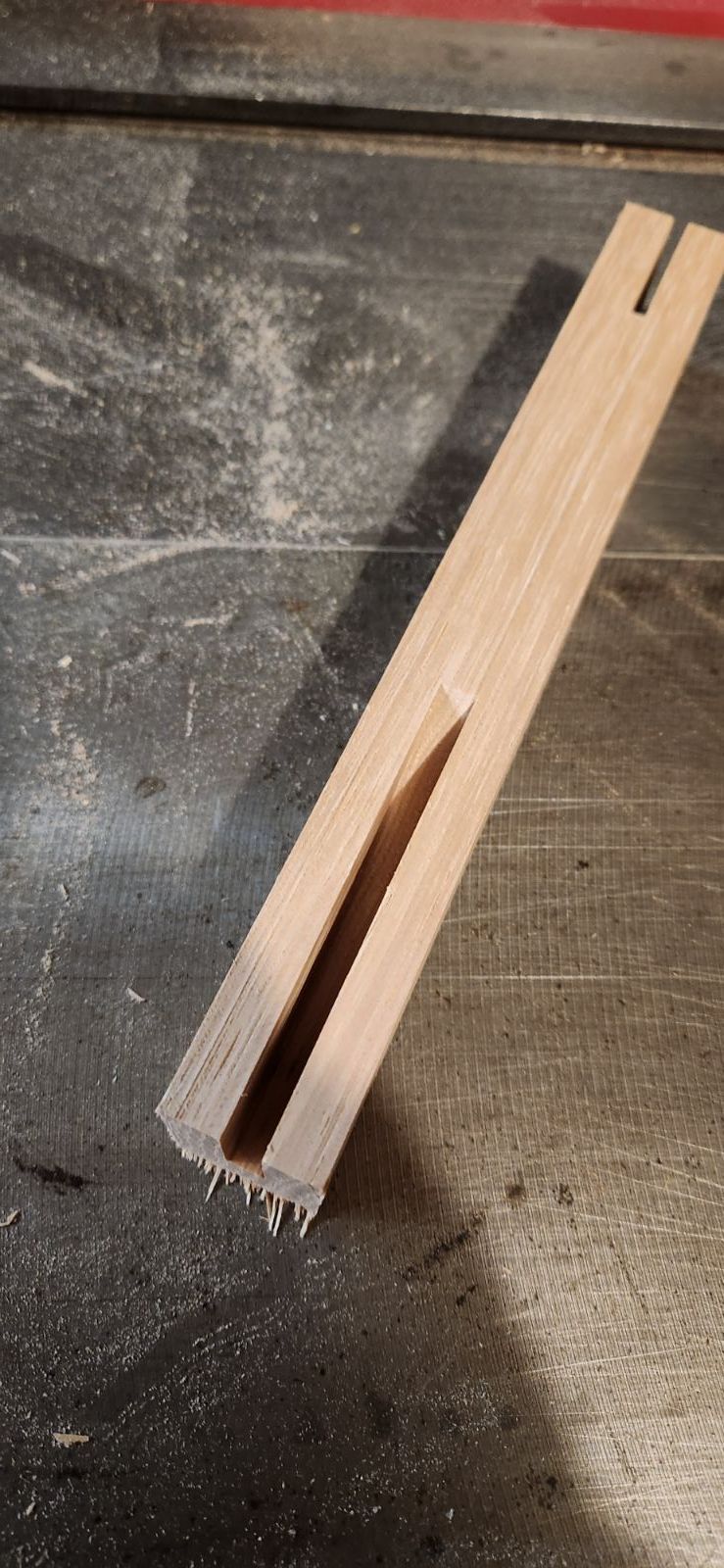

February 4, 20251 yr Author Popular Post comment_351230 Combination of Hickory,Ash and Walnut… Edited February 4, 20251 yr by BillyJack Report

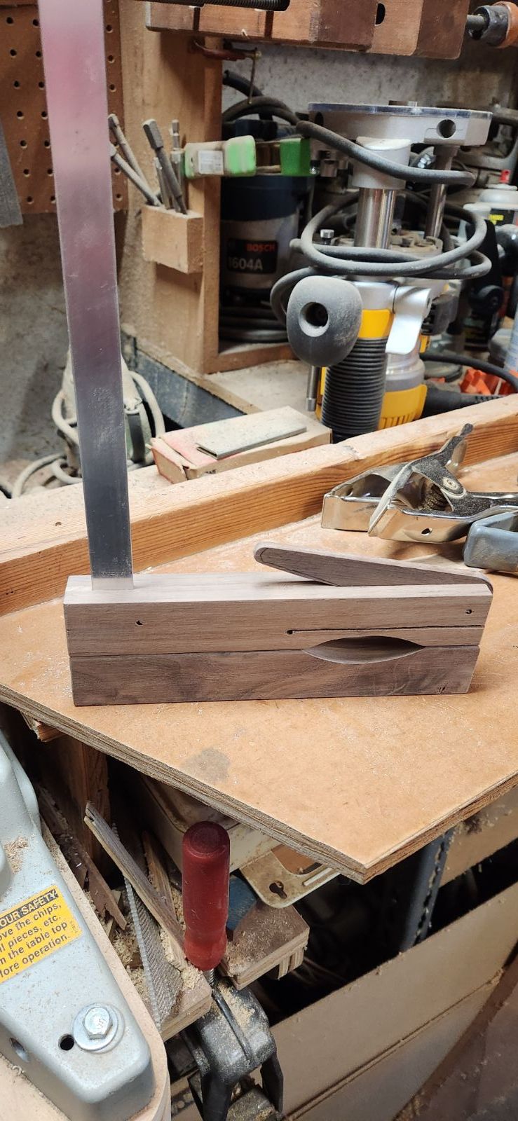

February 5, 20251 yr comment_351250 I was admiring those clamps of yours, looking forward to the build details! Report

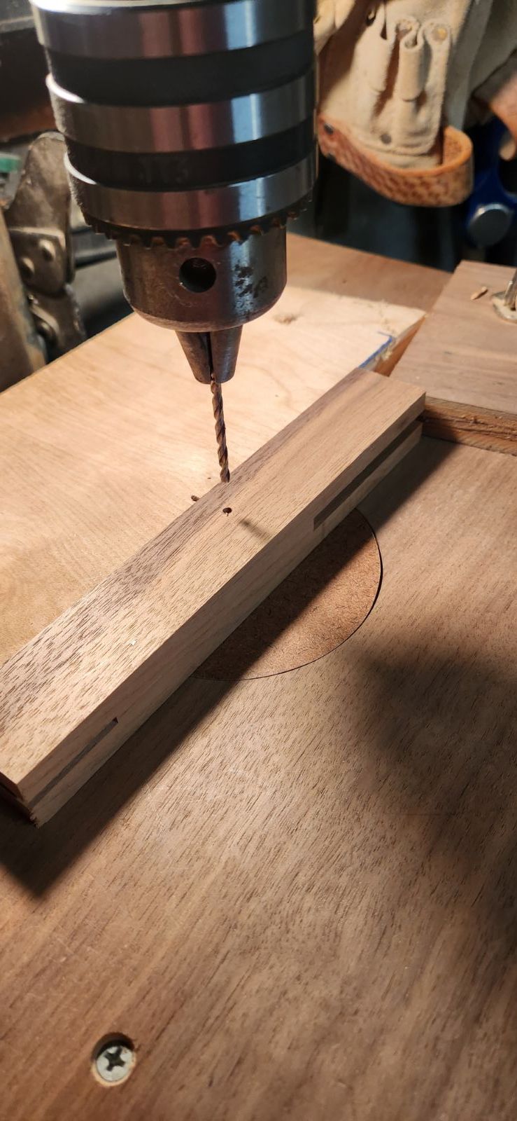

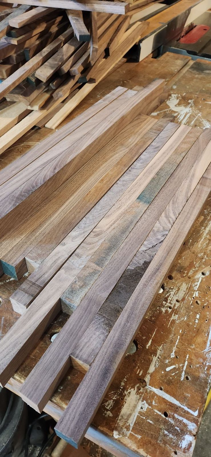

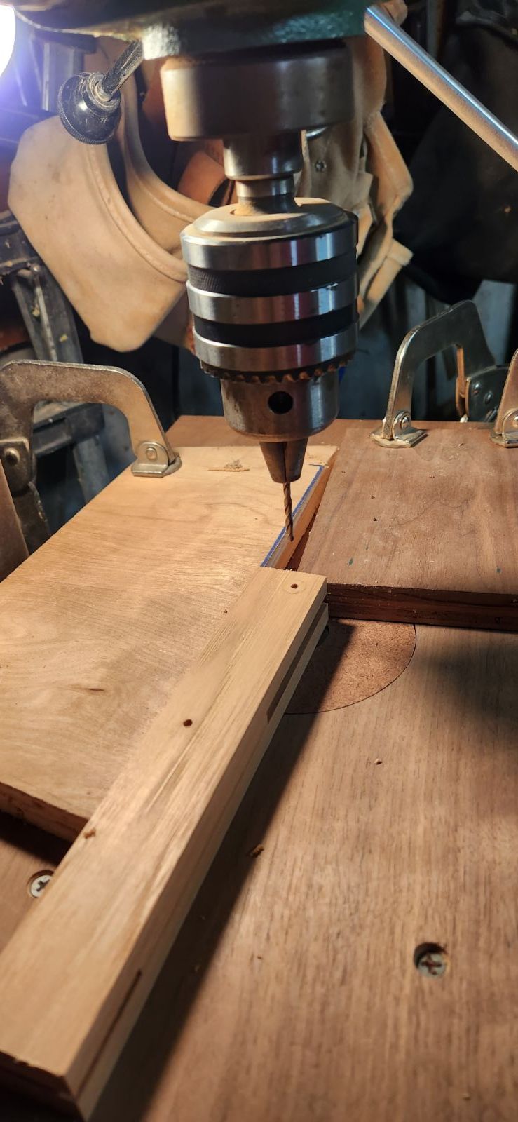

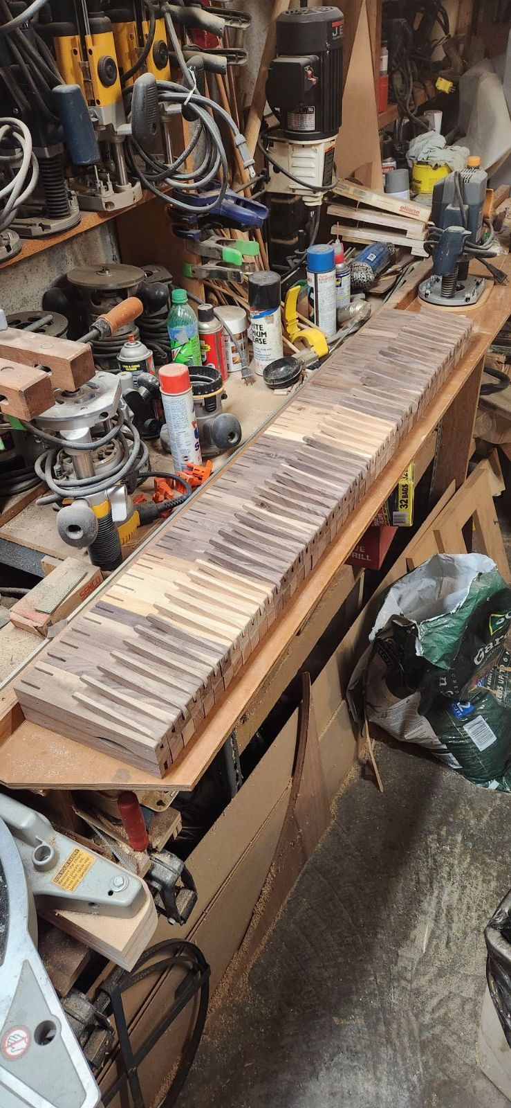

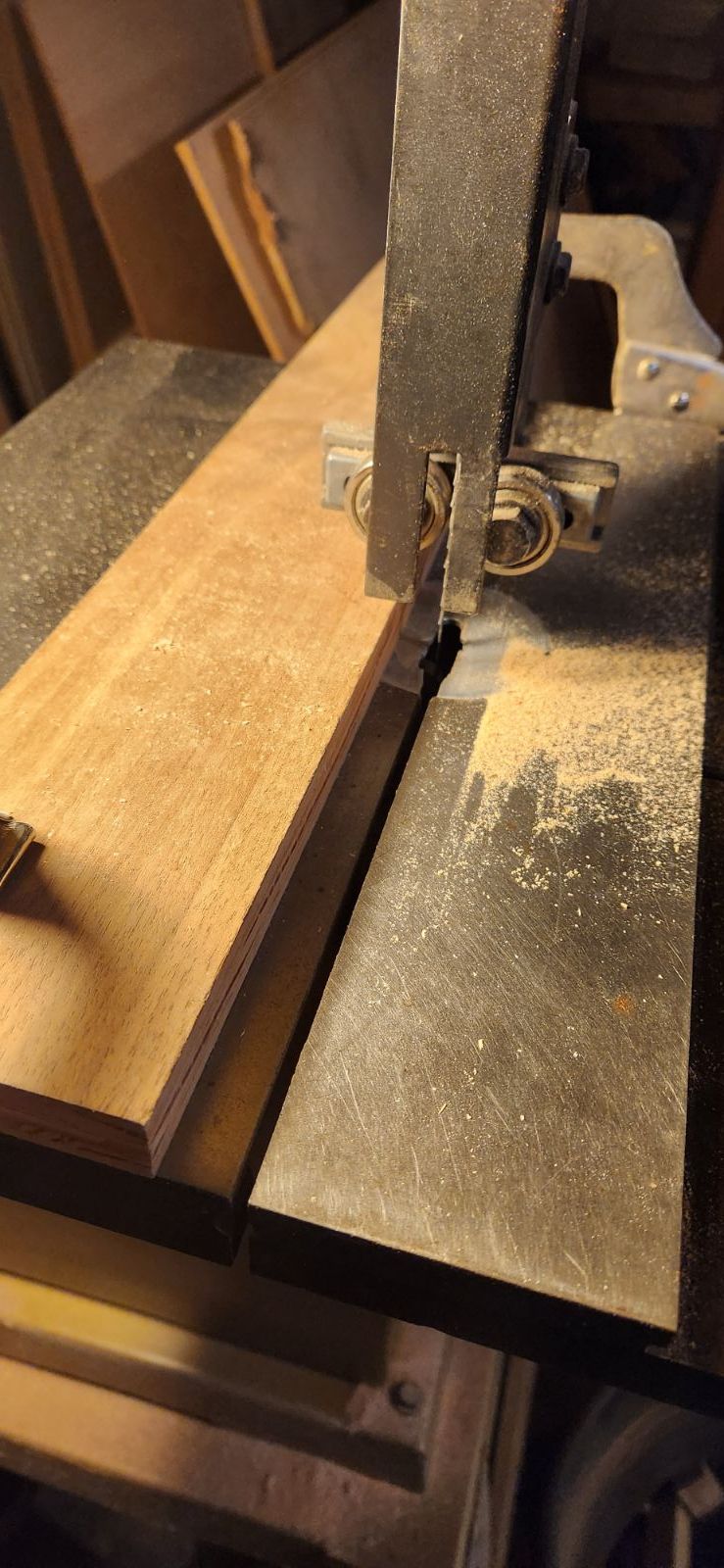

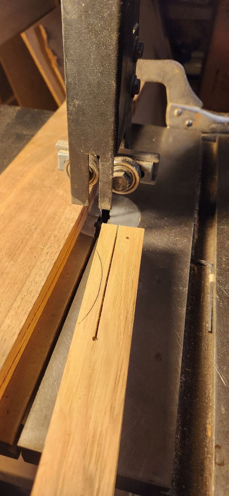

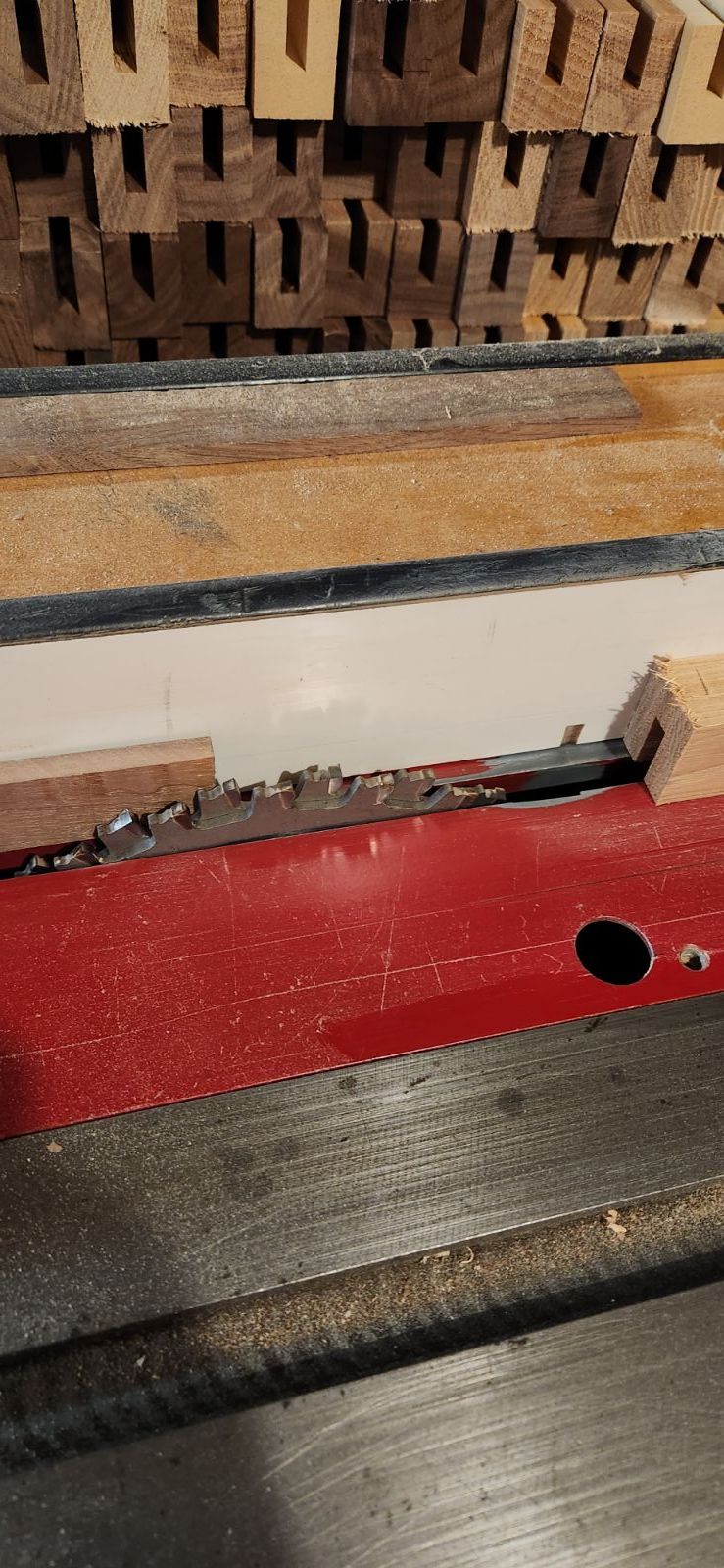

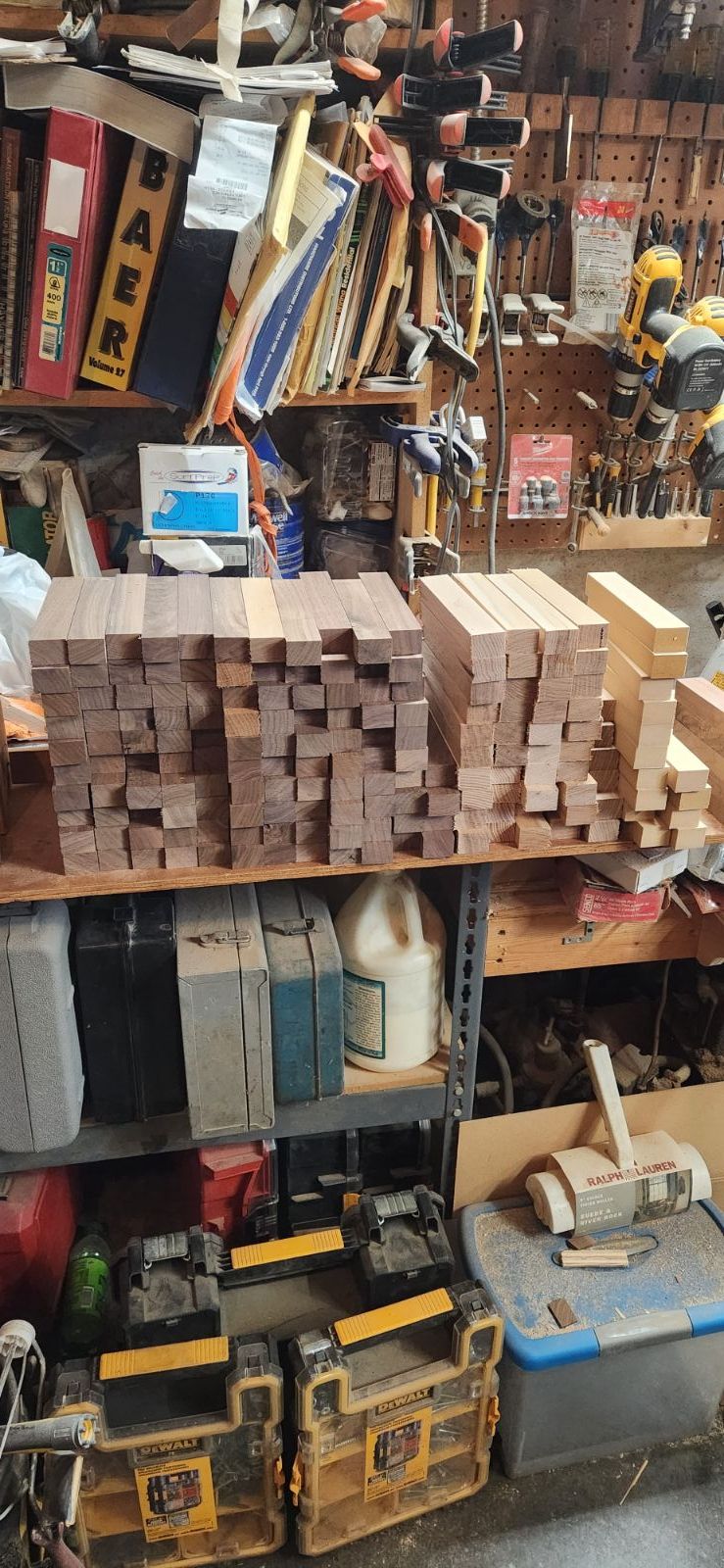

March 2, 20251 yr Author comment_352842 So tye problem was a need for many. Now the problem I’m having with Menards is the metal isn’t consistent ... I made a total of 88… Edited March 2, 20251 yr by BillyJack Report
March 3, 20251 yr comment_352974 On 3/2/2025 at 11:22 AM, BillyJack said: Now the problem I’m having with Menards is the metal isn’t consistent .. Different suppliers provided with loose tolerances. Good off-shelf project metal, but for large scale projects like yours a local metal supplier might be a solution. Report
March 3, 20251 yr Author comment_352979 I like the aluminum Menards carries and I only but a few pieces at a time. Not cheap, about $12 and I think iai get abut 8 pieces Edited March 3, 20251 yr by BillyJack Report

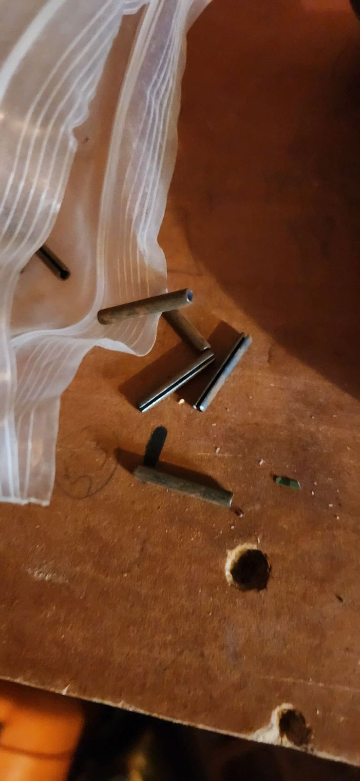

March 3, 20251 yr Author comment_352985 I got lucky and east able to get 1000 compression springs on Ebay for around $10. Report

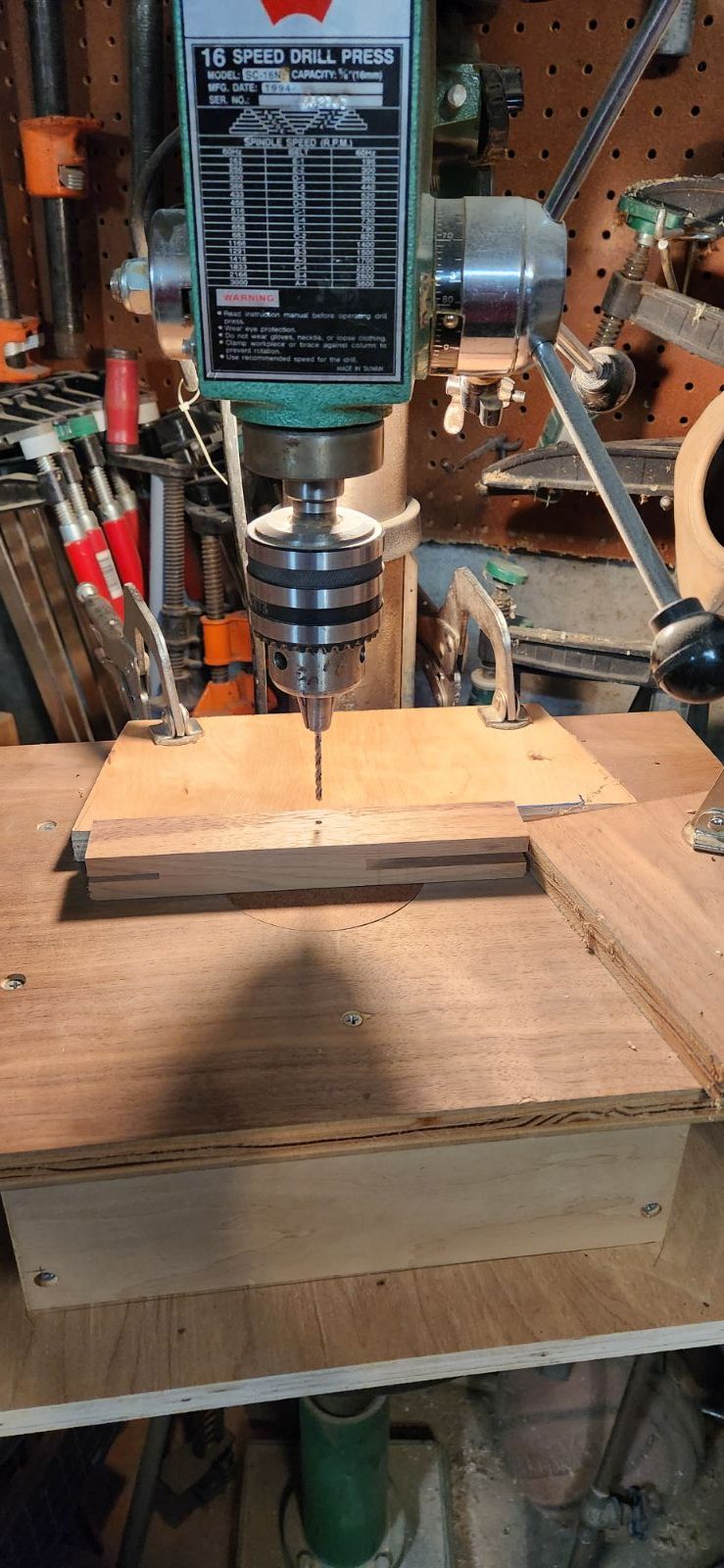

March 4, 20251 yr comment_353056 I picked up some aluminum bar from onlinemetals.com before you started this thread - just based on the pictures I saw in another post. I don't need the smashing power of Wetzlers all the time. Do you have any trouble with the steel spring pins denting the aluminum bar? Assuming there are spring pins in the sliding jaw as well as the upper fixed jaw of course. Report
March 4, 20251 yr Author comment_353068 2 hours ago, JWD said: I picked up some aluminum bar from onlinemetals.com before you started this thread - just based on the pictures I saw in another post. I don't need the smashing power of Wetzlers all the time. Do you have any trouble with the steel spring pins denting the aluminum bar? Assuming there are spring pins in the sliding jaw as well as the upper fixed jaw of course. No… just make sure you add enough room for the metal. Report
