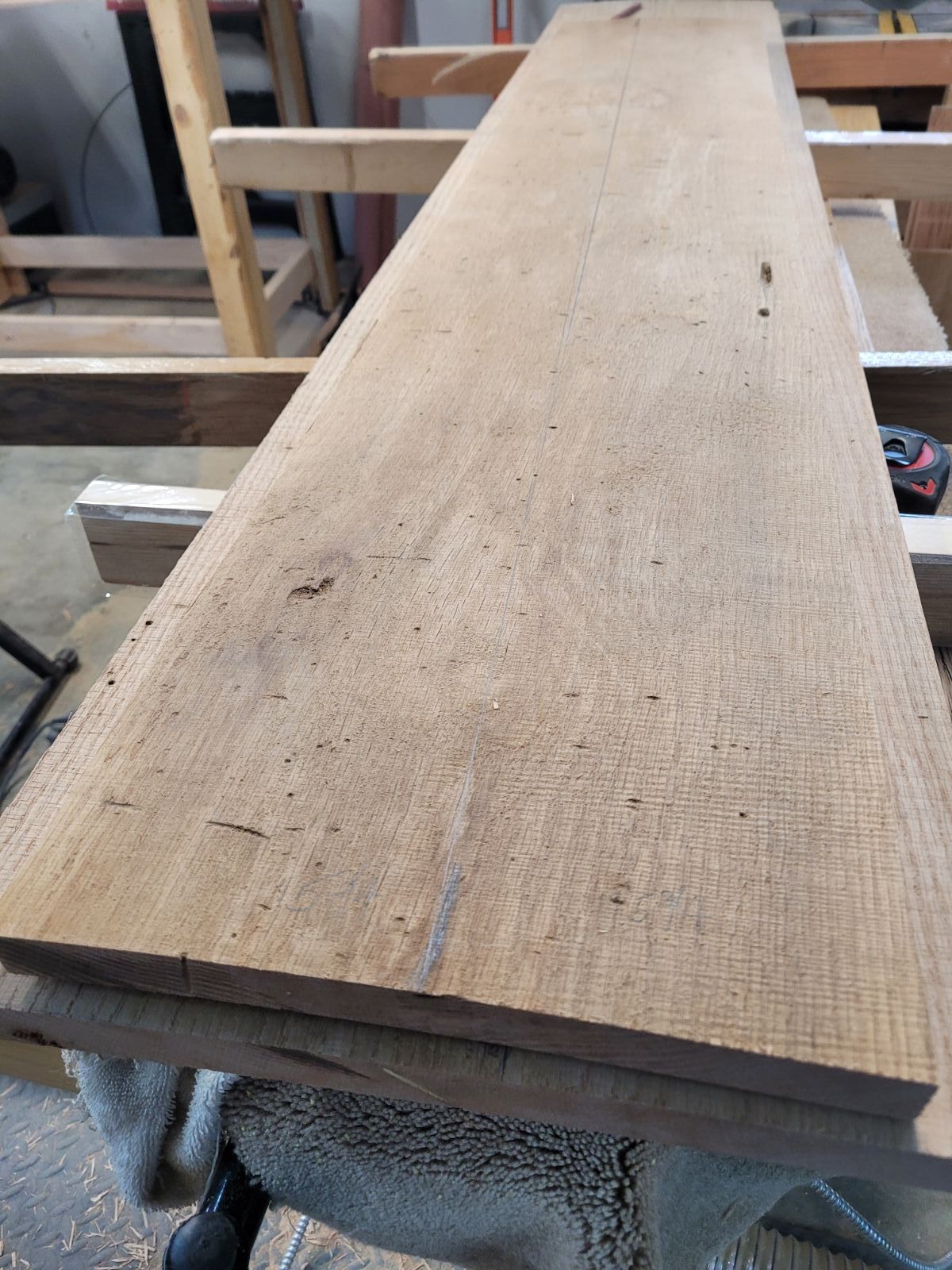

I have some long wide plain sawn boards that have cupped.
I plan to split the board along the maximum line of the cup.
Then I should have much flatter two pieces that I can join back together.
But the max line where the board is cupped the worse run in a diagonal sort of.
So I drew the line and will spilt on my BS when I get the new tires installed.
Then I will joint that BS edge and then see where we are.
Hopefully after rejoining I can glue them back together along that jointed line and will that result is a flater board?

Posted

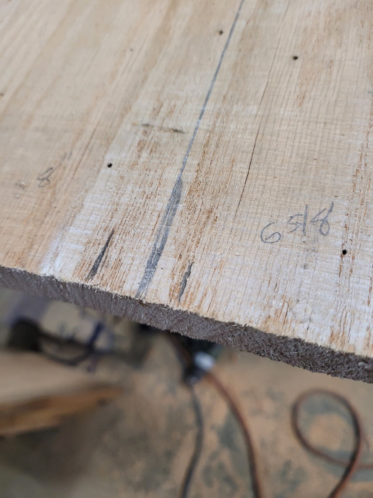

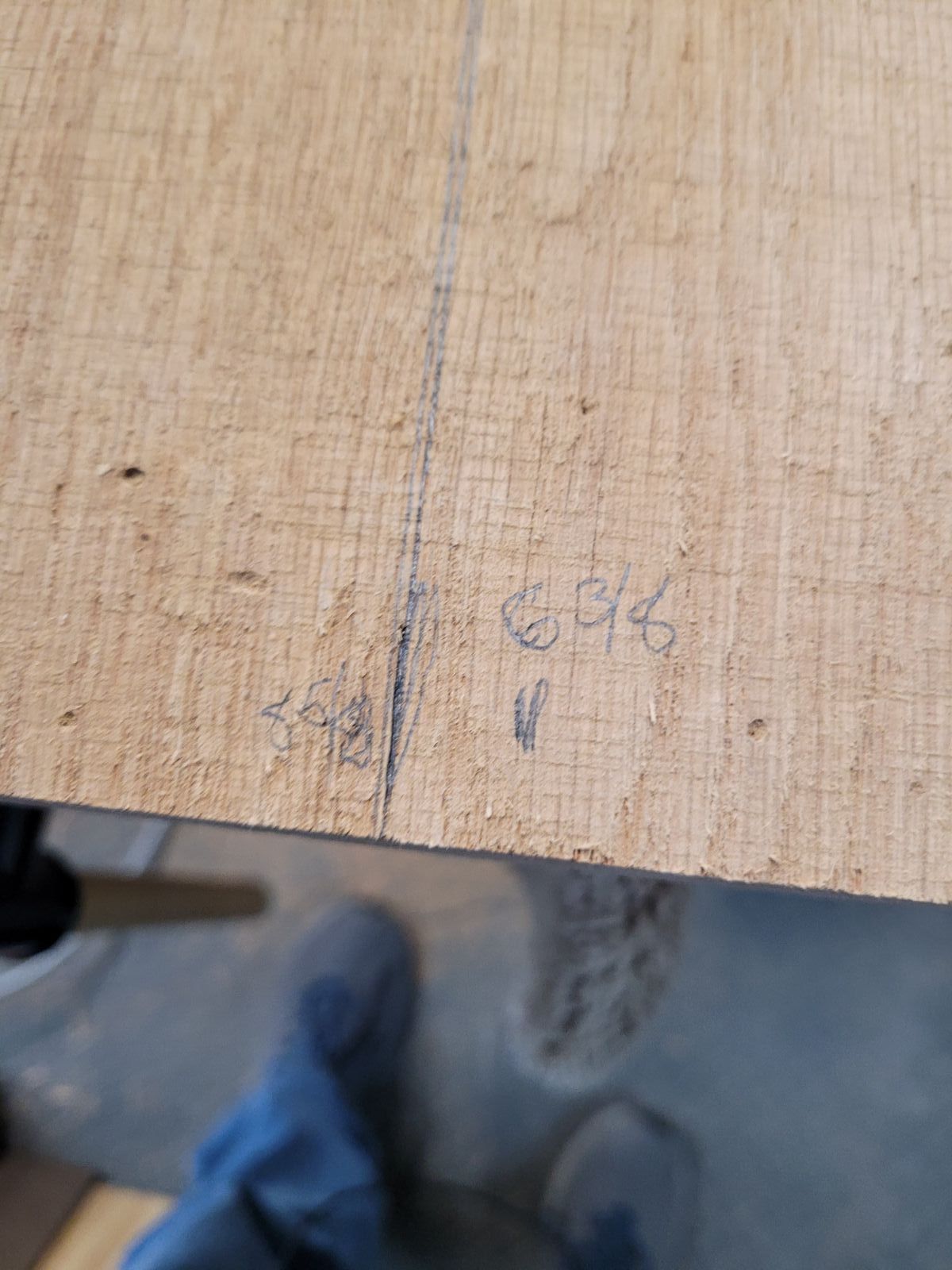

Pictures
The bottom board high spot is 6 -5/8 one end and 6-3/8 from the opposite side on the opposite end.
Top board is closer but still high spot on ends is offset by 2"
Total wrap in the board 1/2" bottom and 3/8" top.
If these were 2x boards I may just joint and TP them.
But as they  are 1x boards I need to be conscience but my Jointer is only 8"  Where my TP is 15"
So even when flat I split them then joint the back together.
