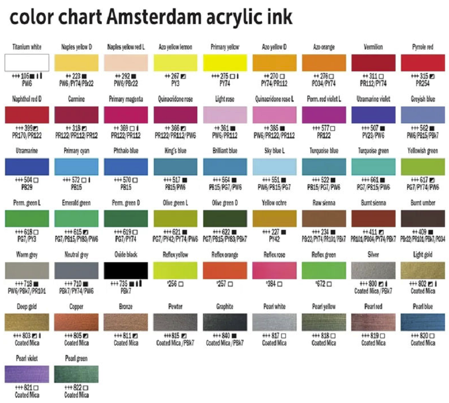

October 21, 20242 yr comment_344745 Those are super, Dan! What did you use to do the red on the bases? Report
October 21, 20242 yr Author Popular Post comment_344751 I use acrylic ink. It acts like a stain. I brush it on, it soaks in and leaves no brush marks. The yellow flames were done with acrylic ink too. There are many colors to choose from. Once the color is on I finish them with poly for the shine. I get it sent from Walmart but the hobby stores have it too. It's Amsterdam #315 Pyrrole Red. Picture just for reference. It goes a long way just like stain. Edited October 21, 20242 yr by HandyDan Report
October 21, 20242 yr comment_344752 5 minutes ago, HandyDan said: I use acrylic ink. It acts like a stain. I brush it on, it soaks in and leaves no brush marks. The yellow flames were done with acrylic ink too. There are many colors to choose from. Once the color is on I finish them with poly for the shine. I get it sent from Walmart but the hobby stores have it too. It's Amsterdam #315 Pyrrole Red. Picture just for reference. It goes a long way just like stain. Thanks! I really like the depth of color! Report
October 21, 20242 yr Author comment_344756 2 hours ago, lew said: Thanks! I really like the depth of color! I"m amazed every time I use it. Report
