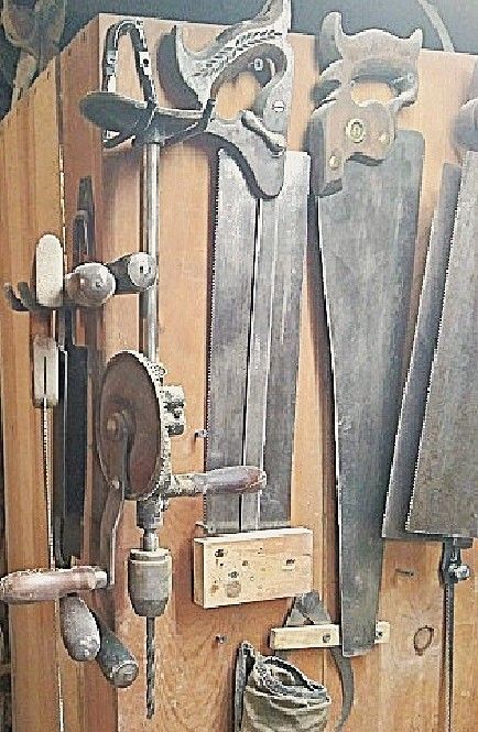

February 1, 20251 yr Popular Post comment_351063 Hmmmm Just hanging...(L-R) No. 10 Atkins, Disston D8 Panel saw...and 3 backsaws...the skinny Jackson is hiding behind the 2 Disston No. 4s...one rip and the one behind is a crosscut... Kind of a busy space...Canvas roll is a full set of Irwin Bits ( #4-#16) Report
