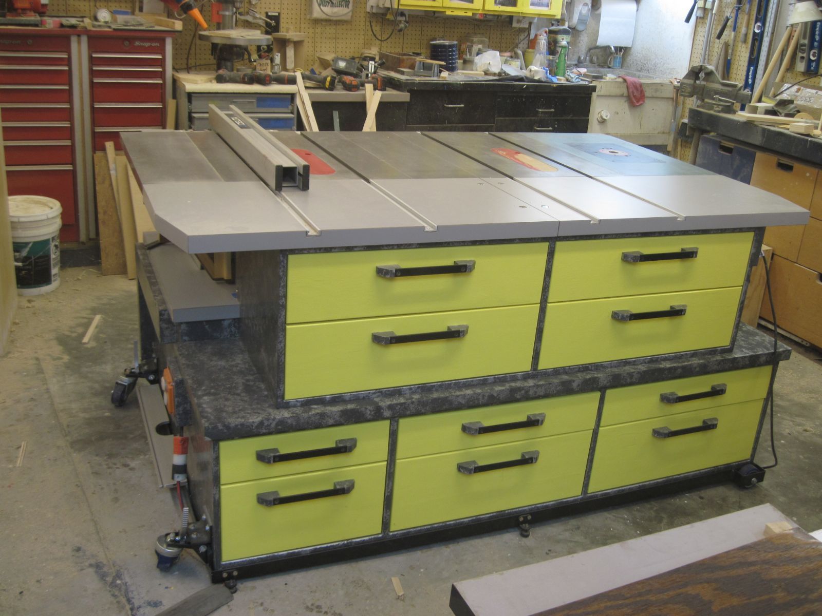

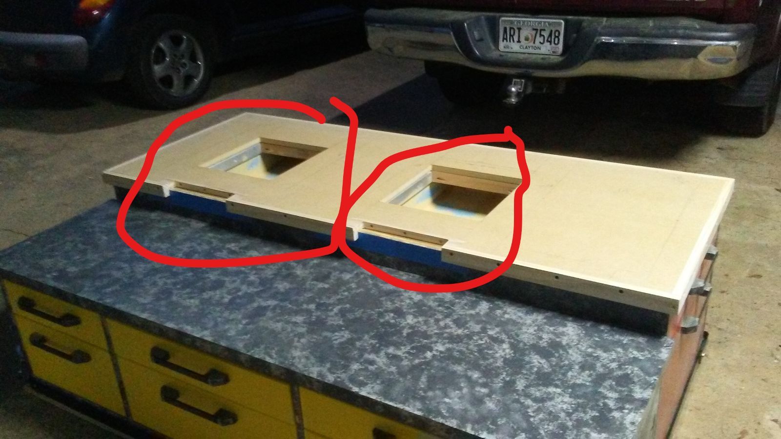

October 1, 20242 yr comment_343304 Ignore the red circles, they were different application. Do notice the edges of the top before Formica was added. I prefer to not try and glue to edged plywood or MDF but use poplar instead. Better bond with the glue in my opinion. This picture was preparing the dust collection ports for my table saws before mounting. Report
