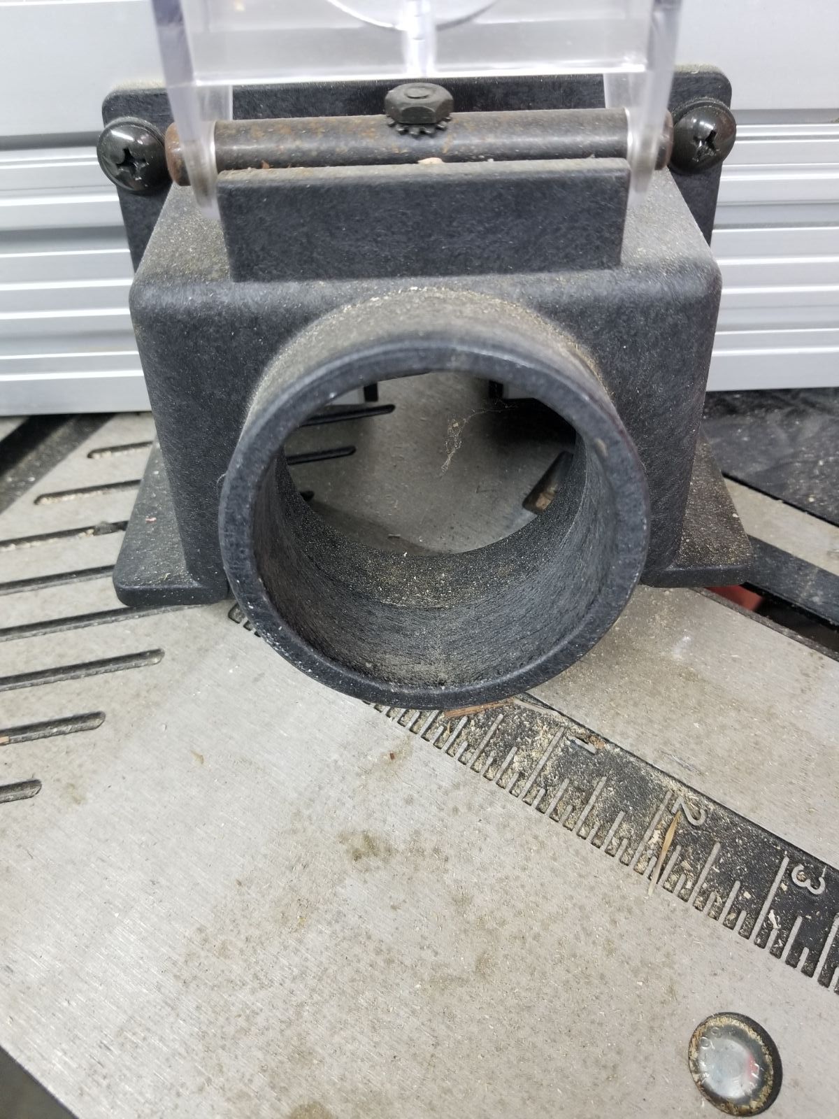

September 4, 20242 yr comment_341683 I'm trying to get all of my machines to connect to my DC system, using fittings I already have. For my router table, I have a fitting that's probably within 1/32" of sliding onto the fence port. The fence port is plenty thick and should give me enough room to shave it down without worry. The question is, how do I shave it down evenly in a consistent manner? The other option is to shave down the inside of the fitting itself. Anyone have any ideas about how to go about doing this? Router table port: Fitting: Report

September 4, 20242 yr comment_341688 Maybe you could put a sanding drum in your drill press and ream out the fitting in the first picture. Report
September 4, 20242 yr comment_341692 If it’s a 1/32 or less any chance of heating the fitting then forcing it on to reshape it? Report
September 4, 20242 yr comment_341693 My 2 cents Depends on which way the air flows. I would think you would want the machine fitting into the vacuum hose so that no debris builds up on the junction of the 2 pieces. If the machine connection is larger than the vacuum hose, and you have the excess material on the machine end, then some abrasive paper used like a "shoe shine" would/should take the plastic down to a reasonable fit. If you want it the other way then an abrasive paper glued to the perimeter of something close to the size of the hole. chuck it into a drill and go at it Similar to a flap wheel?? Edited September 4, 20242 yr by smitty10101 Report
September 9, 20242 yr comment_342044 Looks like a plastic part so this should be easy. If I were to modify the port, I would do so with a fairly aggressive bastard file. My usual go to with vacuum fittings is the plumbing isle of Home Depot, looking for those rubber + hose clamp adapters we used to call "the slumlord special" when I was doing remodeling work. I use these a lot going from sanders, chop saws, etc to a shop vac. With all the different pipe spec's out there, there are a lot of ID options on the rubber adapters, the tricky bit is finding a place that has a large variety (my local hardware store is actually very good for this). Report
September 9, 20242 yr Popular Post comment_342046 I have used a heat gun to soften up a PVC pipe or fitting end then you can stretch it over something that is a little larger. I have done this several times on dust ports. Report
September 9, 20242 yr Author Popular Post comment_342059 Thanks for the suggestions everyone. I ultimately decided to go the labor intensive route. I used plumbing sandpaper and slowly sanded down the port. It was time consuming, but it worked. Report
