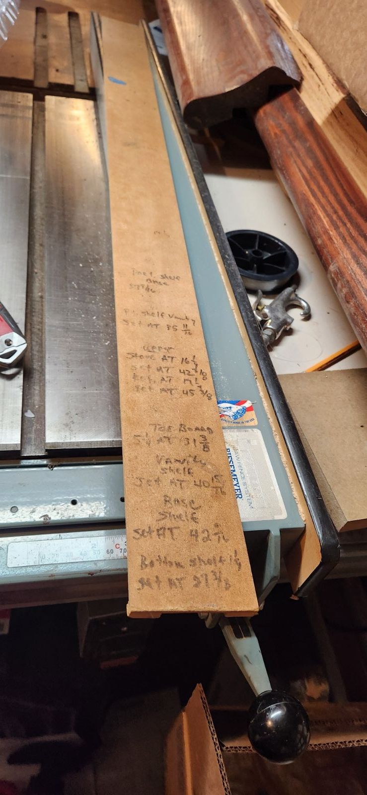

June 5, 20242 yr Popular Post comment_336767 The book that I learned a lot of cabinetmaking from used story sticks for overall dimensions a lot. Ran across this today Report

February 24, 20251 yr comment_352454 Here is my story stick. This works in cabinetry and most of commercial. Chairs is the few places a story stick or pattern would be a plus,but how many are making chairs these days one by one.. Edited February 24, 20251 yr by BillyJack Report
