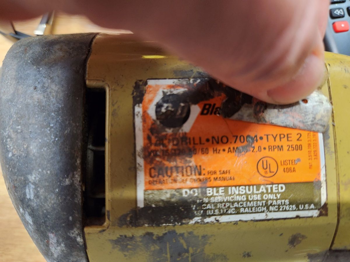

May 31, 20242 yr comment_336370 Wasn't sure where to post this but looks like a good spot. This came into my possession recently. I plugged her in, she seems to run no problem...wow she's loud curious if anyone has a rough estimate on age? Thanks, -Aaron Report
May 31, 20242 yr Popular Post comment_336373 Not sure of it's age but, I had one like it in the late 70s. Report
May 31, 20242 yr Popular Post comment_336378 Any model number and/or type # on it Aaron? B&D made similar versions of these through the late 60's to the early 80's like this one. Model #'s were either the same or slightly different depending on 1/4" or 3/8" chuck capacity as well if variable speed or variable speed/ reversible. Type #'s changed as model was slightly altered from start of model production to end. Yours appears to be a 1/4", single speed (although B&D made some 2 speed versions too), non-reversible unless it has a forward/ reverse switch in the rear of the handle? Early model of the double-insulated (non-grounding plug) Noise is probably gear noise. The grease they used would get hard over time and "glob" away from the gears. When I recondition one like this or some of their similar versions, always have to dig the old grease out (it usually stinks to high heaven too), clean the gears, shaft and gear housing with mineral spirits or electric motor spray cleaner, then repack using a quality high pressure and temperature rated wheel bearing grease. Also can be noisy depending if spindle shaft bearing is a ball bearing. Same issue as the gears. The ones with a bronze bushing vs ball bearing are noisy regardless. Sometimes a few drops of machine oil (10W) will help make it somewhat more quiet. Report
May 31, 20242 yr Author Popular Post comment_336379 4 minutes ago, Grandpadave52 said: Any model number and/or type # on it Aaron? B&D made similar versions of these through the late 60's to the early 80's like this one. Model #'s were either the same or slightly different depending on 1/4" or 3/8" chuck capacity as well if variable speed or variable speed/ reversible. Type #'s changed as model was slightly altered from start of model production to end. Yours appears to be a 1/4", single speed (although B&D made some 2 speed versions too), non-reversible unless it has a forward/ reverse switch in the rear of the handle? Early model of the double-insulated (non-grounding plug) Noise is probably gear noise. The grease they used would get hard over time and "glob" away from the gears. When I recondition one like this or some of their similar versions, always have to dig the old grease out (it usually stinks to high heaven too), clean the gears, shaft and gear housing with mineral spirits or electric motor spray cleaner, then repack using a quality high pressure and temperature rated wheel bearing grease. Also can be noisy depending if spindle shaft bearing is a ball bearing. Same issue as the gears. The ones with a bronze bushing vs ball bearing are noisy regardless. Sometimes a few drops of machine oil (10W) will help make it somewhat more quiet. I'll check tomorrow for any model #'s or other info I can find on it. Report
May 31, 20242 yr Author comment_336408 # appears to be 7004. I lifted the seal up on the label a little, the label is still in good shape. There is also a switch on the front. I haven't tried it out yet to see what it does. Report

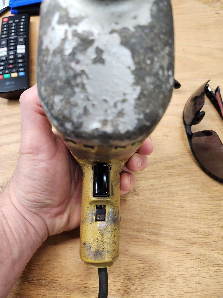

May 31, 20242 yr Author comment_336415 51 minutes ago, Fred W. Hargis Jr said: That's the reverse, I would think. Button doesn't appear to stay put when I push it up but yeah it probably is. Report
May 31, 20242 yr Popular Post comment_336416 Might be the trigger switch lock to lock the drill in operation so you don't have to hold the switch down. Good for wire brush or sanding disc operations. To use, depress the drill switch, hold, slide the lock button up, release drill switch. To disengage, fully depress the switch; locking button should release. B&D 7004 Type 2 Nov. 76 Manual----> HERE Report
May 31, 20242 yr Author comment_336417 9 minutes ago, Grandpadave52 said: Might be the trigger switch lock to lock the drill in operation so you don't have to hold the switch down. Good for wire brush or sanding disc operations. To use, depress the drill switch, hold, slide the lock button up, release drill switch. To disengage, fully depress the switch; locking button should release. B&D 7004 Type 2 Nov. 76 Manual----> HERE Report
