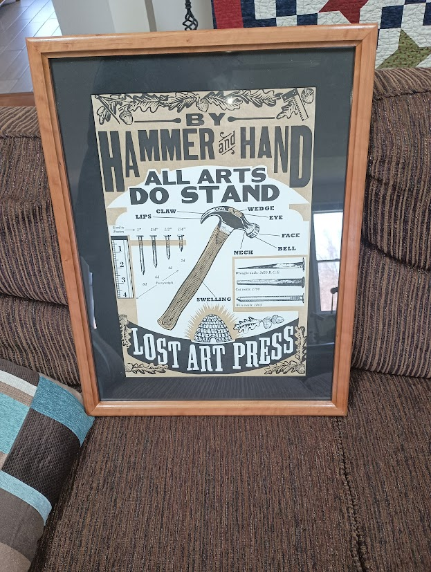

March 20, 20242 yr Popular Post comment_332145 Maybe 30 some years ago, when I first got access to the internet, I chose ByHammerAndHand as an email address. Later, I used it as my company name and web site. It was a logo of old British guilds for joiners and cabinetmakers, or maybe blacksmiths, according to some. For Christmas, I got the poster back in stock at LAP and just got it framed. Report

March 21, 20242 yr Author Popular Post comment_332200 Just a few points about picture framing. I took a class in framing from a master in 1997 or so. I ended up buying a framing vise, a mat cutter, an ATG gun, and a few little tools. I concluded that they paid for themselves with the first 3 or 4 framings that I did. He taught us to put nails in the corner from both directions. I still do that as insurance against glue failures. While I have used very few premade frame stock, almost all of them I made from lumber. This one is curly cherry. The biggest I ever made were for an artist and a series of $10-30K paintings. They ranged from about 3x5 to 5x7 feet, compound miters on the corners with added decoration. I painted them red and once he got the paintings in, had the painting motifs flow into the frame. After the class I bought a box of 144 sawtooth hangers and some braided wire and D-rings for larger ones. I've already gone thru the box of hangers, so I guess I'm approaching about 200 frames. Oh, and I also wrote a DIY article on framing for an artists' magazine Report

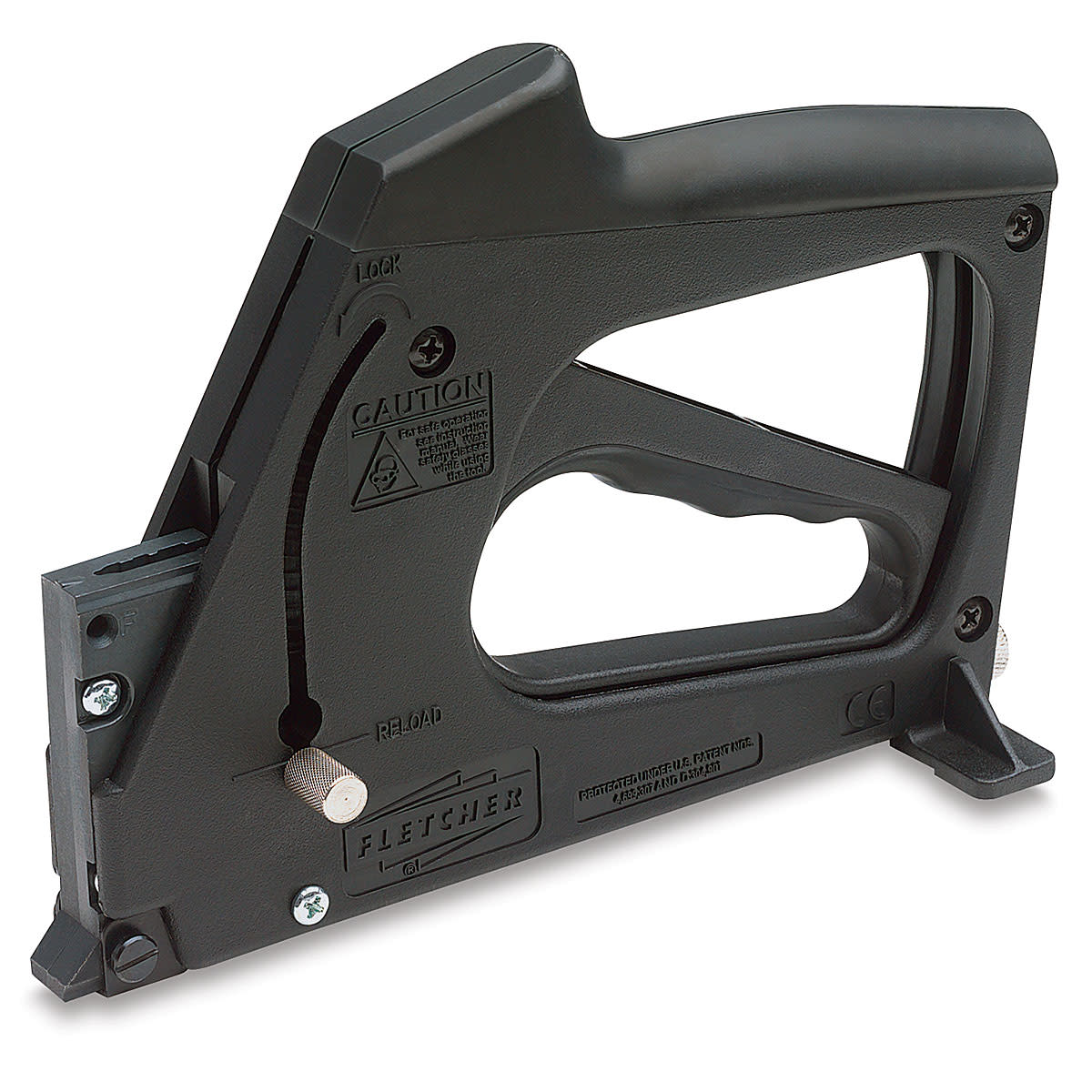

March 21, 20242 yr Author Popular Post comment_332204 Oh, and I got a point driver. I can insert the points to hold in the mat in just a few seconds. I also bought some "glaziers points" (shorter ones), that I've used to do mirror and glass repairs. Report

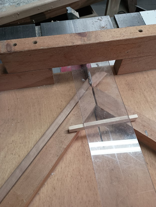

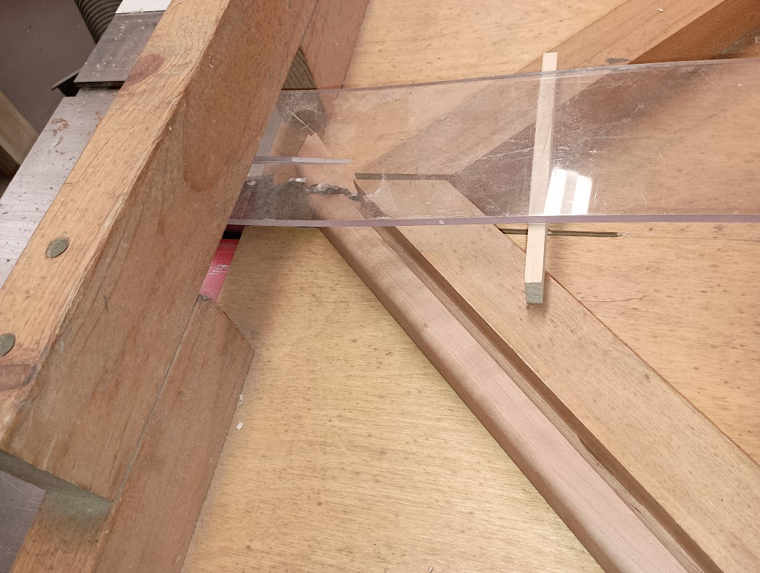

March 22, 20242 yr Author comment_332258 2 hours ago, Cal said: I'm curious @kmealy on what your saw set up is that you use for picture frames? I much prefer sliding tables over miter gauges. I can pretty much tell where the cut will be based on the kerf in the base. I rarely use a stop block on this miter jig because I like to have the grain flow around the corner, so I'm cutting long-short-long-short. When I am done cutting the second piece I stack them back to back and trim the longer one when needed. (This also helps the 1/8" allowance), Report
