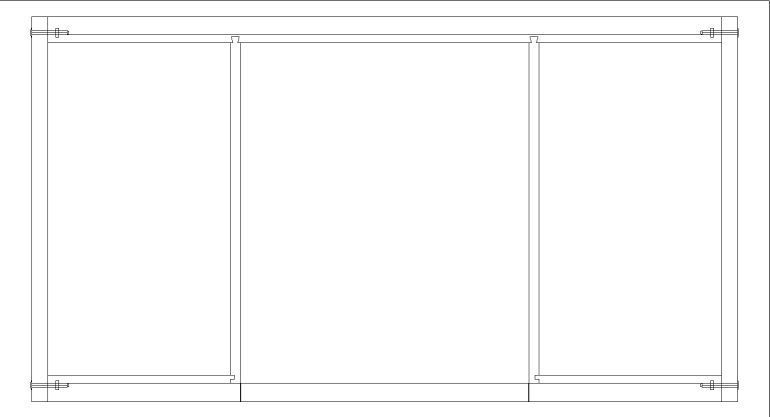

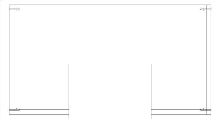

Sorry about not posting progress with the desk design.  Latest thoughts are to modify the side boards with slots to trap the bottom and top boards of the desk top.  Figured if the side were bolted in place then all the parts should be trapped when the sides are attached.  Simplify assembly by eliminating any need to glue up the desk top parts.  Challenging part is the front side of the desk,  It is broken into three parts so the center section can be a drawer front.  The back board of the desk top is one continuous piece. Both ends bolt to the sides.  Bolting to the two side sections of the front I need to figure out how to trap their inner end.  I'll see if I can post a drawing that shows the challenge.

Center open area is where a drawer will slide in. There will be sides for drawer slides between the back and front frame.  Those pieces would be trapped if the front side was continuous, but obviously the front side ends are only attached at one end. I thought about pinning through the top 1/2" ply and bottom 1/4" ply and trap the inner ends, but that isn't a knock-down solution.  A spring loaded connection of some sort might do but I haven't envisioned how it would be implemented yet. Pull the drawer out to reveal a push button or lever that releases the inner drawer frame?  Something like that.  Such is how my mind works.
4D
One option, and likely the final option, is to dovetail the drawer slide support rail into the back piece, and notch into it with the front frame piece.  Mount the drawer slides to this piece, and when the drawer is inserted it will keep the parts hooked together at the front.
4D
For that rear dovetail connection I can use my CNC to make it slightly taper down from the top for easy insertion and removal. Once in place with the bottom and top panels in place it can't come out. The top and bottom panels will have rabbeted edges that tuck into the perimeter frame and will be trapped in place once the ends are screwed on to the front and back frame parts. So that they are easy to slide in but are snug when inserted I can also put a slight taper on the slots and the rabbeted perimeter.  Just a couple of degrees.
The front joint also needs to be a reliable knock-down version that won't wear down coming apart repeatedly.   Not that I imagine this desk body being take apart frequently, but just to be sure if it is it'll always go together as "perfectly" as it does the first time I assemble it.  Still thinking about how to make it a snug fit but easily come out and go back in snug.
