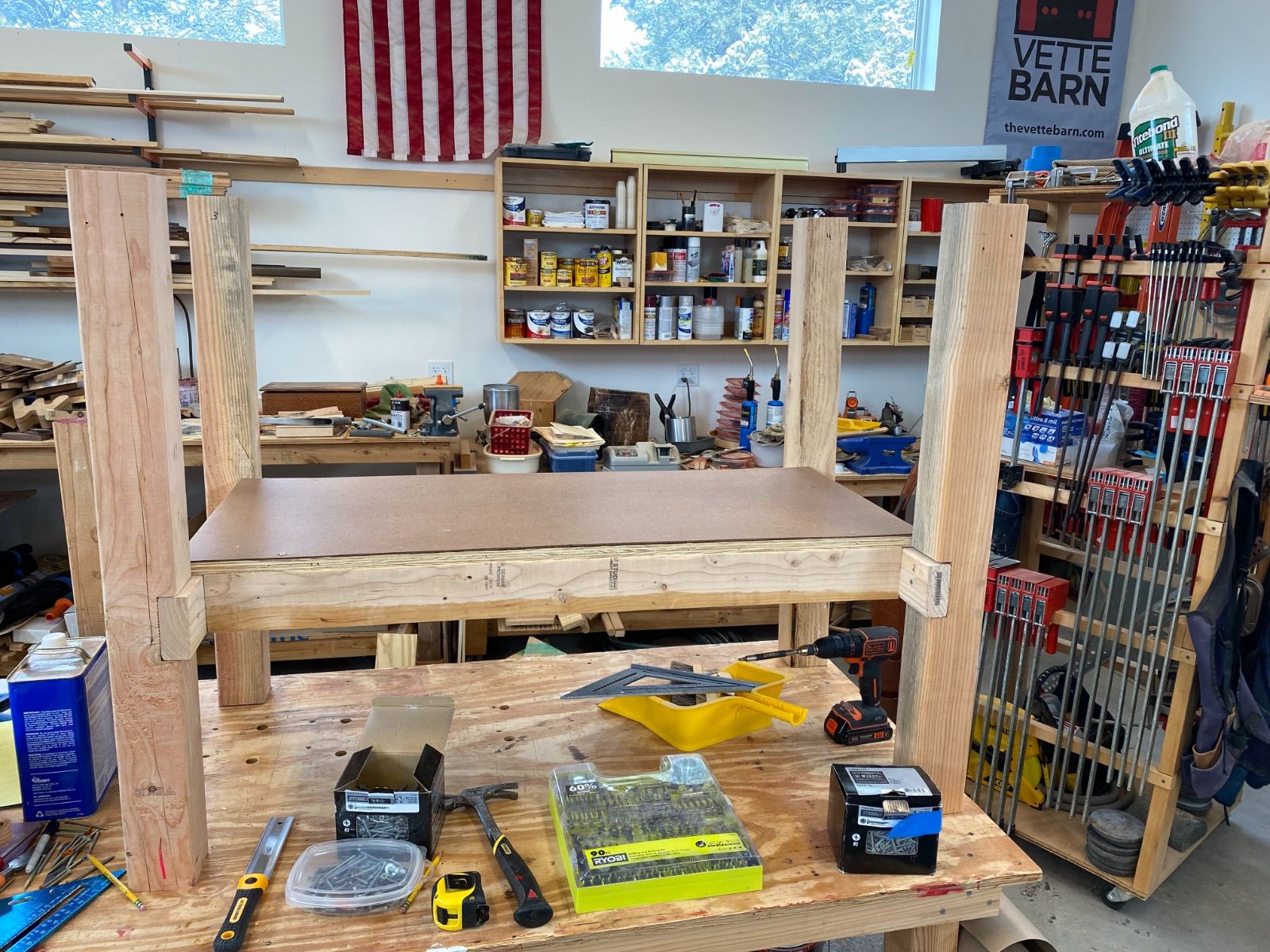

Popular Post DAB Posted January 2, 2024 Popular Post Report Posted January 2, 2024 shooting buddy asked for some help, got me some basic dimensions (has to fit in a certain spot in a smaller apt), and so i went shopping and cutting today. top done, then attach some legs. still need to make a lower shelf as well as a set of upper, shallow shelves. that's for another day. it's already pretty heavy, so i'll take the legs back off for delivery, and also detach the lower shelf from the legs. screw gun is all you need to put it back together. Headhunter, Fred W. Hargis Jr, Cal and 3 others 6 Quote
lew Posted January 2, 2024 Report Posted January 2, 2024 Looks real sturdy. Grandpadave52 and Cal 2 Quote
DAB Posted January 2, 2024 Author Report Posted January 2, 2024 6 minutes ago, lew said: Looks real sturdy. it is. based on my shop work tables, which i have a lot of experience with, but the front piece is a 4x4, with notches for the legs to fit into. the user wants to mount a single stage reloading press, so need a 4x4 to mount that to. have experience with that as well on my own reloading bench. top is double thickness 3/4 ply, with 1/8" hardboard to finish it off (just loose for now). Headhunter, Grandpadave52 and Cal 3 Quote
lew Posted January 2, 2024 Report Posted January 2, 2024 Hardboard "veneer" makes cleanup easy. Cal, DAB and Grandpadave52 3 Quote
Grandpadave52 Posted January 3, 2024 Report Posted January 3, 2024 Should serve the purpose quite well and be robust enough for a reloading press. Easier to build than move. Hope there's a service elevator unless it's a 1st floor unit. Even then, I wouldn't be much help moving it far. I struggle moving 1/2 sheet of 3/4" ply. Cal 1 Quote

Popular Post DAB Posted January 4, 2024 Author Popular Post Report Posted January 4, 2024 top removed temporarily, bottom shelf figured out. will remove legs for transport. Headhunter, Cal, Gerald and 2 others 5 Quote
Popular Post DAB Posted January 7, 2024 Author Popular Post Report Posted January 7, 2024 Delivered and in use. Gerald, HARO50, lew and 7 others 10 Quote
Grandpadave52 Posted January 7, 2024 Report Posted January 7, 2024 WOW that didn't take long. Fits like a glove too. Artie, Cal and HARO50 3 Quote
Gerald Posted January 7, 2024 Report Posted January 7, 2024 Great look and nice to have a window where you work Cal, Grandpadave52 and HARO50 3 Quote
DAB Posted January 7, 2024 Author Report Posted January 7, 2024 did a little math this morning, at 55 pounds/cubic foot for dry pine, this bench should weigh about 215 pounds before you start putting things on it. it's not going anywhere. HARO50, Cal and Grandpadave52 3 Quote
