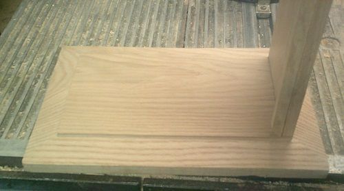

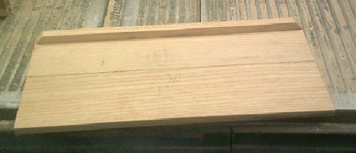

Base:  once I had bevel the 4 sides...
There was a problem...sides were a bit too broad in the beam....but...I kept the edges I ripped off..to make "slips"
Slips will help hold the face panel in place...( with a bead or 2 of glue :ph34r: )

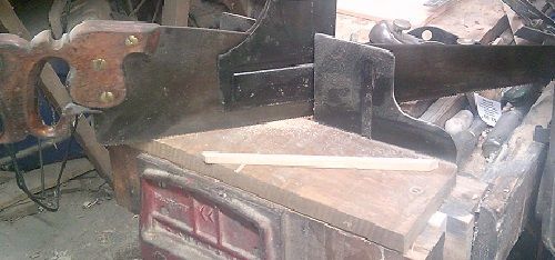

But..they needed a mitered corner to look better...so..
The big Langdons can't do small parts like this but this Millers Falls will do just fine..
Mitre Box is held in the vise by..
This piece of scrap, screwed to the bed with counter sunk screws,,,saw is a Disston D8, 20" Panel saw, 10 ppi :OldManSmiley:
Test for fit..:TwoThumbsUp:

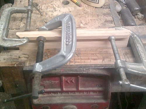

Then a bead of glue, and some clamps..and let sit a day..:Cheer:
Someone complained about c clamps having no place in a wood shop.:ArguingSmileys:.so..
Needed one slip per side...on the inside face...These are the sides of the case...the "picture Framed"

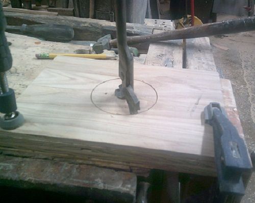

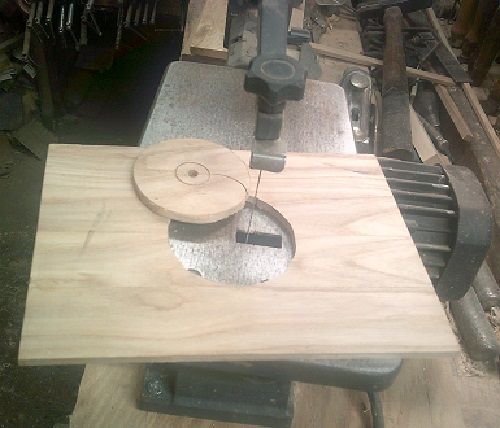

Clock needed a way to drill a 3" diameter hole...I thought I had a way...:PullingHair:
With this thing...it did score a line, 3" in diameter...but..FAILED to cut any deeper..:ArguingSmileys:..so..today..
The Craftsman 13", Tilting Table, Direct Drive Scroll saw came off the shelf...uses a pinned 5" blade.  :OldManSmiley:

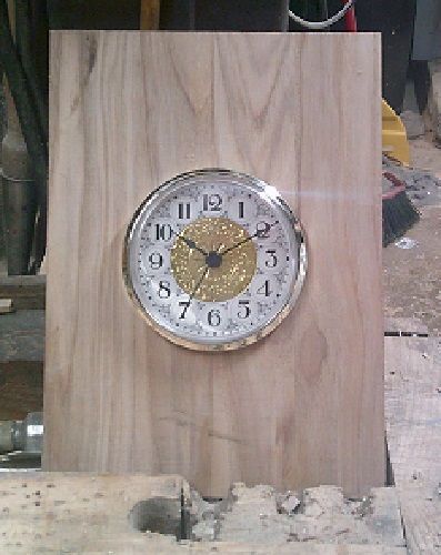

Had to test fit the clock to this hole....either it won't fit...or it will just snap into place,  or..just fall back out...:WonderScratch:
And...we have a "Snap Fit"!:TwoThumbsUp:

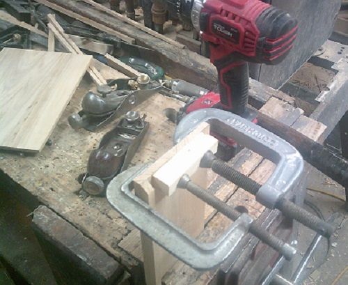

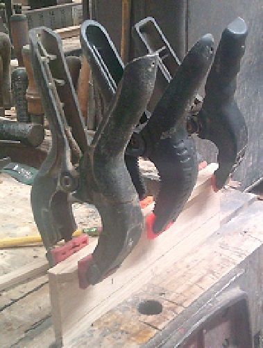

After that task..I needed 2 things done.:Cheer:..first..I needed 4 glue blocks, cut to size, sanded square around and the counter sink a pilot hole...THEN glue each one in place..:SaluteandRun:

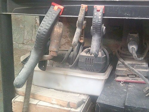

Was nice having these spring clamps, but, after using these 4...:JawDrop:
This was all there was left..back to the c clamps...:SaluteandRun:
That "gap"?   that is where the  face panel will go...and it be a tight fit, too...let the 2 sides sit a spell..as the other item to do...was replace the camera's battery with a new, freshly charged one...:PullingHair:as the "old" one had died..:ArguingSmileys:
later, once the battery was ready..decided on a dry fit of sorts...l already had the clock fitted to the face panel...so..I brought out the base, and both of the sides and the lid, with the finial to set on top:TwoThumbsUp:

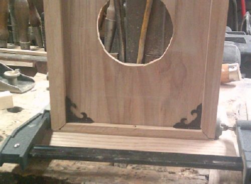

Added the face plate ( without the clock)

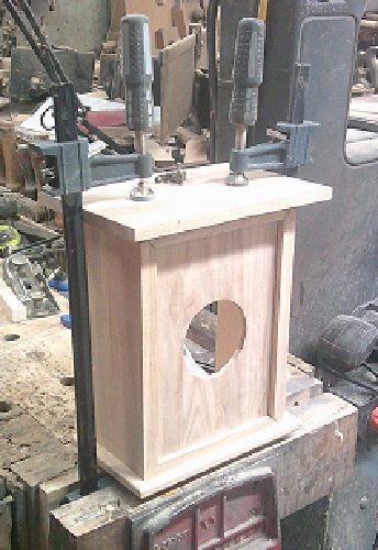

Bead of glue along 3 edges, add a couple clamps and let sit a spell....
Came back, and fitted the top slip and glued it in place with the spring clamps..

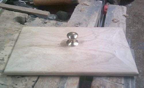

Then worked on the Top for a wee bit...block planes to slightly bevel the edges top and bottom...then sand the bevels smooth..into a slight round over..
Drilled a counter sunk hole from the underside, and installed the "Finial"

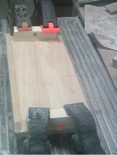

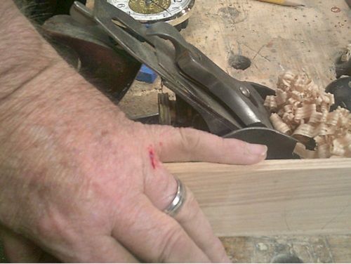

door has become a back panel...will get screwed in place....can be removed IF need be...However, the back's panel needed a bit of work done..

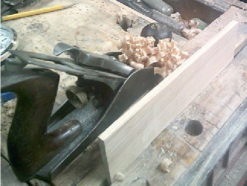

Usual grip for the left hand...thumb gets hooked on the side of the plane by the handle/knob....fingers are curled under the plane's sole to act as a fence when doing Jointer work....I was planing along nicely enough, but got in a hurry...that's when bad things happen...
I pulled back a little too far...and..them corners are SHARP...

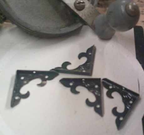

These will need a few holes drilled first..
Stay tuned...
Tuesday's Shop time?:ChinScratch:

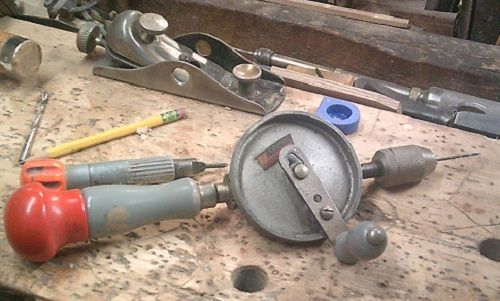

Holes have been drilled...high tech drill, too..:TwoThumbsUp:
First drill...second drill was similar, but had a smaller bit than this 1/16" bit...:ChinScratch:
Needed 12 holes drilled...:Cheer:

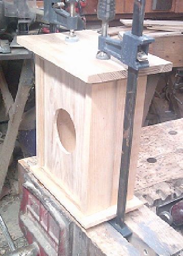

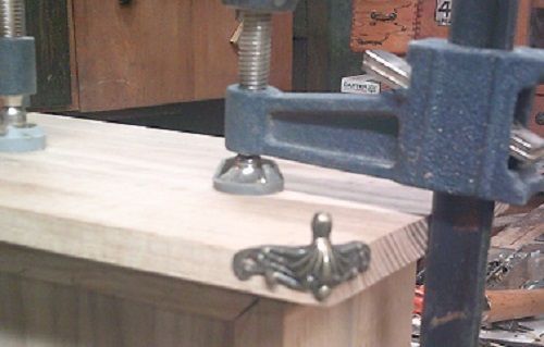

Case was glued to the top...top is in the vise, BTW..:OldManSmiley:
Vise holds the clamps...hammer to assist in lining things up...:MachineGun:
This way, it will be easier to install these...:OldManSmiley:
4 screws per foot...then I can add the corner trim pieces...but.. I needed to let this sit a day, and let the glue cure...:Tapping:

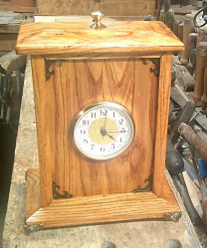

So...today?

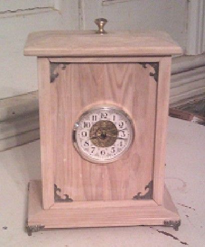

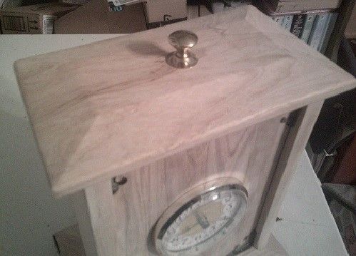

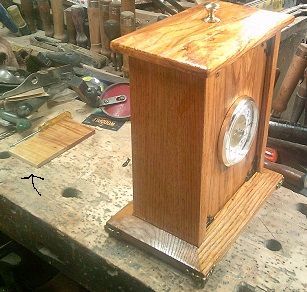

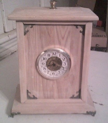

How about a PIP? :ChinScratch:   No stain or finish...yet:Tapping:
And, while trimming one of the corners at the slips..chisel hopped up and sent a sharp corner into my left index finger..more DNA..

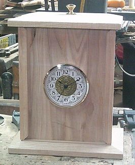

So..clock has been slipped back into place, and is Keeping time nicely..

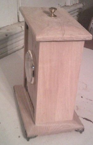

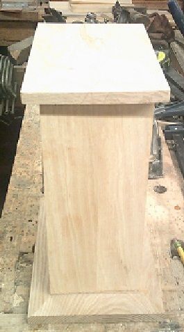

Details of the side?

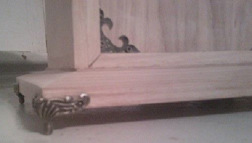

Feet details..
And...they do sit level...4 screws see to that..
Back panel, held in place with just 4 screws..
A view from the Top...
Tomorrow, I need to go to Lowes for a couple brushes...one for the stain, one for the Amber Shellac...and maybe a couple more for a coat of varnish?
Not too bad of a Project?

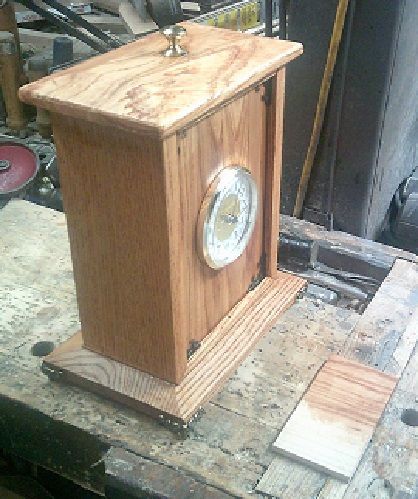

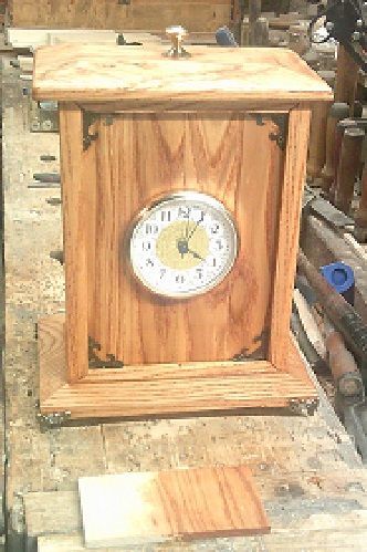

Roh Kay, Raggy...I used a blank of the same wood to check on the colour of the Witch's Brew Stain...and..:JawDrop:
Brushed on, and wiped down:SaluteandRun:
Was hoping the grain details would pop a bit better...:WonderScratch:
All wiped down and dry...Try the Amber shellac?:Cheer:
Same Test strip..both bare wood and stained..:OldManSmiley:
10 minute finish job?  :KooKooClock: Will rub this down in the morning, and go from there...:ChinScratch:
