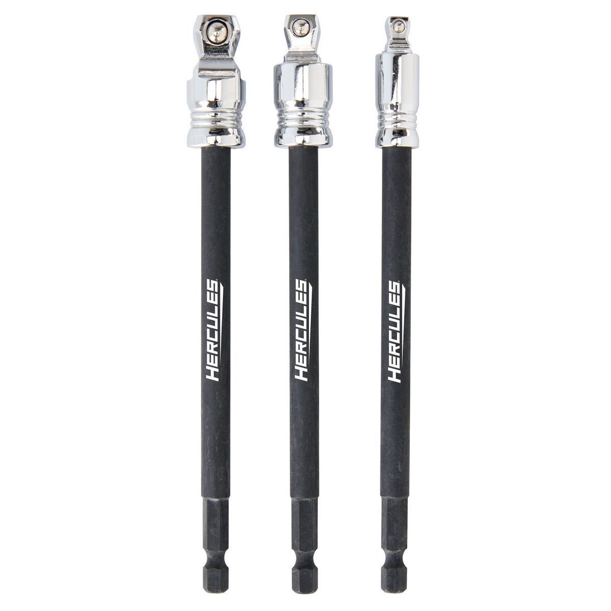

October 15, 20233 yr comment_322704 Great idea Mike. Appreciate you sharing it. After seeing your extension idea made me think if one would use these types of extensions with your drill, you could create an oscillating spindle sander of sorts. Report
October 15, 20233 yr Author Popular Post comment_322707 36 minutes ago, Grandpadave52 said: Great idea Mike. Appreciate you sharing it. After seeing your extension idea made me think if one would use these types of extensions with your drill, you could create an oscillating spindle sander of sorts. Thanks Dave I actually have similar but I used a Dremel tool with a sanding drum initially to eliminate some router burn on the oak end grain. The longer hand held gig as posted is the the counter to my propensity to screw things when my impatience teams up with too much power. A man has got to know his limitations. calabrese55 Edited October 15, 20233 yr by calabrese55 Report
