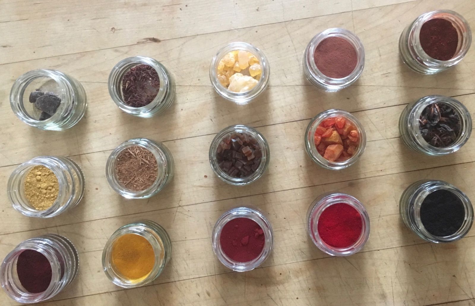

October 3, 20233 yr Popular Post comment_322122 I've got three types now, longleaf pine, eastern white pine, and (white?) cedar. The EWP has lost its mojo. That, or my nose is smelling its age. I use clear plastic ice cream jars but I do not think they are airtight. These little 1oz jars hold samples of old varnish pigments. Report
