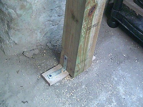

October 17, 20233 yr comment_322779 Ok...issues with that washer inside the chuck...tore it back apart to find... 2 on the right, are a before and after...one on the left fit a lot better....time to set up a test drive? Goodell Pratt Co. Brace...connected to.. The Goodell Pratt Co. No. 1080 Chain drill...and a 3/8" drill bit... Wrap the chain around the post...Star wheel controls how many revs before it allows the bit to advance... Kinky chains, on a Boring Job? May just leave this set up as is.. Figure out how to stow that chain, first.. And that is one use for this contraption.... Report
October 17, 20233 yr Author comment_322785 Wait … i didn’t see any sawdust in those pictures. We need a report on how well it actually works. Maybe clamp a scrap of 2x4 tonthat post and actually drill. Report

October 24, 20233 yr comment_322983 Ok..note what is on the floor.. A wee bit of concrete dust from the tap-con drill bit...and a lot of Pine curlies from the post drill..which was in use right above here...drilled in maybe an inch, just as a Test Drive... Report
