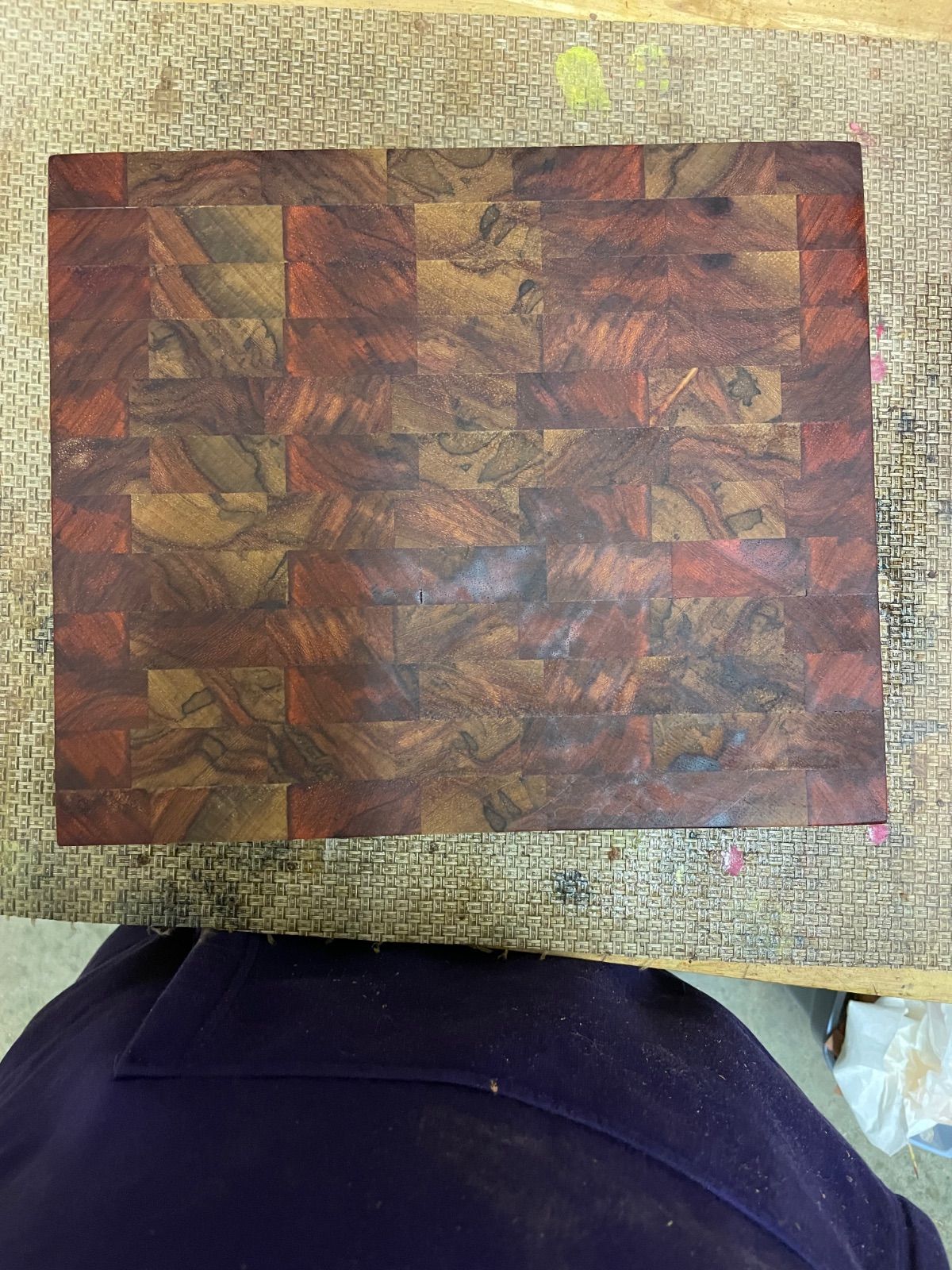

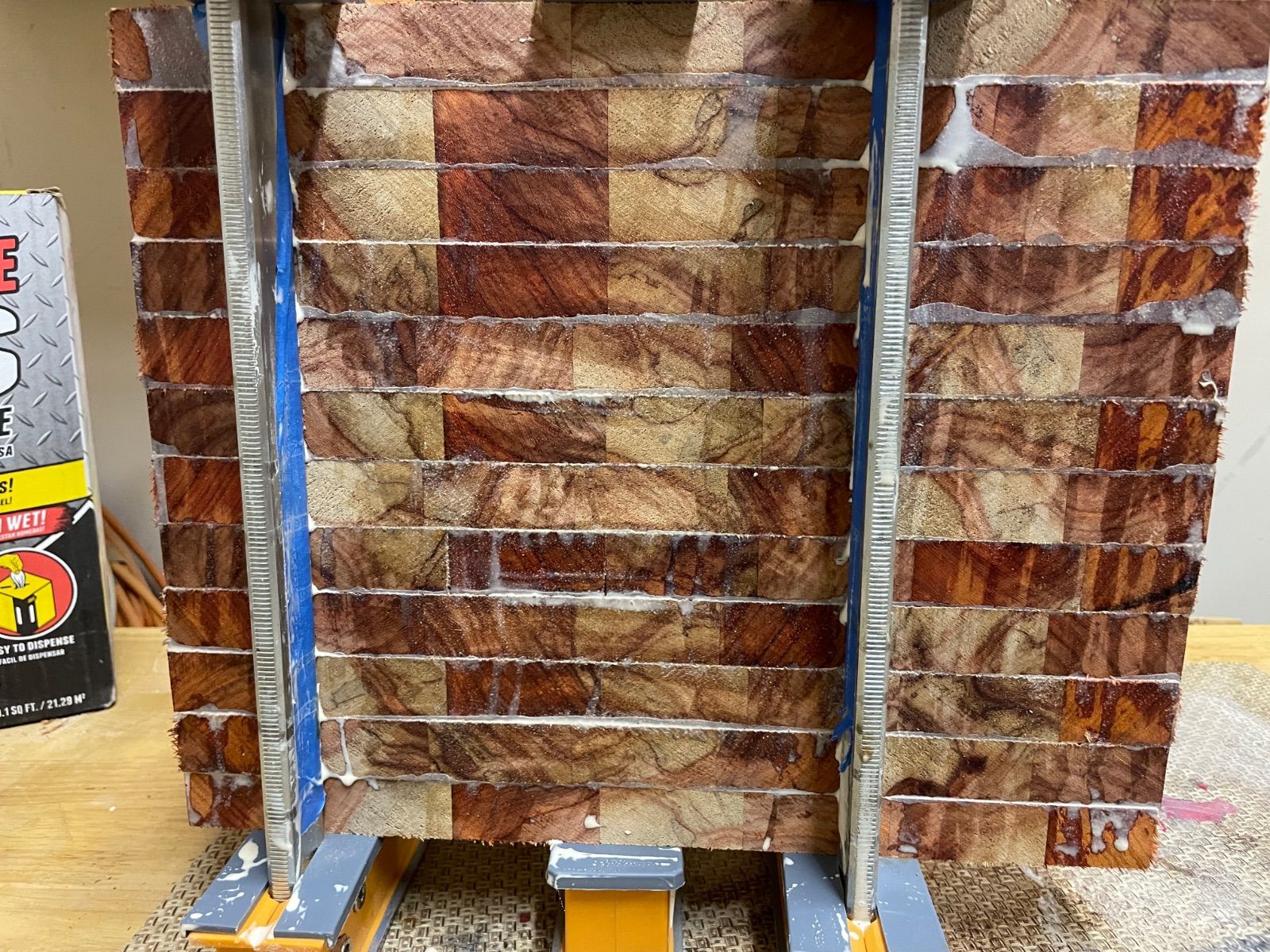

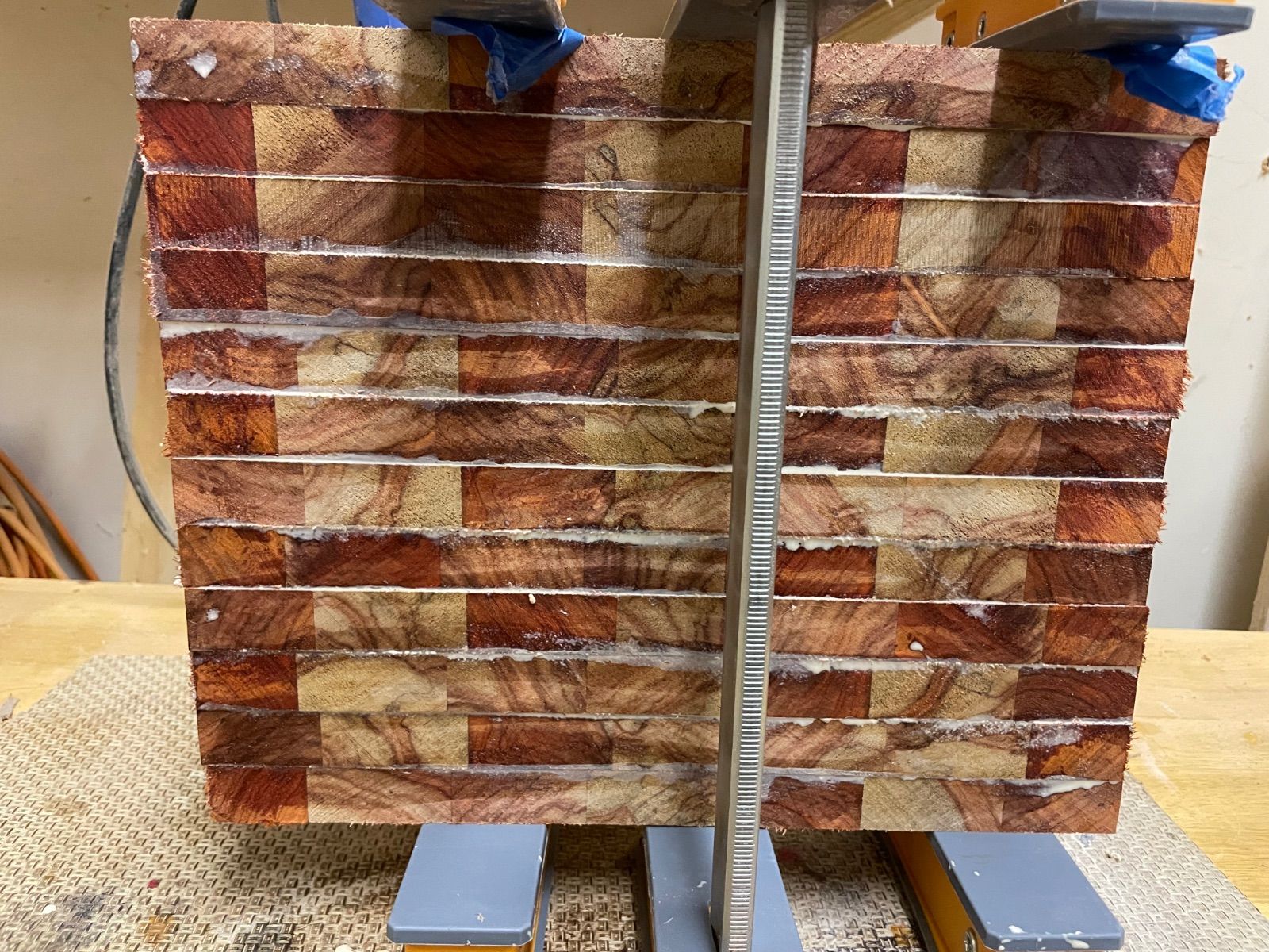

End grain glue up. The grain is turning out better than I expected
WOW! Can't wait to see this one done and finished. Gonna' be an eye catcher.

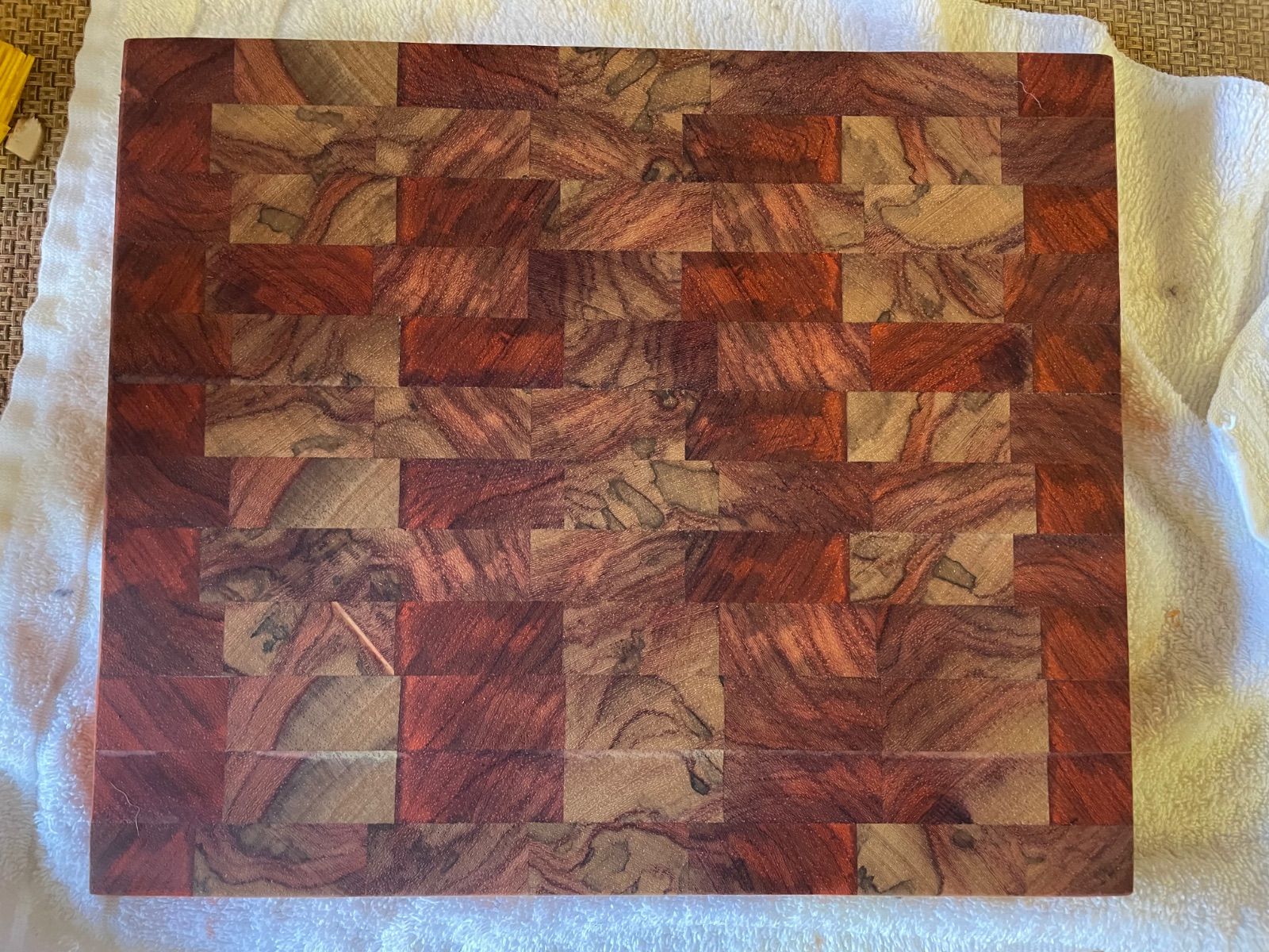

Sanded 80&120 spritz with water to raise the grain. If I get time tomorrow before catching a plane sand 220&320 and oil it up. Then put some wax on it.
Thank you Lew means a lot coming from you
The grain and pattern is amazing.:TwoThumbsUp: That will be hard to use and scar it up.
Looking forward to seeing it sanded and oiled up.
That's amazingly cool Kevin!

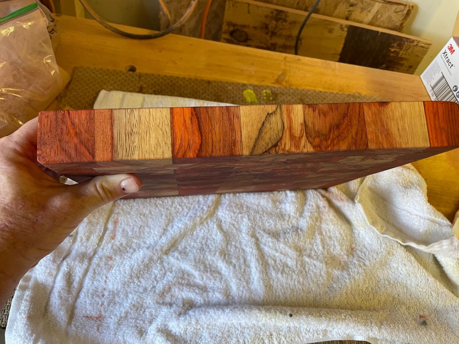

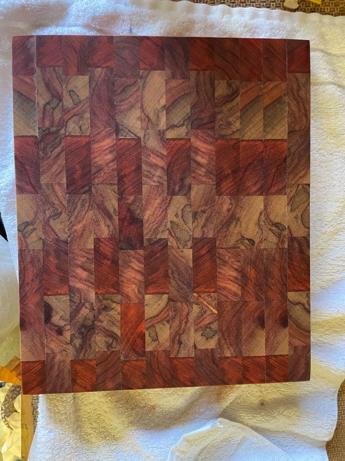

Did the final sanding this morning to 320. Put some Walrus oil on her. Sunday or Monday I’ll put some walrus cutting board wax on it.   Thank you for the kind comments. Everyone on here has helped me to get to this point. So to you, I say, Thank you! IMG_7357.jpeg.b1c6d42db3671f19984509badc8c0e36.jpeg
Very nice.  Love the grain.
Very nice and a great grain pattern. Don't think I could do one without using my wide belt sander, it really saves time on this type project. As a matter of fact I learned how to do these from @DAB years ago on the old Wood Forum,

Thank you Gerald! I will look into that app. I played with the patterns and got lucky. I did spend a good bit of time sanding but it could have been worse.
ahem....(too nice to use....)
hush you!!!
