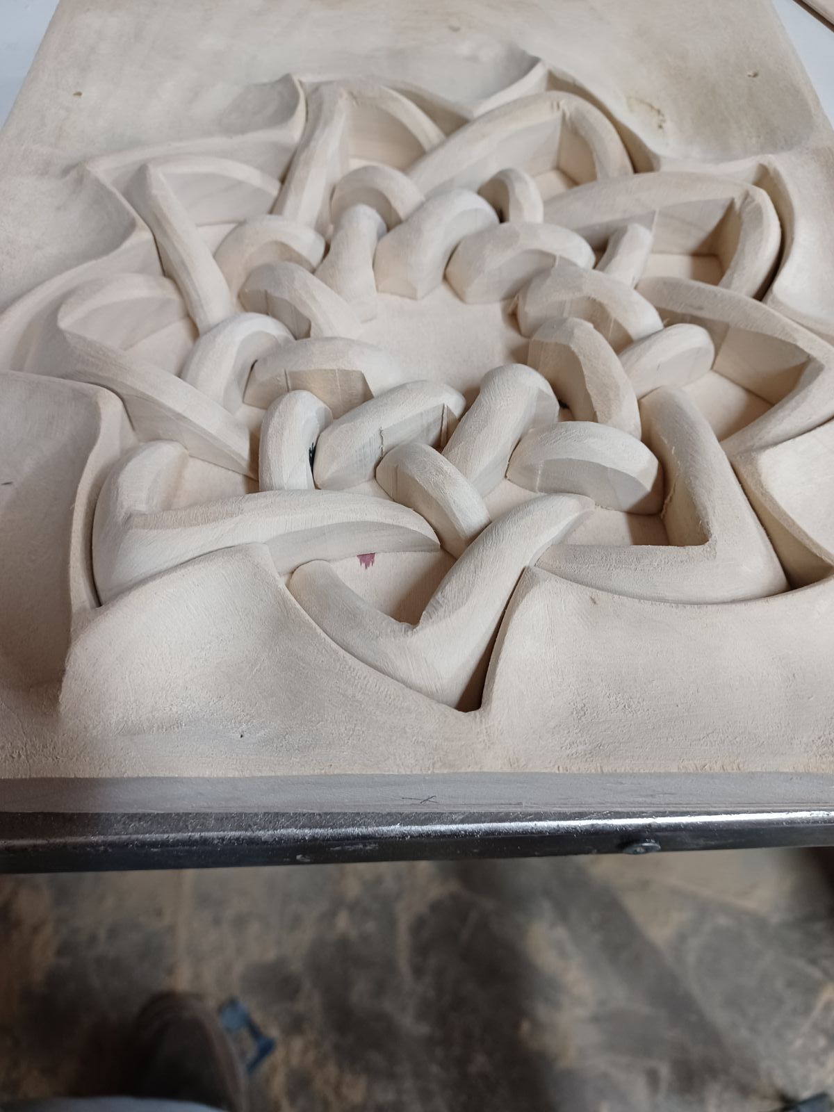

June 14, 20233 yr Popular Post comment_316023 I started with the picture too small to hold in my hands while grinding the unwanted parts away and decided to hang it on the wall as a reminder. I already had this small piece of wood so I made the picture fit in that area. I usually do it the other way like having the picture as the size I want to work with then prepare the wood to fit that size. Thats only the second time in my life I made a mistake.And the back side shows the small pieces. smallpatch Report

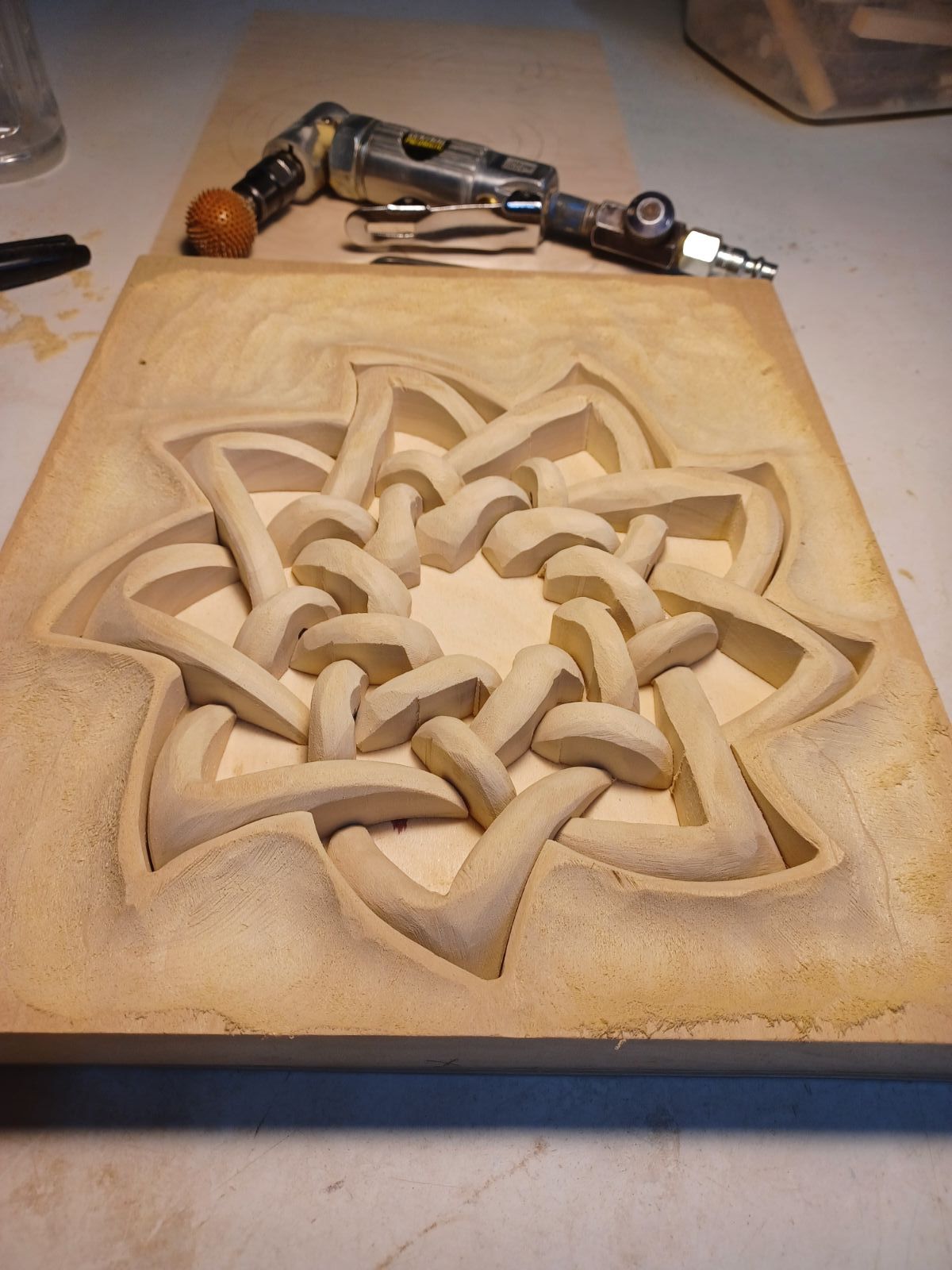

June 15, 20233 yr Author Popular Post comment_316105 Thanks guys and Dave the only reason I slowed down posting things here is for some strange reason my body seems to want to keep me out of the shop and in to an easy chair.. I made myself a promise when I was a teen as I could see those old folks not being able to walk like they use to and it really puzzled me, were they trying to get attention or what... Well I decided I am not a quitter on projects that lots of labor is involved like this Knots puzzle so yesterday I started back on the Celtic thingy.. This morning I used the little air angle grinder just on the areas outside of the Knots and am getting ready to start sanding on everything after lunch. Most all the actual Knots pieces are all built so only one sander was used here. And the 1 x 42" belt disk sander is the most used sander in my shop. I have got to where that little I " wide sanding material gets used in all kind of positions. Sure I do get a little skin every once in a while but hey if that's as bad as I ever get in this shop, so I'm happy... That I" round bit on the angle grinder is probably 4 or 5 years old and still as good as the day I started using it and it does all the inside curves if I have an area to handle it. I can't remember what it is called but Wood Carvers Supply in Florida has a picture of it in their catalog. And this bit has always been used on hard maple but this time only I used popular for it was already the size I needed. Oh, and the angle grinder From Harbor Freight I think still less than 25.00. It has a 1/4" collet chuck so a person can only use 1/4" bits with it. The Dremels are 1/8" and smaller but there are good bits from the same supplier that does just as good only for smaller areas. Report

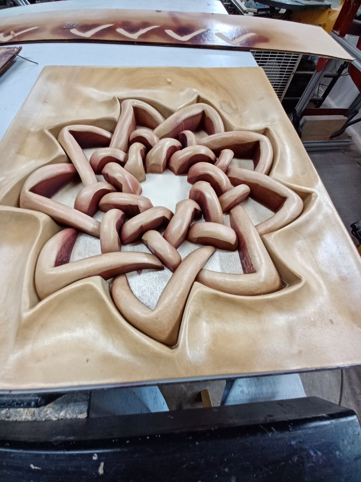

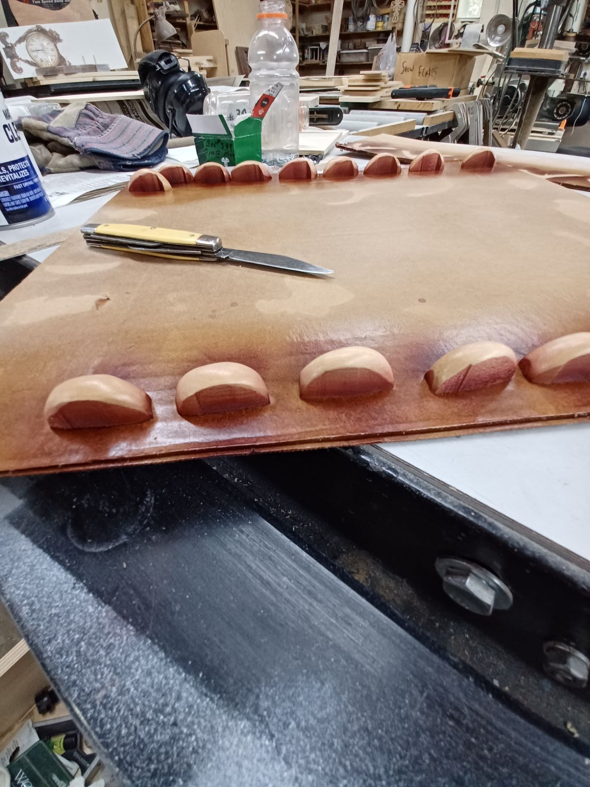

June 17, 20233 yr Author comment_316208 Heres what it looks like today. Am finished with applying the finish which was Rusteolum 2 X matte after a few coats.. I have decided its the best finish out there and much easier than anything I have ever used. I had put some numbers up a little too high and would have been showing so I used the air brush with some dark stain and lightly sprayed each side and the numbers have disappeared much easier than trying to sand out the marks- so - lot . Nothing glued down yet as I think I have switched a few pieces around to make sloppy fits so I will try to put them back where they should be. Here is something to remember..... I use cardboard to lay out the pieces to spray and to keep them from sliding off the cardboard I use Aleene's regular glue with just a very small amount on each piece and let set for a few minutes before you start spraying....I use the Aleene's glue in the brown bottle for it takes longer get real hard and that does help when using a knife to remove by scraping it away before I glue the pieces on the wood.. Report
