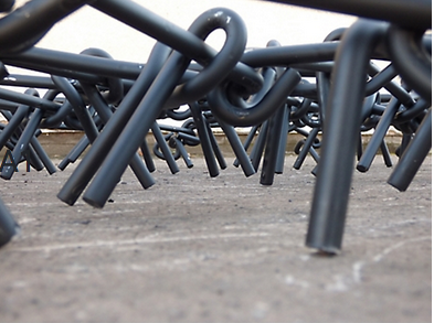

I have a drag harrow similar to the one Gene pic'd. Maybe I'll try using it before I do anything else. I had it for smoothing the gravel in the drive at our last house...haven't used it since.
We attached a couple RR ties to it for weight. One caution...don't get caught in a corner. It don't  back up worth a darn.:rolleyes:

Yeah, I agree but I can't loose anything by seeing what happens. The one I have has fingers underneath the fabric that might break up the soil a little....or not.
We had one like that too. It works even better than the screen like one on rough / rocky ground. We had a 1/4 mile lane from the road to the house. We used that to break up the Virgin land in preparation for cinders. (Lots of extinct volanos in that ares) Followed up with the less agessive chain drag.
I do not have a suggestive solution, but IMO the drag equipment will only pull the grass up in clumps.
