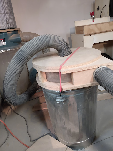

kmealy Posted March 7, 2023 Report Posted March 7, 2023 In early 2021, I converted my Jet cloth bag setup to a retro-fit Wynn pleated filter. It came with two plastic bags for the bottom. The pleated filter became a more efficient final filter vs. two cloth bags. It is my understanding that the "efficiency" includes both a finer filter size (remember, it's the fine dust that is unhealthy for you) and less resistance, so lower CFM loss. My table saw and planer go thru a Thien separator, but my miter saw, due to configuration, does not. I've filled up the 30 gal garbage can about every 2 months, but have about 2" of sawdust in the bottom of the plastic bag. I would say about half of that comes directly from the miter saw. But.... to answer your question, I don't see a reason why you can't reuse the plastic one as long as you don't rip it. lew and Grandpadave52 2 Quote
