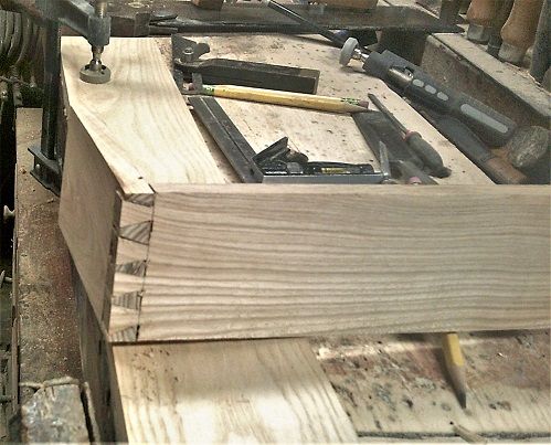

Solid wood tops and bottoms and box joints corners.   Went a bit faster but still multiple hours per box.

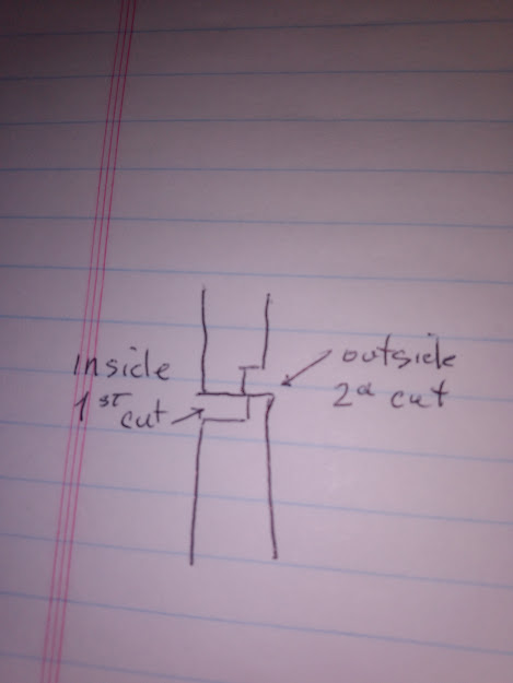

Has anyone ever done this with a groove on the inside before assembly, then cut off from the outside so that there is a self alignment for top and bottom?  Wondering how wide the inside groove needs to be so that there is a good reference once sawn off.  I'm thinking one pass of 1/8" is not enough.  Could do two or run it over the router table with a 1/4" bit..

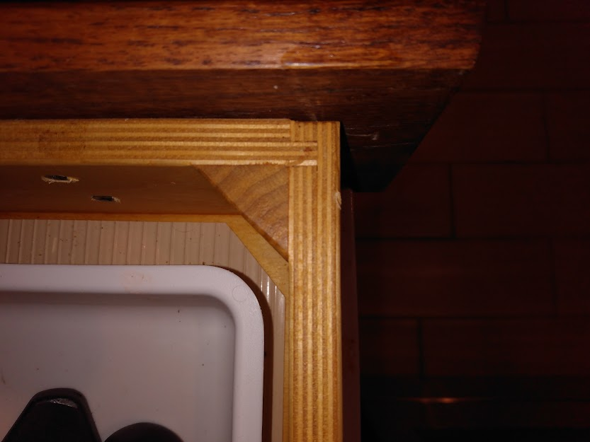

Keith, for something like this, to get the boxes out quickly, I'd use standard ol but joints at the corners, glue em up, then drill for two or three dowels into each corner to secure them. The dowels look pretty cool and they are a very strong joint for your purpose. Cut the dowels flush, and sand smooth.
Or even faster and very strong, counter sink the corner joints for screws, then plug the screw hole with a dowel and sand flush. But ya, I'd use a butt joint and dowel it.
Box below shows a rabbeted drawer front and the back is a but joint. I'd go butt joints all the way around just to get these out to the youngun's, and it'll be a strong box too.

And yes, I've made a perimeter slot on the inside face of all 4 sides before gluing up the boxes.  Then I cut free the lid with an offset perimeter slot on the outside of the sides to end up with a self-fitting lid.

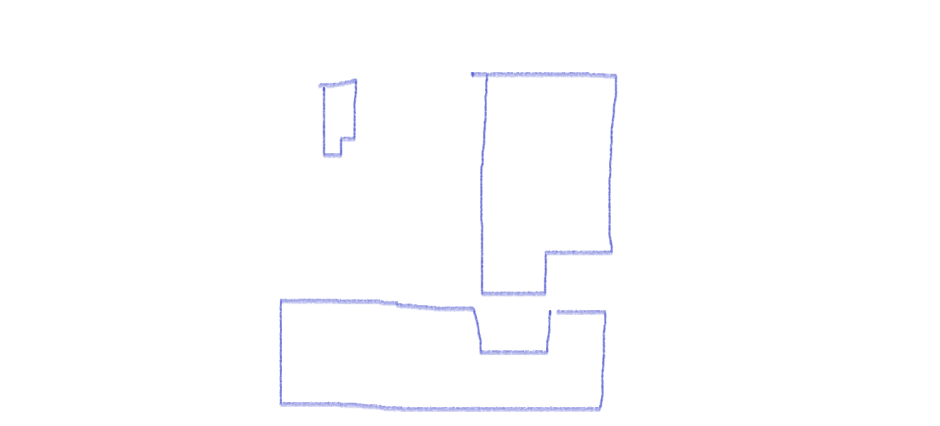

Drawers triggered a thought -- I've done some drawers and boxes with rabbet and dado joints that are fast and strong.  The infamous quarter-quarter-quarter joint
I've done it the way 4D describes in his last paragraph. Pretty quick and slick method resulting in a good fitting lid.
You might check out the 1/4 ,1/4, 1/4 method, too. That is more for drawers but, can easily become lidded boxes.

This may be the same joint just drawn. it is done on the tablesaw and is easily repeatable.joint.png.81930d785a1c192c896b7cd9850f6b9b.png

Stanley 45 makes 3 grooves on the inside, BEFORE the box is glued up..then the 4th groove is run around on the outside..has to be below the inside groove..then a sharp knife to separate the lid from the box..leaves a dust seal all the way around...

Sometimes. one has to plan a layout to accommodate for a lid...
Maybe make one pin or tail a double?  then have the lid open in there...
