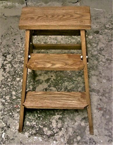

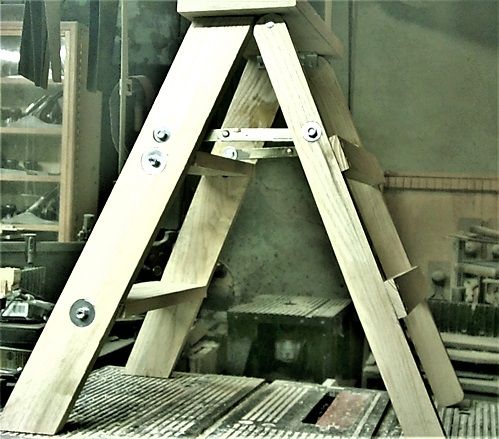

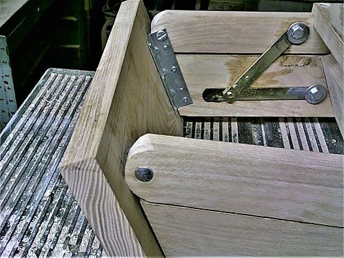

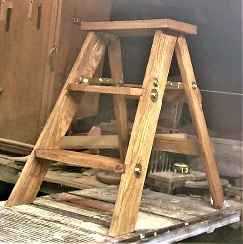

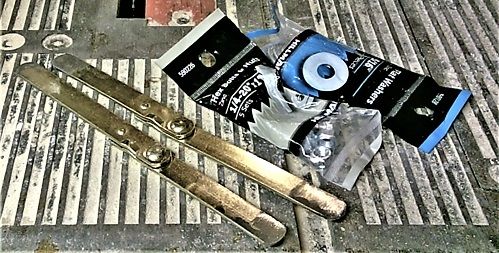

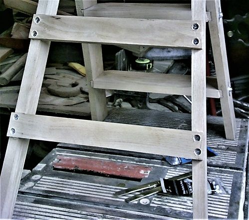

February 8, 20233 yr Author Popular Post comment_308204 Ok, here we go.... Slimmed down leg braces... More to "scale" with the small ladder... Metal working.. These 2 locking braces need drilled for the bolts, set a new drill bit into the slowed down drill press...had to use a corded drill to run the forstner bit to recess a few washers.. Had to make sure they were the right-side up, and that they folded up nicely... A dab of Blue Thread Locker before the nuts were installed... Seems to work....set this down on the shop floor, and step up onto the lower 2 steps...with my full 230 pounds....not even a sound was heard... Witch's Brew for a finish...have to decide where to use the Branding iron....maybe a block plane to ease the sharp corners? Stay tuned... Report

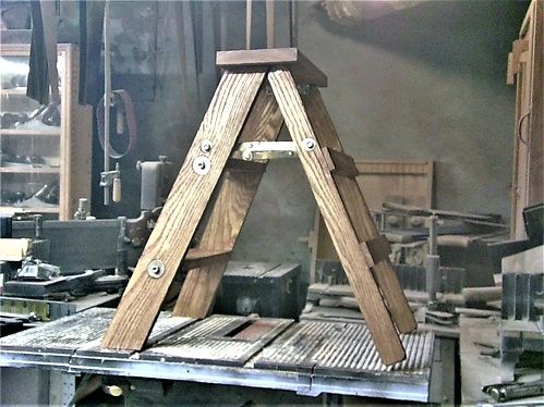

February 9, 20233 yr Author Popular Post comment_308304 Ok...here ya go....one coat of Witch's Brew.. Then a view of the side... Then a look around to the back...( enjoy the shop views?) A view of it sitting on the shop floor... Has been "tested" up to 235 pounds.....yep, I stood on it... Will get the branding iron plugged in after a run to Wall E World for the Boss....brand is going on the top step.... Report

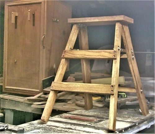

February 9, 20233 yr comment_308307 Looks like one of those back legs floats. I call that a great feature. When the other back leg wears down to the height of the short leg the users have likely gained weight and now having 4 legs the ladder will still be plenty strong! BTW you've done a great job. Love the final look! Report

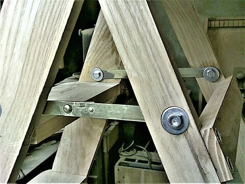

February 9, 20233 yr Author Popular Post comment_308312 Had one of the folding braces in bass-ackwards....have fixed that, now....wasn't letting the one leg go all the way out... Branding iron is NOW heating up....have 2 items that need the brand... Report

February 10, 20233 yr Popular Post comment_308377 I'm a little late to the dance, but I love the way it turned out, Steven! As for the possible problem with the back braces being used as steps, there is an easy solution. Instead of two bars across, use a couple of thinner pieces to form an X and VOILA! Nowhere to put one's feet. Edited February 10, 20233 yr by HARO50 Report
