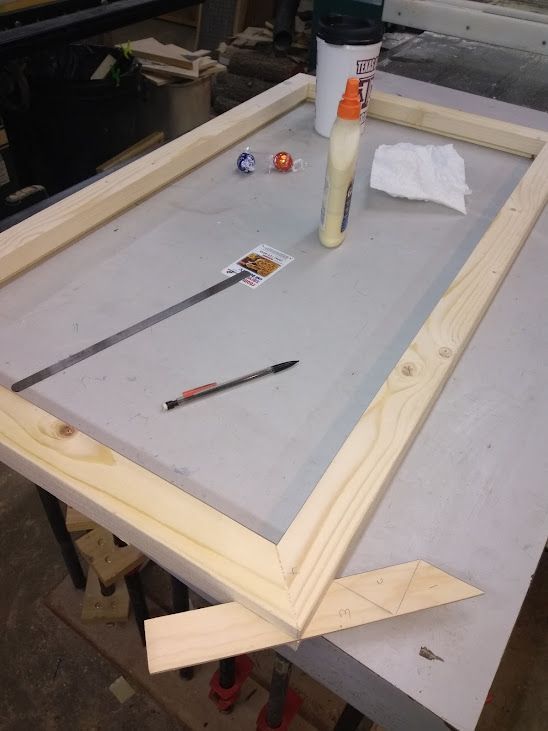

I had a problem with the wood frame the wife had me make for the stained glass picture we delivered to Austin and hung in the stair way going to the second floor. I made the frame 3 or 4" wide so this frame had more glue area that the regular frames I make practically every day for my lovely, then delivered and installed it.
 Some time later we got a call saying her beautiful stained glass picture had crashed all the way down on the floor. It was in a big pile with glass every where.
  So, every one has their own opinion and for me not to have to worry anymore and especially since I make probably 50 frames a year of all sizes.  I do this to all my frames now.
  I really thought I was great at building picture frames since I had gotten a lot of experience in those 10 years before the crash happened..
 So now I don't have to worry.IMG_20220414_100055991plywoodinthecornersofmypictureframesnowIdontworry.jpg.fa99896344db8782e95e5b90075154f8.jpg
for all the frames I build has 1/8" bb in each corner.

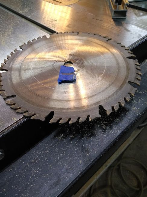

And here is the way I get the exact size slot cut for the BB. Give a little help to the saw blade and there it is.IMG_20210604_111116048correctwidthofslotsforcornerbraces.jpg.ad1a4d14721f3ac568112d1137c888dd.jpg

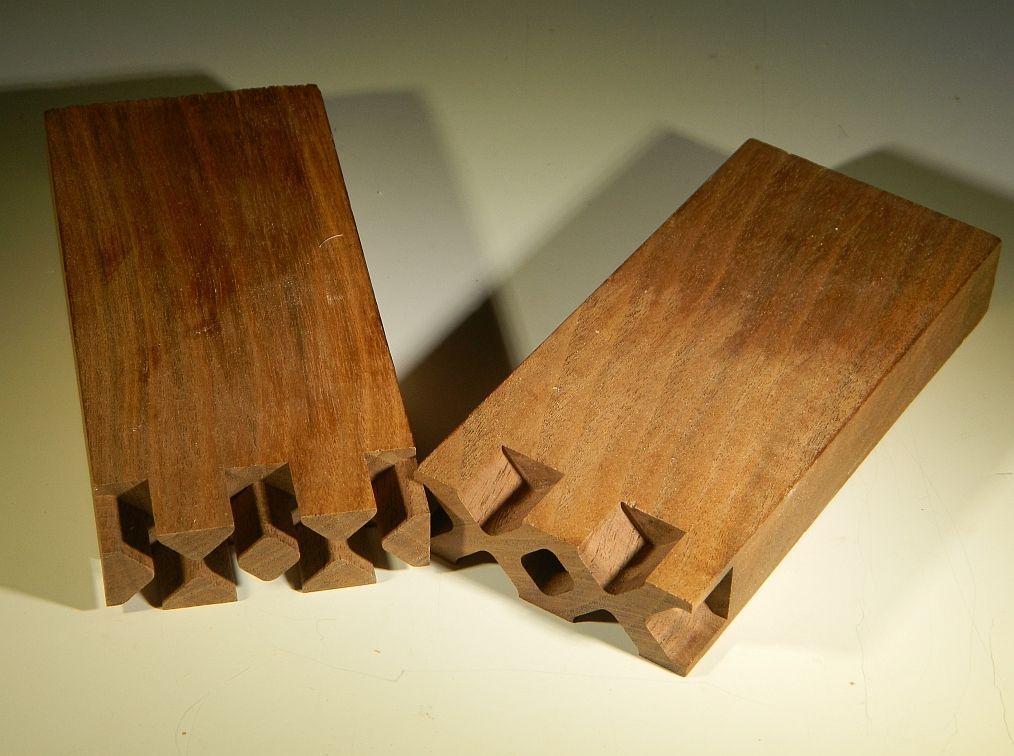

An older thread but it provoke me to dig up this old sample joint I made of an end to end grain "finger" joint. Adds some side grain gluing surface to the matching end grain to end grain surfaces in the joint.
Just in case  you don't trust a pure end grain to and grain connection.  ;)
 You do put a CNC to the tests:Praise:
Can't help it.  Same with every other tool I've paid good money for.  Taught Furniture Design to college students. When they had a joinery challenge in their design I never said "No", but would sleep on the challenge and usually have a sample cut for a solution the next class period. Creative use of the bandsaw or hand held router with jigs/fixtures to control how the board was fed through or the tool was moved over the wood.   Nothing like creative college students to keep me busy and challenged.
