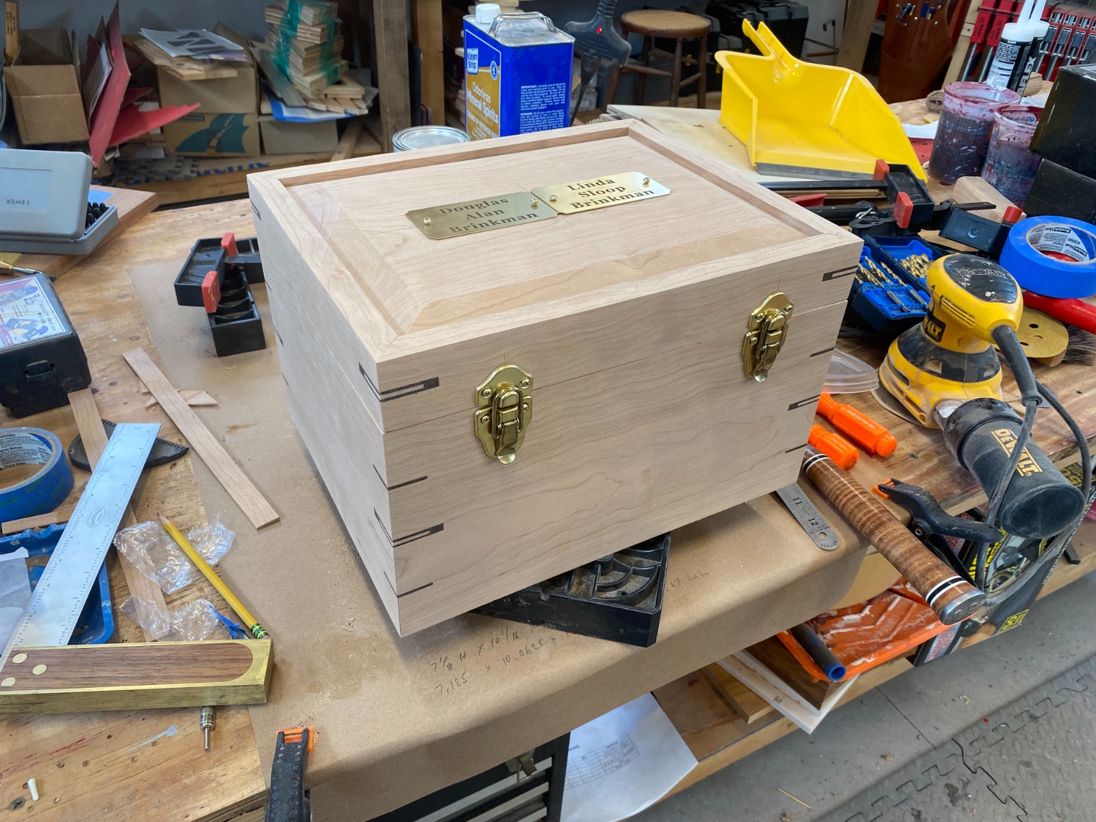

A fancy box, a labor of love
After some fussing yesterday to get it to fit together properly without glue, decided to glue it up today after church, will let it cure all night and do more tomorrow.  need to cut the top off, and then add some horizontal corner splines out of wenge and cherry.  the vertical splines are of cherry, same wood as the rest of the box.  they will get cut off and sanded smooth.

top cut off, excess vertical splines cut off and sanded smooth, some general sanding, large kerfs cut and horizontal corner splines added in. let this glue up overnight again.
these splines of wenge are 1/4" wide, so i'll later sand them flush, and then cut another kerf in their centers to add a contrasting spline inside a spline. this is for both top and bottom pieces. the bottom will also get two more narrower splines, also of wenge, one at 1/4 way up, one at 3/4 way up.
this is why these kind of builds take several days.
blue tape is just to make sure they don't wander out of the kerfs while the glue sets.
little hint:  glue up the top and bottom together, that way the top will be the same size and shape as the bottom.
Splines sanded flush. More, smaller ones later.
more splines:
better view tomorrow when the glue dries and i get things sanded flush again.
Hardware next

now you can better see all the splines.  Wenge and cherry, body is also cherry, all out of one board, so it should color shift consistently.

Hardware located and holes drilled, first coat (3 planned) of finish applied.  the spar urethane was a bit old and thick, so had to thin it out a bit.  seemed to work fine.

As a novice, I'm wondering what you do between coats and after the final coat.   Thank you.
a very light sanding with 220 between coats.  by hand, not the sander.  just want to knock down any high spots, and rough it up a bit so the next coat has something to grab onto.  after final coat, normally nothing, but you can knock down any high spots by rubbing with that same craft paper.
