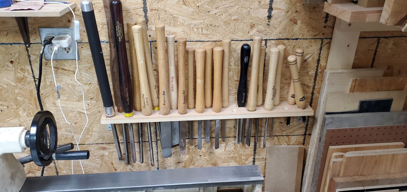

My advice would be to buy decent tools. My experience with buying an 8 piece set was that I only used half the tools in the set and the ones I did use weren’t that great. You can get great tools for a good price if you buy the tool from Thompson or D-Way and make your own handles. That is what I do. I make my tool handles from shovel handles from Lowe’s. Already the perfect size so not much to do. I like my handles long and can get two from one shovel handle. If you like them shorter you should be able to get three.
I forgot. You can buy the inserts from Cindy Drozda so you can remove the tool to make it easy to sharpen. This is what some of mine look like. I also use one handle for the same size tools and swap them out. Not as much room to store them and only seconds to swap them.

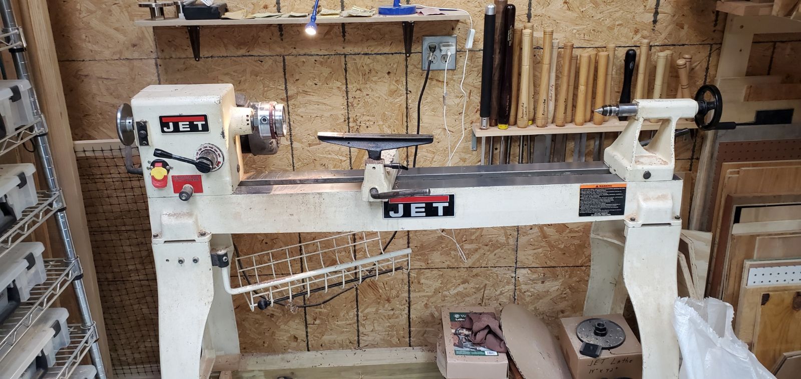

I can't comment on spindle tools because I've never turned a spindle yet... but I do grab the left hand carbide insert tool a lot as well as the bowl gouge. The scrapers are used a lot too.
Most of the tools came with the lathe when I bought it. I bought the large bowl gouge, the angled scraper and the spindle gouge with the black handle.
Better quality tools stay sharper longer I've found.
