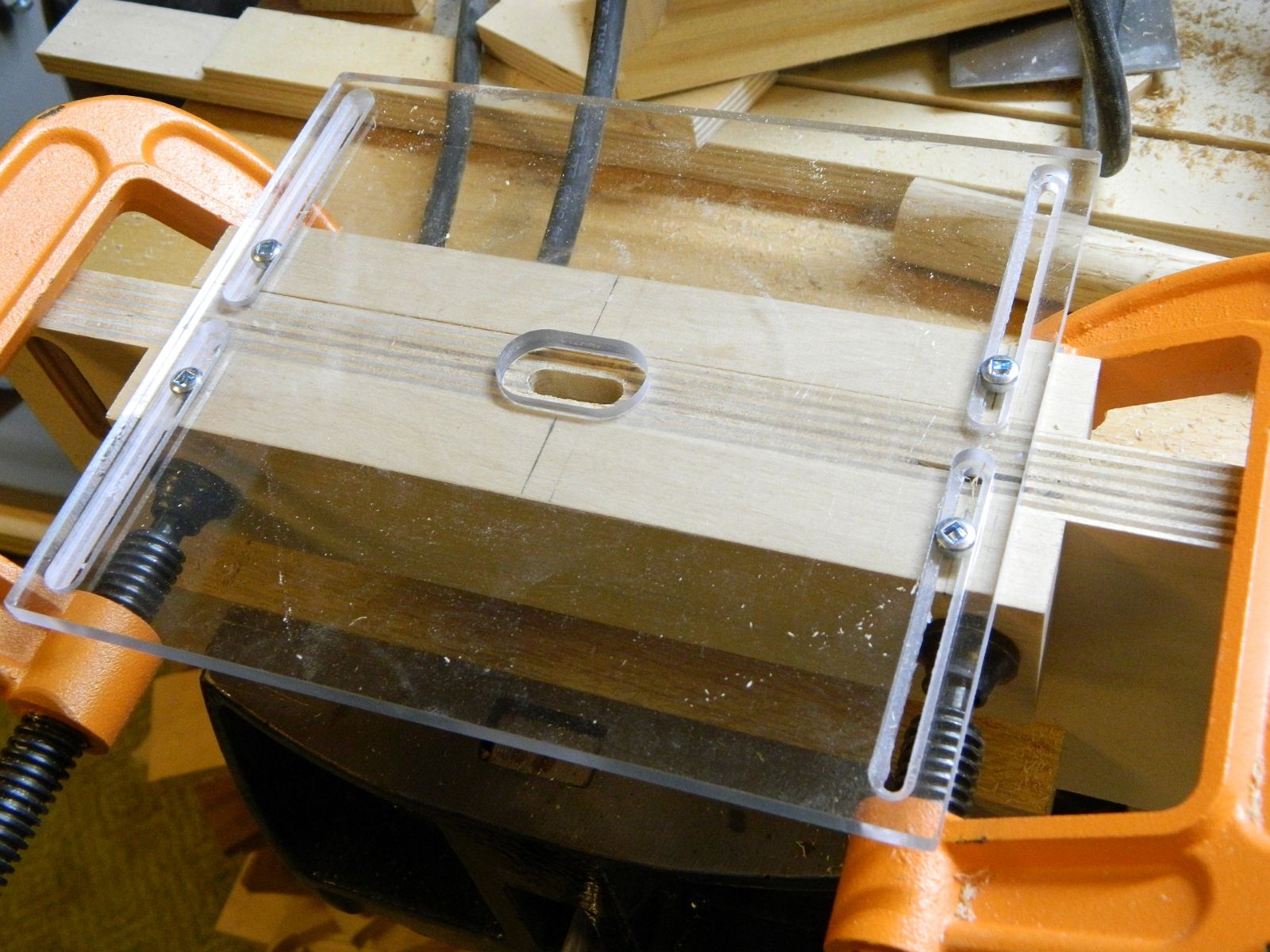

I went ahead and cut out the template.
Steps  1/4" each until the bottom.  The 20x40mm floating tenon needs just a little deeper hole than 3/4" to be half way in. Although this was just a test cut, now that I have the jig set up for the material and the router set up for the slot cut making several more along any edge of the same material would be quick and easy. Just unclamping, moving to the next place, then clamping it down again.   Next job if the material is a little different thickness add a step to adjust the jig to the new thickness by loosening the screws.  Same as having to adjust the fence of the Domino machine.

Sorry 4d, I was referring to the original design.  Template routing I have no issues with.

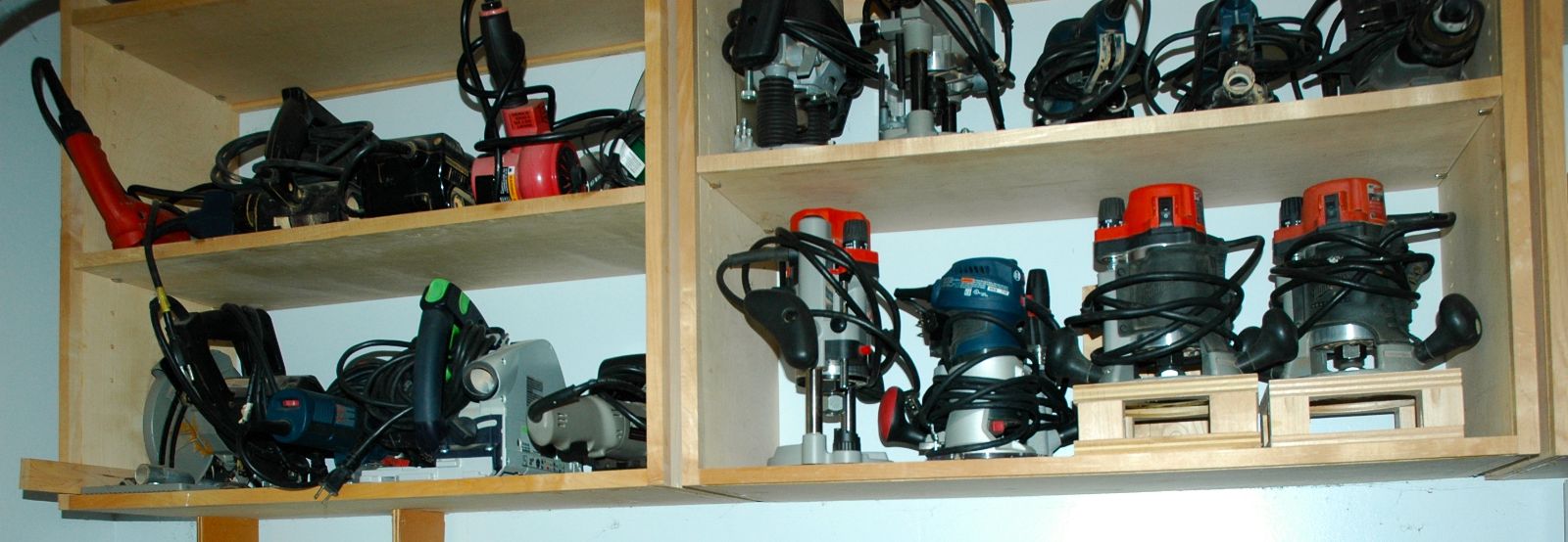

Gene, not arguing with you...or even trying to change your mind. But when I had the shop finished I was in a hurry to get my tools in there and still didn't have my stationary stuff set up. So I built some "quickie" shelves; so quick the top and bottom shelf was butt jointed to the sides with 4 biscuits and glue on each end (this is plywood) My intention was to do something nicer later which never happened. Those shelves are still there. In the pic the one with the routers is holding about 45# and shows no sign of falling apart. Someday I'll do something nicer, maybe.
