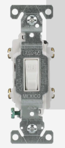

September 7, 20224 yr comment_298259 From what you said, the motor runs fine as long as you hold the switch on. If there was a short/problem within the motor, it would cause the dust collector's circuit breaker to activate. Not sure if that happened. If the circuit breaker did not trip, the problem is almost certainly the switch. My old Delta Iron Bed lathe went through 2 expensive Delta switches. Went to Lowe's and got a DPST switch. It lasted until I sold the lathe. https://www.lowes.com/pd/Eaton-Double-Pole-White-LED-Toggle-Light-Switch/1002944270 Report
