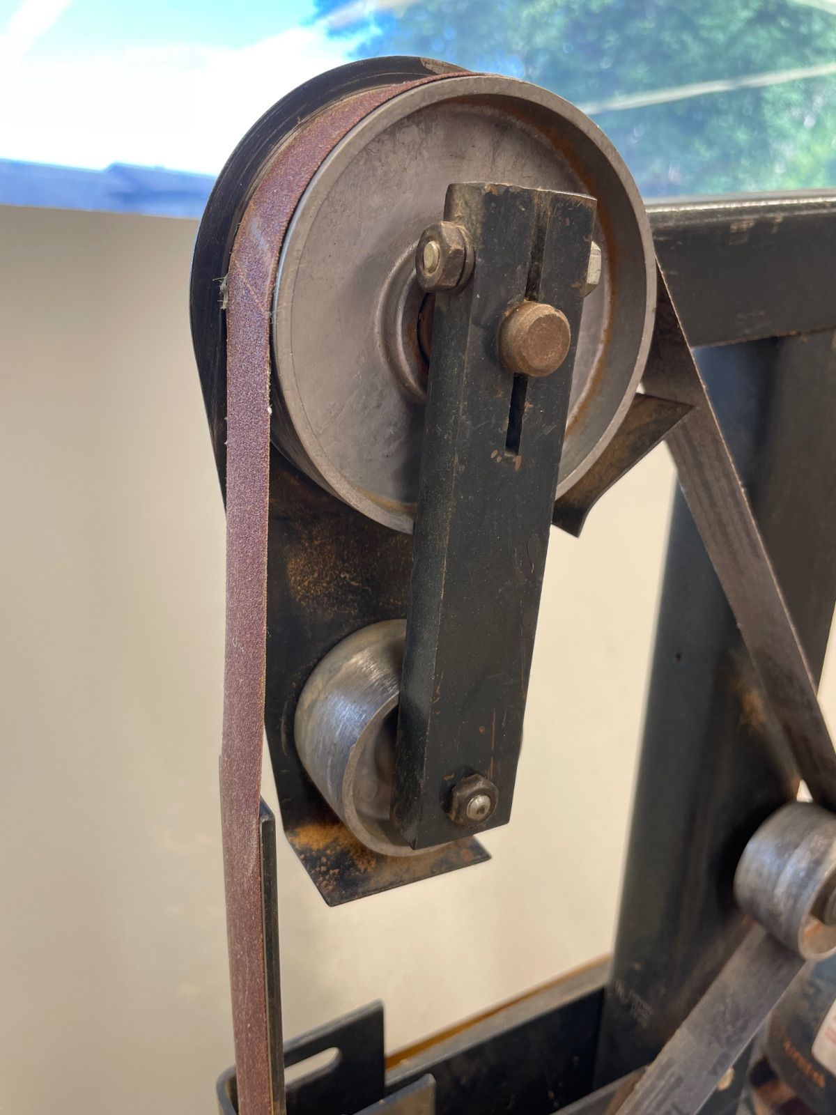

Greetings All:  I have a MontgomeryWard PowerKraft 1” belt sander Model THS 2761 and would like to find a copy of the Owner’s manual.
I found the belts for this machine but I am not positive I have installed correctly as one of the rollers done not contact the belt.  I am thinking this machine is designed to accommodate different size belts..

Here are some photos of this sander. One is without the belt installed.  You can see when belt is installed the one guide roller is just floating. D2559A9C-A01D-45FB-AC61-08AB3B7C7BC2.jpeg.e922136d12e3fc9fb8265bf73d3a1768.jpeg79973AA6-CBF4-47BC-B7E8-C1AC2E113C3B.jpeg.146111c69772f0d37c87956578879c68.jpeg934A6F41-B7A6-4C04-8E99-BB26AB1E3501.jpeg.5412c2e09048a0bbff4ace69a8d48aa2.jpeg

Thanks everybody! I think  I have this figured out thanks to Grandapadave. The Craftsman manual is s perfect fit for this sander. The upper idler wheel is not used when the platen is in place.  Once removed ( the platen ) the wheel picks up the slack in the belt.  Highpockets
