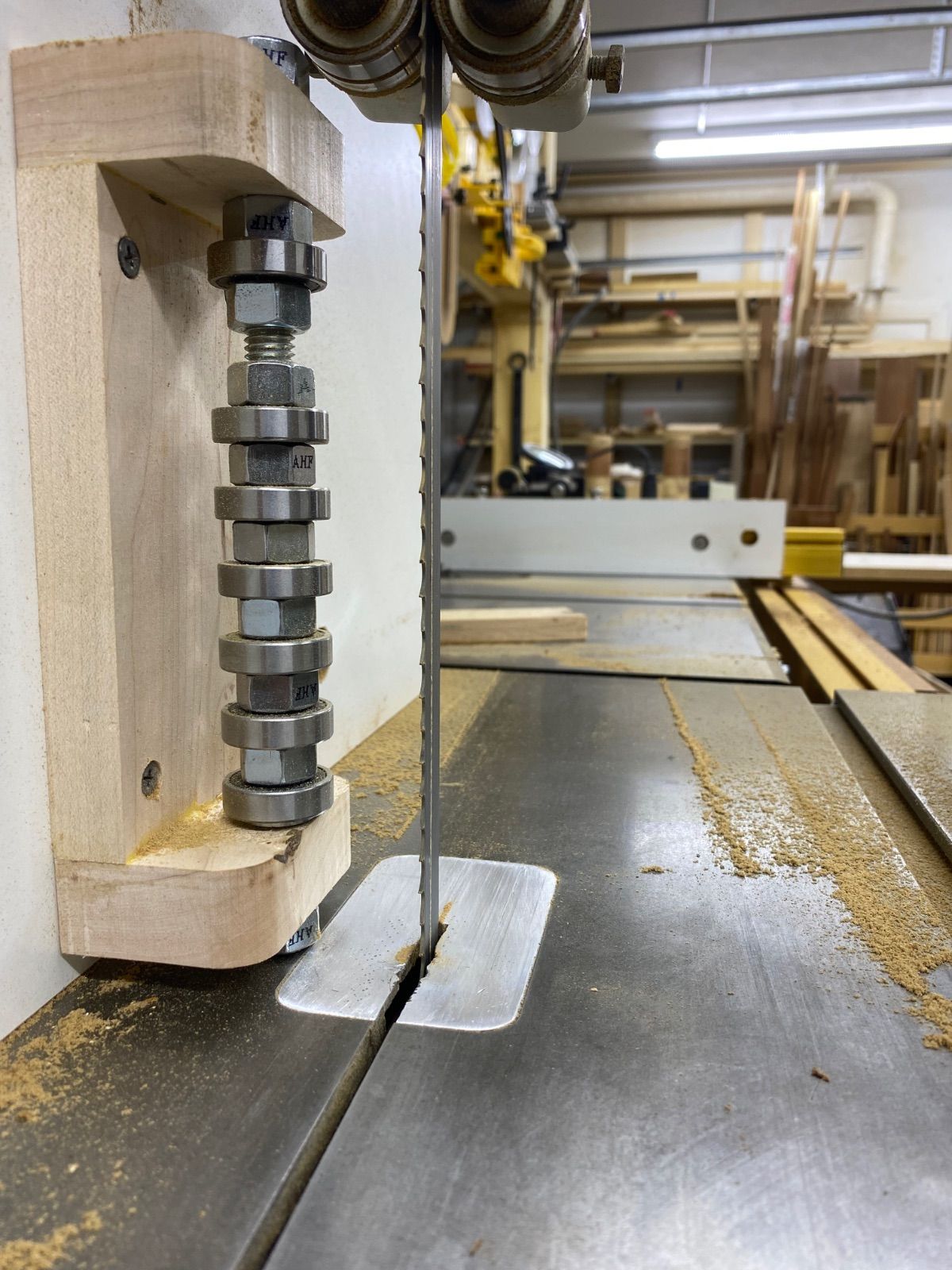

August 7, 20224 yr Popular Post comment_296110 The leg is mending and today I gave it a few hours working in the shop. Minor pain and a little swelling but as a favorite Marine of mine once said “ pain is what reminds you you’re still alive”. I have been meaning to make a new resaw post using bearings so today was the day. I need to resaw some more teak tomorrow and we will give it a test run. Paul Report

August 7, 20224 yr Author Popular Post comment_296126 It should work fine. I made it with some very inexpensive bearings, a piece of 1/2” all thread and a bunch of 1/2” nuts. The only problem I see is that the bearings were not of large enough diameter to allow the body not to interfere with the guide post assembly. That would have involved much larger and more expensive bearings. In order to make this work I’m going to have to make two more that are progressively shorter to allow for smaller stock. Fortunately they only take a few minutes to make. Paul Report

August 7, 20224 yr Author Popular Post comment_296162 Well the concept worked fine for today but definitely has a design flaw that needs to be worked out. Building it the way I did will work fine for tall pieces like today but for shorter and pieces less than 1 1/2” thick it needs a bearing closer to the table. An 1 1/2” off the table is too far for the bottom bearing. I have an idea that should work. To be continued. Paul Report
