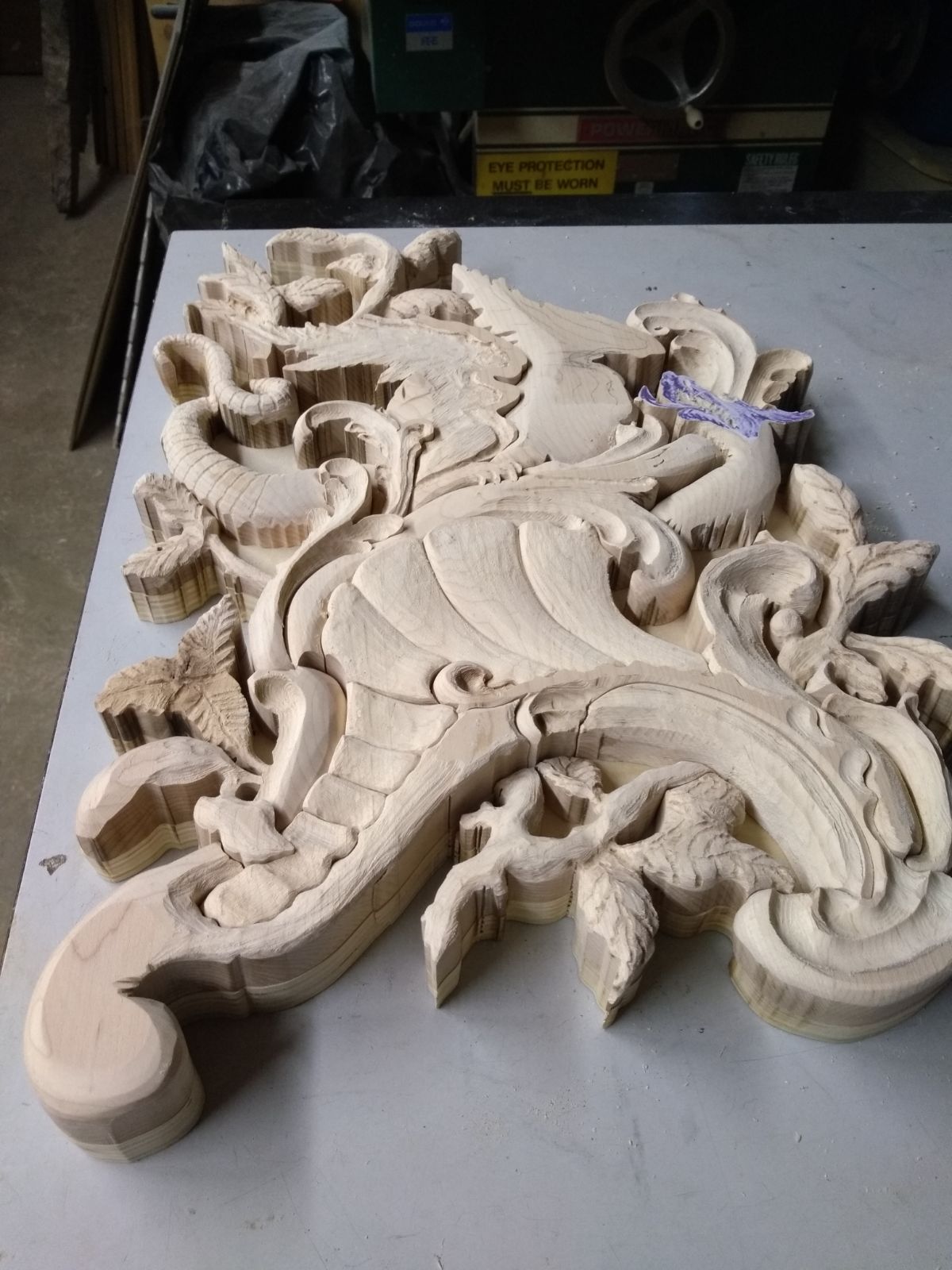

July 31, 20224 yr Popular Post comment_295648 All pieces have been sawed out except the dragon or what ever he is called. So now I am trying to figure out how to go about carving the small pieces I turned this hunk of maple in to. The object is to cut the pieces apart where by design the saw cracks will disappear. And you might know it I did flub up a few times and it is hard to adapt those places in to something presentable. I never attempted a dragon before so I don't even know what color those things should be? I'm showing where I'm at right now and there will be lots of shaping and grinding for a few more days. I'm running out of time on the temporary glue for it don't take long for it will come un glued so to speak. The better brands will give a slow poke more time to do the sawing. It will be more shop time when its over 100 so this might go faster than I had originally planned.. And for those who have never tried to scroll saw a piece of paper that is not sticking down is almost impossible to cut accurately. Edited July 31, 20224 yr by Smallpatch Report

August 1, 20224 yr Author comment_295770 Monday noon and this thing is going better and I'm still trying to make each piece match up height wise. Some of the pieces I have lowered at least 3 times and it looks like I still want more wild grinding, carving to look better. Different angle this time. Edited August 1, 20224 yr by Smallpatch Report

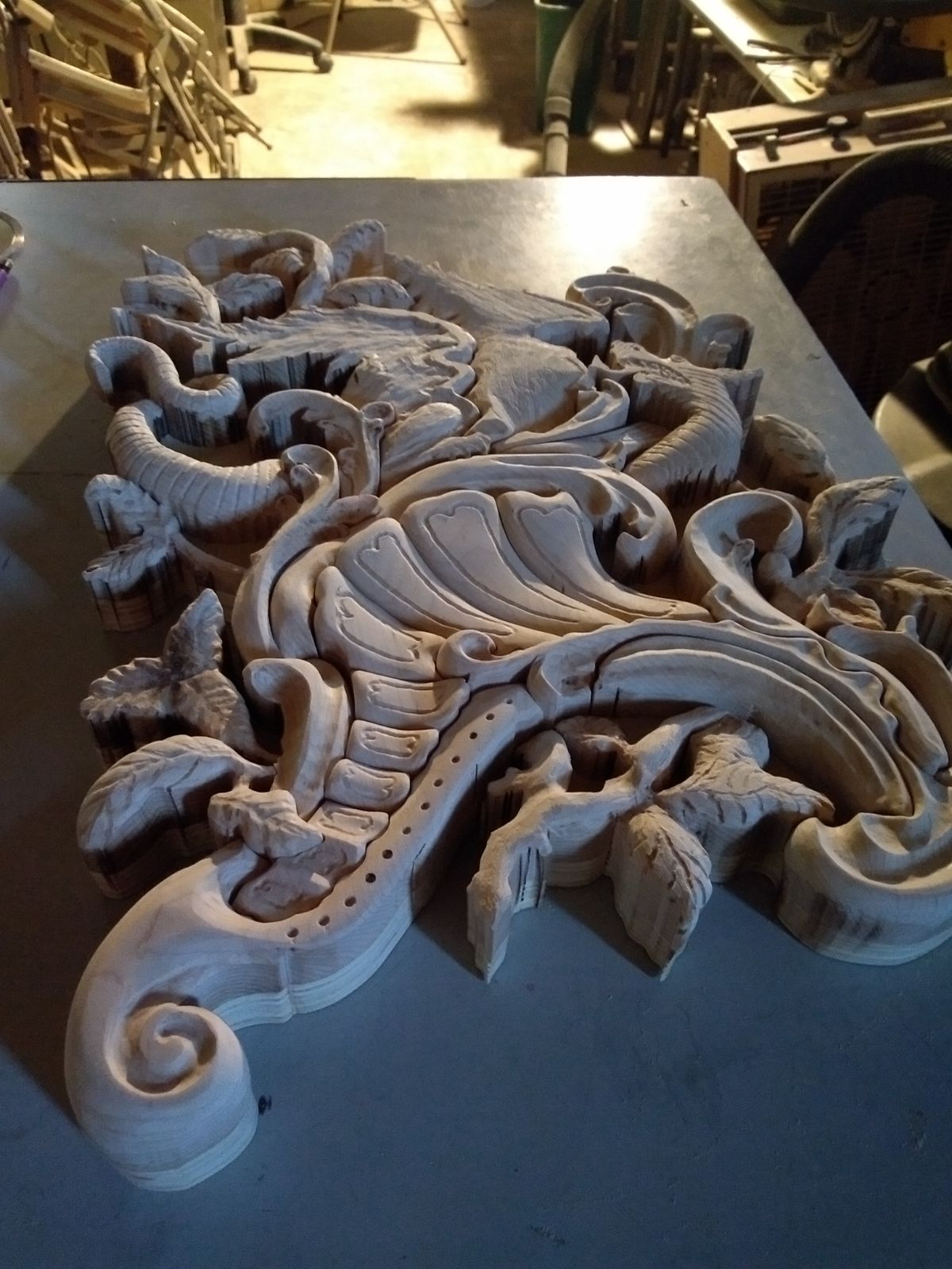

August 3, 20224 yr Author Popular Post comment_295844 This is the fifth day counting when we put the pattern on the wood. I am starting to see the finish line soon. Edited August 3, 20224 yr by Smallpatch Report

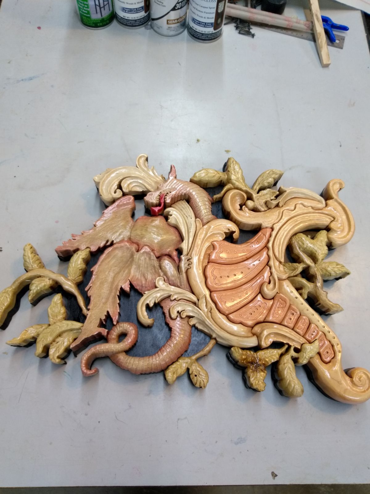

August 7, 20224 yr comment_296117 Very unusual Jess! While I don't do much of anything with dragons I'd say that you sure done justice to this one. Beautiful! Report
August 7, 20224 yr Author comment_296124 Cal, this was my first time to even be around a dragon. So yes my introduction to this guy started out with lots of doubts! And wings, was a big surprise also. Wife had to come in by my request to figure him out! He did finally start talking to us and said he would be happy to stay in the picture so to speak and would not be a distraction. And if we didn't want to see him all the time to just hang him in the closet...........where some of his friends my be hanging around. Report
