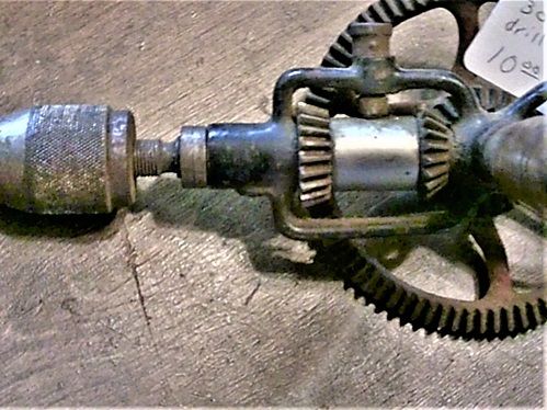

Came home with me, today..along with a new Camera...
Even has a gearbox...
A HUGE handle..
Drive wheel has a keeper, too..
All for $10?  Will need a bit of cleaning up...
That is a very nice find at a crazy price!!
Goodell Pratt Co.  No. 5-1/2 B.....last made by Millers Falls in 1936....G-P was taken over by Millers Falls in 1931...
