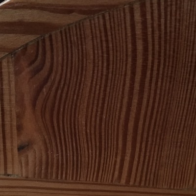

July 11, 20224 yr comment_294371 Within the large box of canned goods from the relocating woodworker are some gel stains, dyes, sealers. I'm wanting to make grain pop a little more, so am branching out. First up, Bullseye Sealcoat Sanding Sealer. Like the way it went on. Did a 0000 buff after it dried - almost dried, next time I'll wait a little longer. Like the way it looks. What happens if I do nothing further - no top coat. No foul? @Gene Howe , you asked me about R.Monocoat, so I assume you're using it. Have you sealed your wood or used something to enhance grain prior to R.M. ? Report

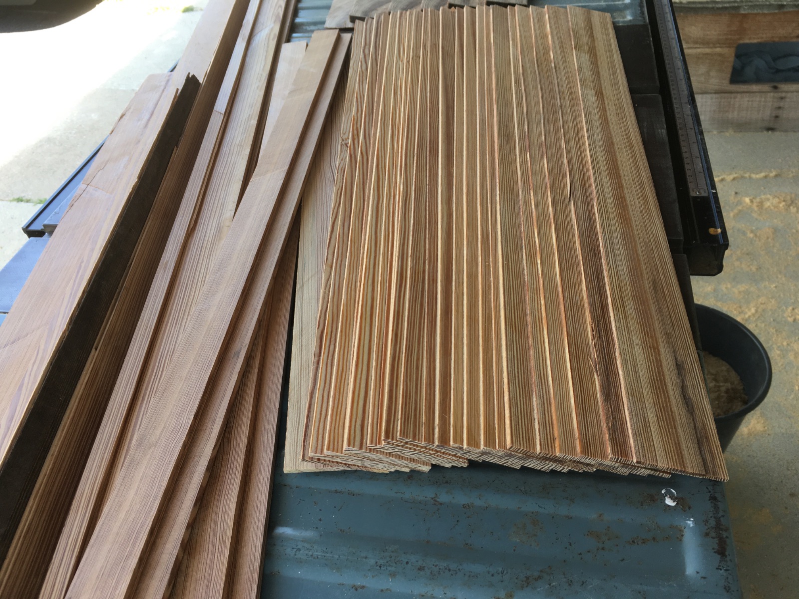

July 12, 20224 yr Author comment_294455 Thanks, Fred. I have some shellac flakes but assume they are not de-waxed. I did, against my normal procedure, read the can and see that it is spirit-based. I'll remember the 'test'. It is simple enough. I'm trying to look ahead when doing projects. I tried the SealCoat on the BACK of the project to feel how it spread, see it in action. Gluing the brackets onto the live edge walnut shelf, I taped the underside. Spread glue sparingly on both surfaces. Let it get a little tacky. Then clamped, adjusted, clamped, adjusted, clamped . . . Removed the tape, used a sharp edge to clean it up good. Just now cutting on the porch, I checked the blade for 90˚, cut a little, checked it again. Yep, it had moved. Re-adjusted it. Used the miter slider fence for a cross cut. Checked the final. Swapped into the thin kerf. Weighed my sawdust - 4.75 lbs! The "Process" Report

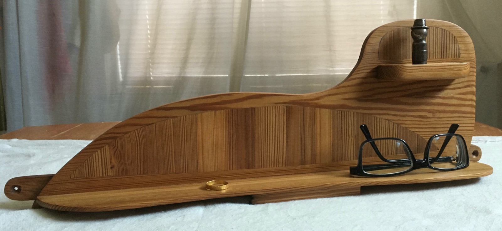

July 15, 20224 yr Author comment_294610 With a second coat of SealCoat then CARE-ful 0000 buff, I'm happy. D.O.N.E. "2022 07 14 Whimsical Shelf No. 2" Report

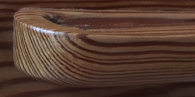

July 17, 20224 yr Author comment_294728 Thanks, Gene. This was the second oval-themed scrap-built wall shelf. Purpose-built from a sketch, inspired by the words of an almost-girlfriend (she has a daughter, so it would have been instant family had we three united ). But I noticed the wood choices were issue-plagued. The inlaid points sloppy. I left too much to chance. No. 3 Whimsical Shelf will use purpose-chosen pieces for the back. Beefy strips glued into one plank. The "balcony" ring dish inlet into the back instead of surface-glued. An opportunity to buy a new tool. A curved gouge to carve out the ring dish. The Goal: 1] Tight straight horizontal grain all the way up. 2] Tight curvy grain on the vertically-inlaid slats. 3] Expand on the ring dish detail. I like the way grain is revealed on the rounded edges of the dish. I've got the same blanks in "stock". Guess it means I'll be turning wood soon. More tools. Report
