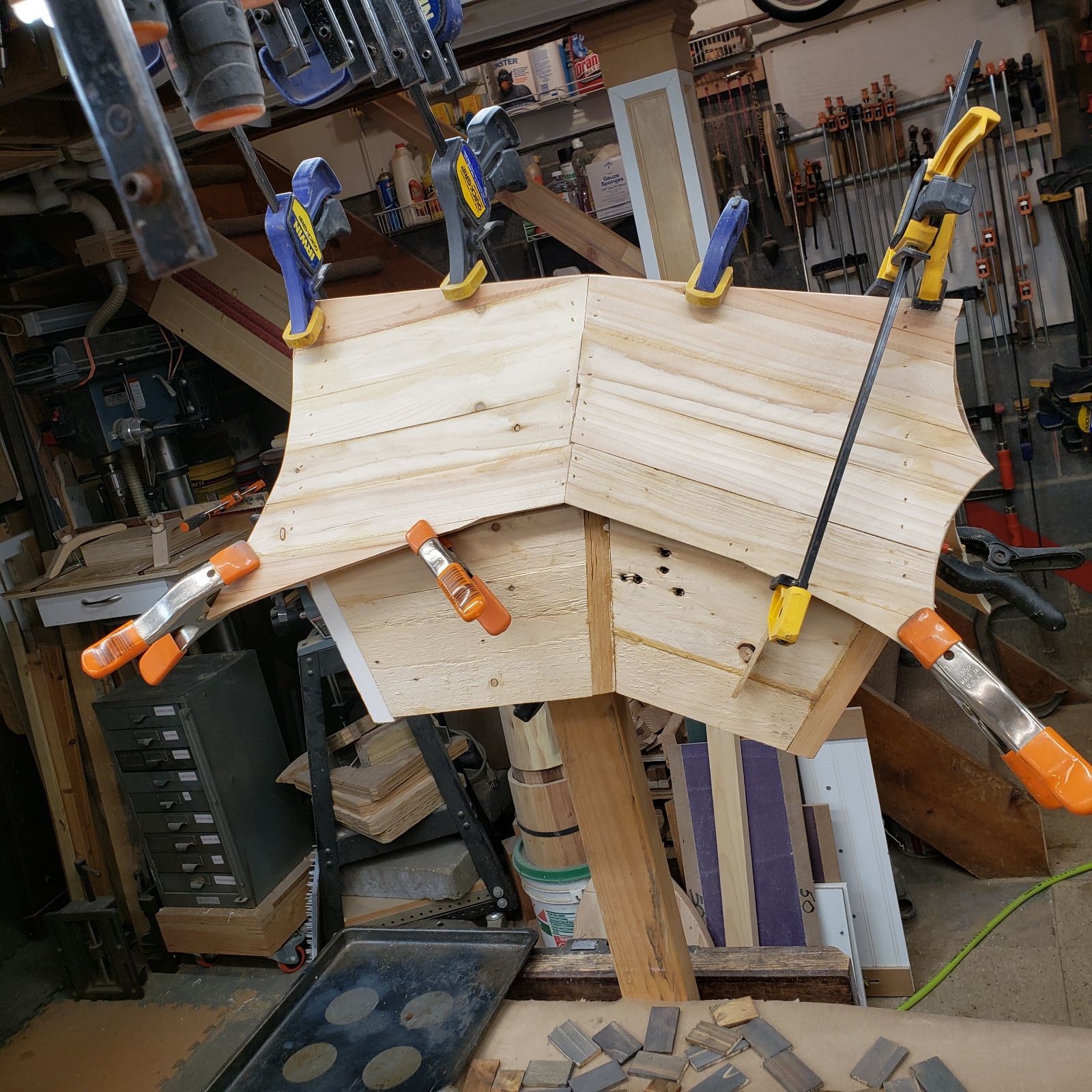

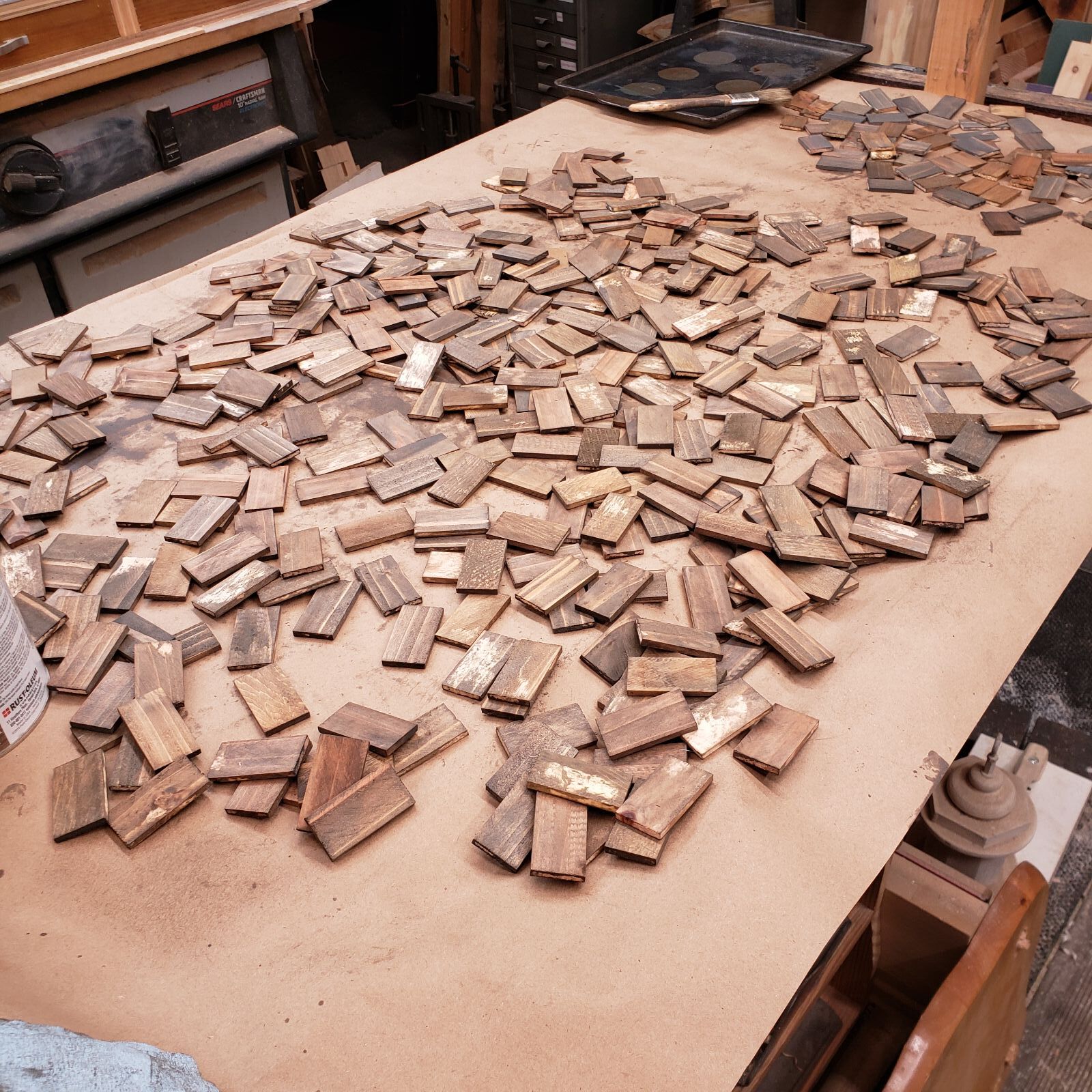

Well guys, managed to make hopefully all the shingles I'll need. Fit them stained now wiring for them to dry. This is the birdhouse they will go on. I know this isn't find woodworking but it keeps my mind active. 20220520_113801.jpg.84ca8d848422ef57e9c1a9bb1f892d05.jpg20220520_113818.jpg.2d66b00d94c9ca2b834025e07344d063.jpg
WOW, Pat that's a lot of shingles! Love the birdhouse design. Looking forward to seeing it completed.
Might fine woodwork from this angle.:TwoThumbsUp:
I'm liking it.  Looks good.
I don't know, Pat, looks like the rent on that place will need to be increased!
Lew, yes once the roof is water tight rent goes up.
I used my table saw for all the rip cuts,  bought a thin circular saw blade 7 1/4" 24 teeth, kerf is like 2.5 mm got to where I got 3 4mm rips out of each cut off. Then attacked 10 strips and made the length cuts on the miter saw.

Looks like you have it well in hand. Was about to send over my top shim guy, plane each of those into a 1.0mm- to- 4.0mm thickness shim. But my Planer's Elbow is still rebellious from the last job. And that was only one shim!
That's what I thought too. :cowboy: Reminds me of a dominos table but for 30 players. :TwoThumbsUp:
Wow Pat!  How many bird houses are you building?  Looks good from where I sit :)
